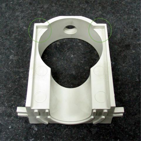

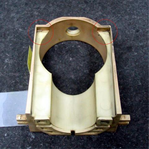

  2. I followed up on the info on the site that Derek linked to and found some more detail.
    From what I can glean there’s a design flaw in that series of carbs.
    https://store.moto-lab.com/articles/bst36-slide-guide-wear-indicators
    This is taken from the above link - this is what a new slide guide looks like:
    And below is a very worn one:

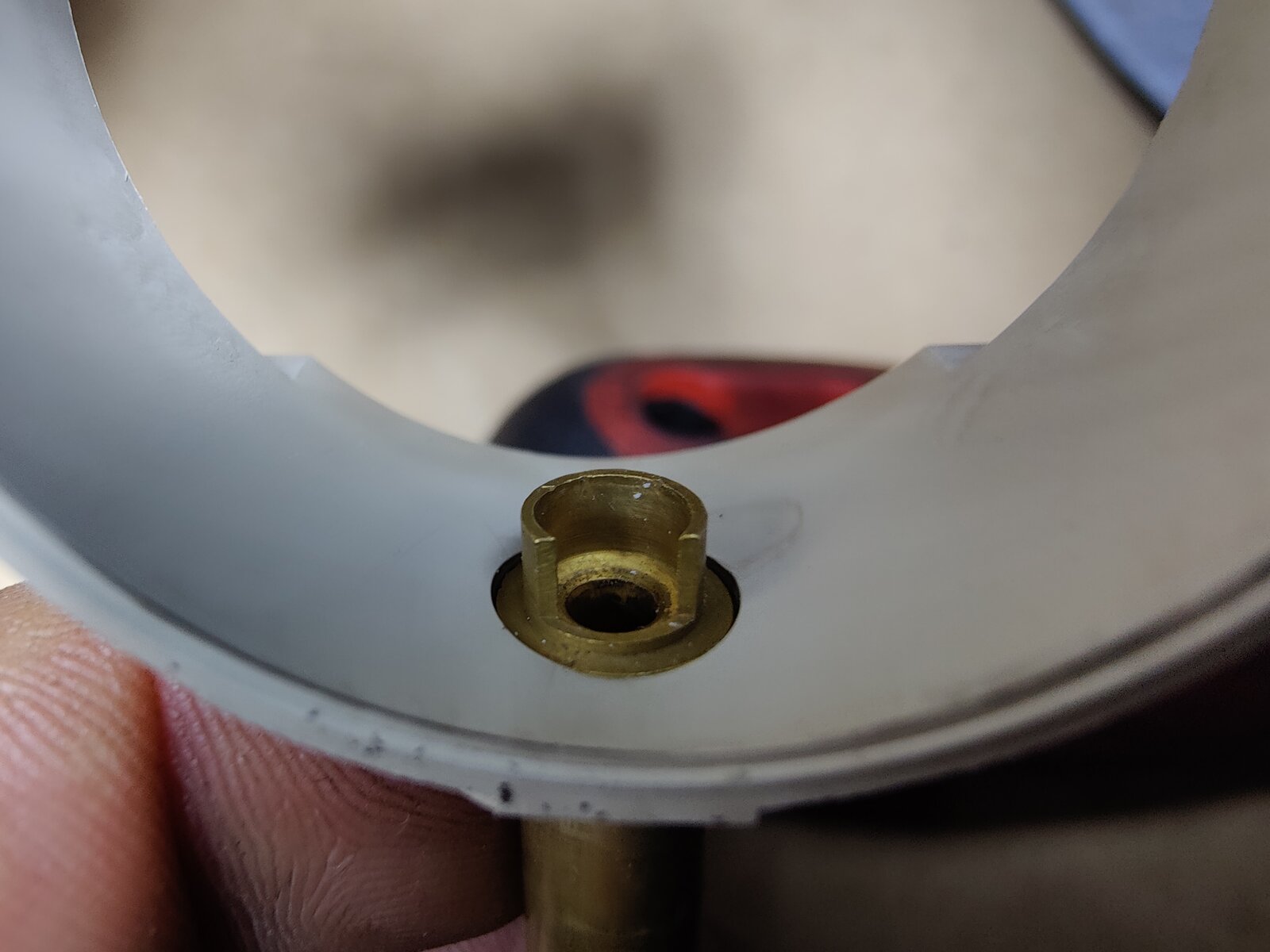

    The throttle slide itself is made of hard black plastic - harder plastic than the guide - so the guide wears out and starts to allow the emulsion tube/needle jet to wobble around - wearing it out prematurely.
    This occurs on other bikes with the same design of carb but I think the issue may be exacerbated by the vibey nature of the Ducati Twin.

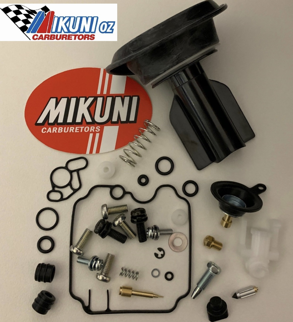

    The rebuild kit doesn’t actually include the slide guide or needle jet so it wouldn’t solve this issue. It does include the slide itself and I would check that for any wear grooves too.

    Although the emulsion tubes look ok eyeballing them so did the ones I took out of my bike but there was a very marked difference in how it ran when I replaced them. It seems to take very little wear to throw the mixture out.

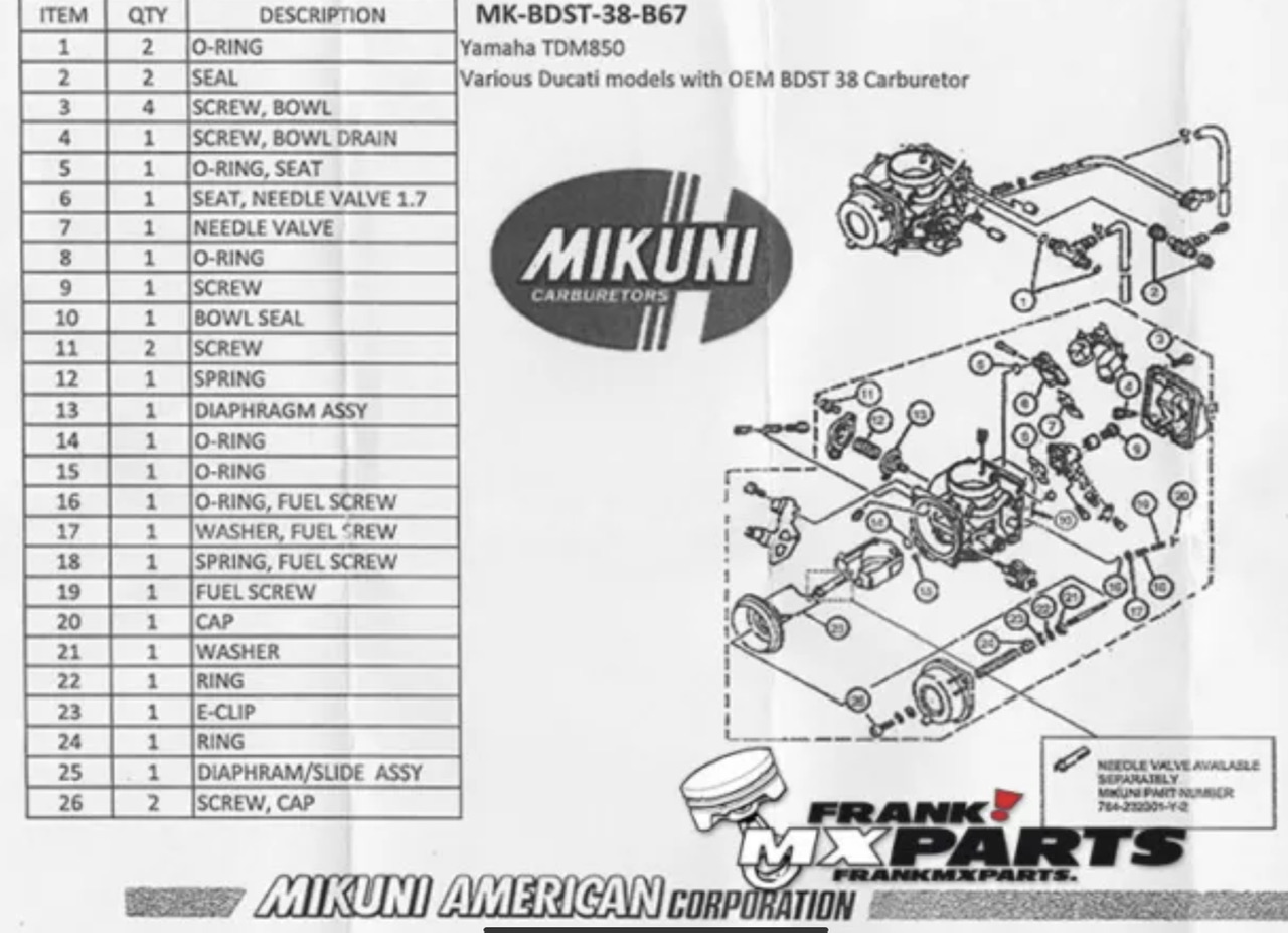

  10. Does anyone know the size of the o-rings for the main jets? May order up a bag of spares.
