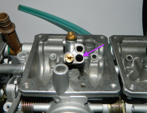

    Your's wouldn't have caps over them. This image is from a Suzuki. Try adjusting by ¼ turn increments and note any change. You may have adjust the idle speed to suit.
  9. Cool, thanks. I've been adjusting that but it doesn't seem to change much with this problem.
