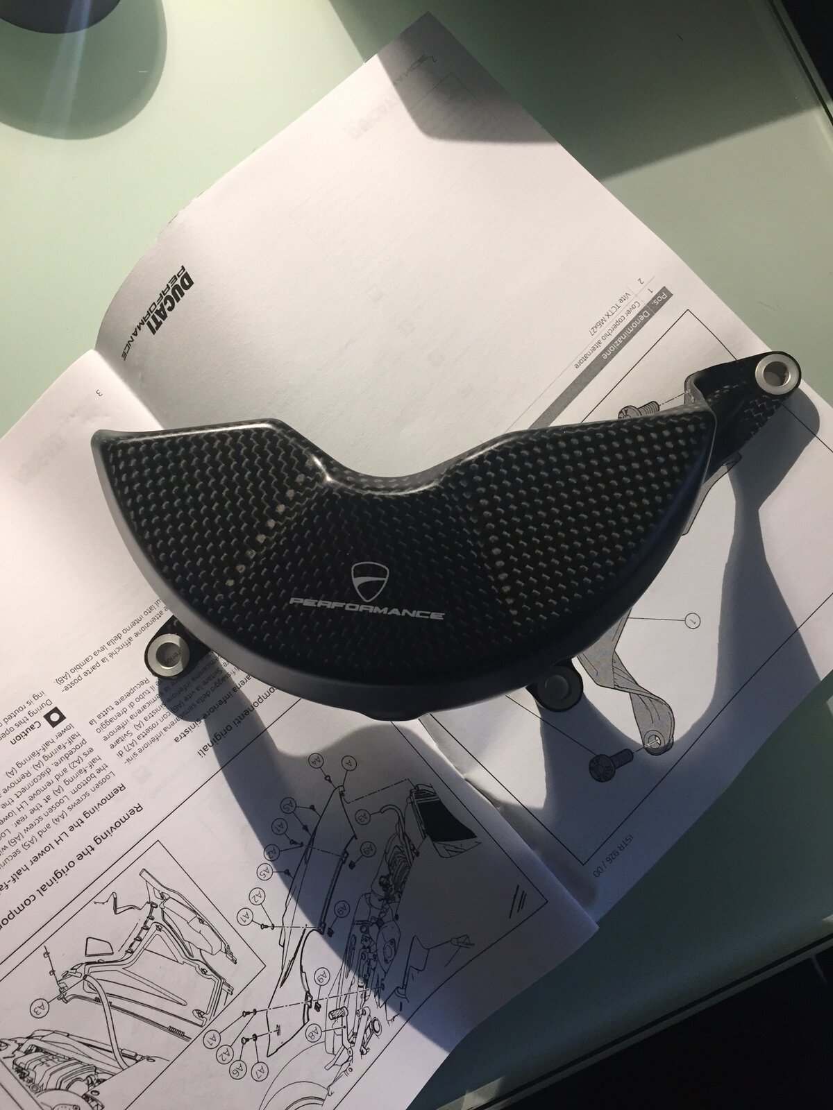

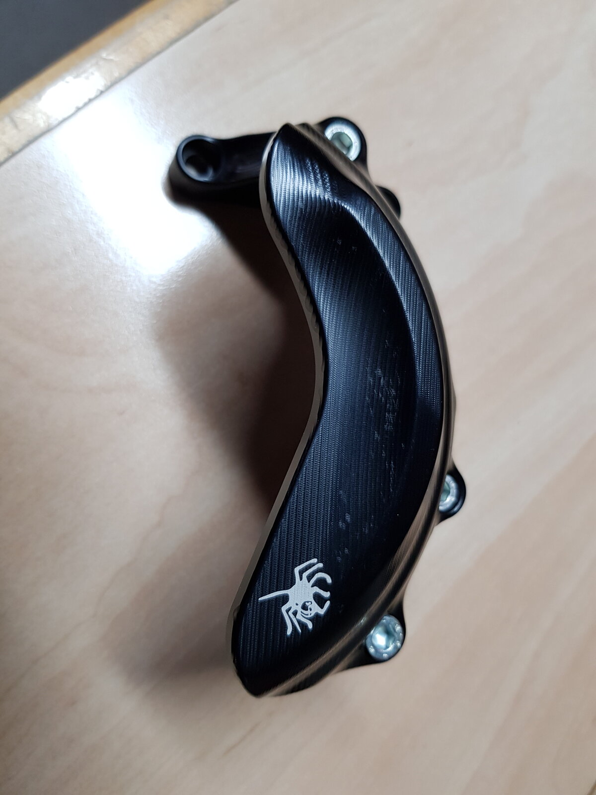

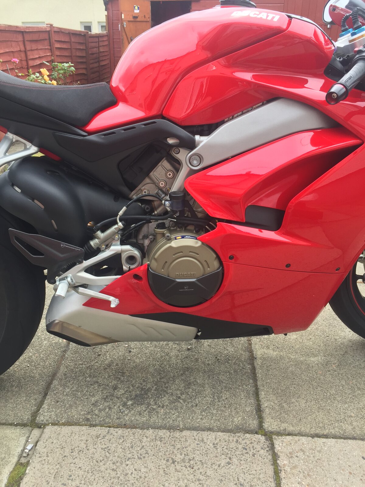

  2. Just ordered one of these, a combined case protector and clutch cover. Andy 20190403_151606.jpg

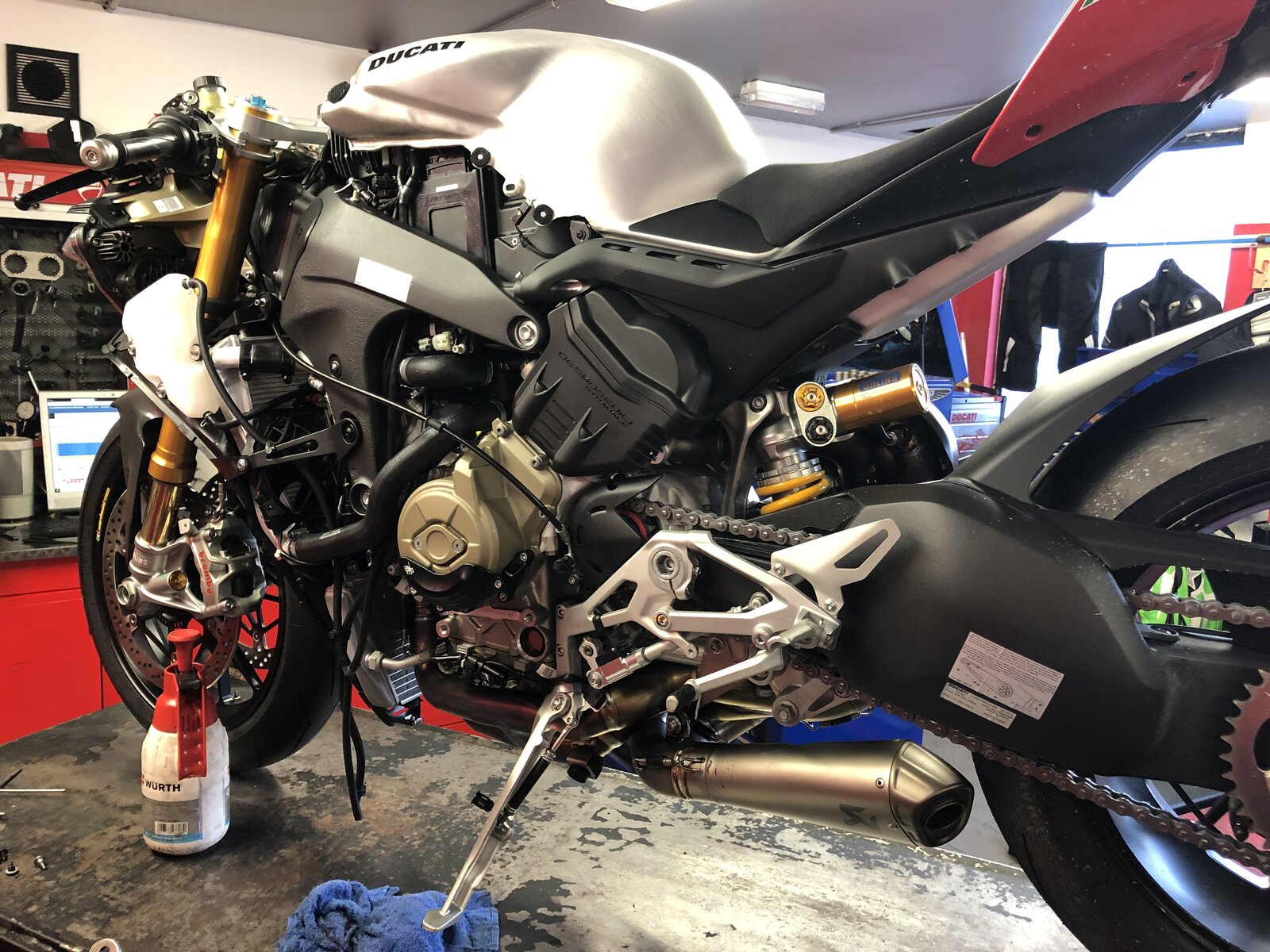

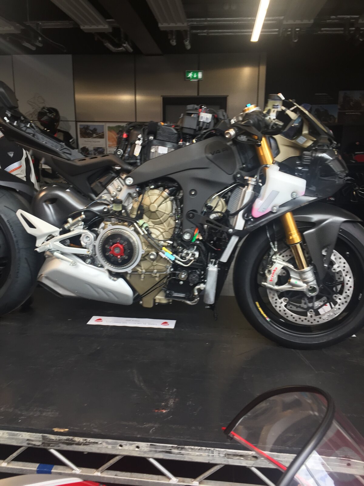

  3. IN DUCATI GLASGOW ON SATURDAY V4R

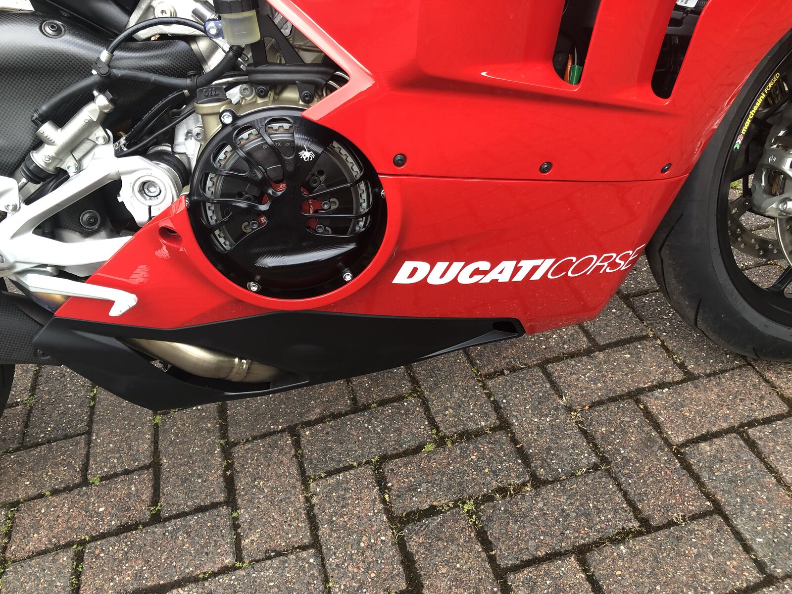

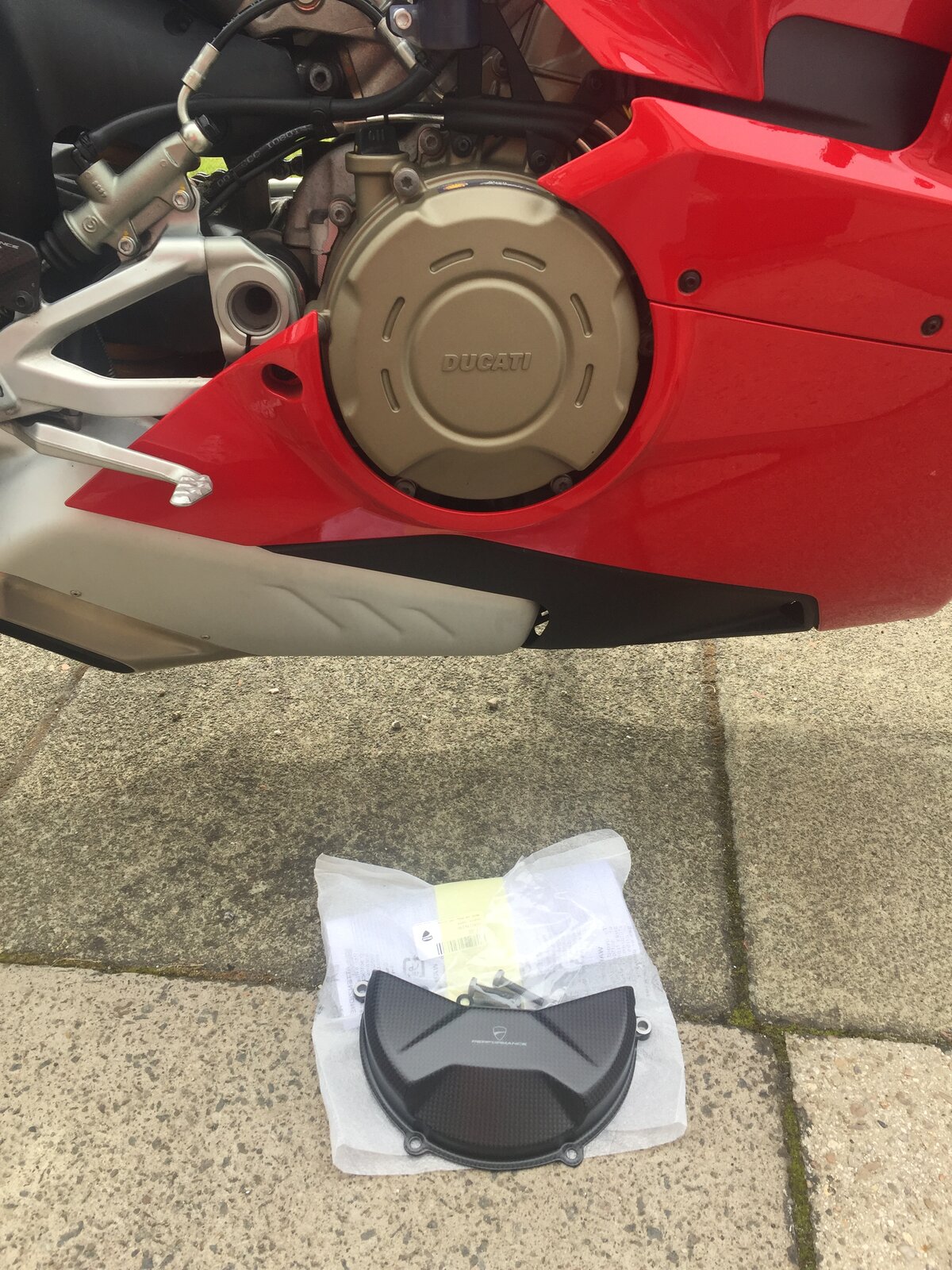

  5. There is no clutch cover supplied with the V4R dry clutch conversion kit so I ordered this. Nice quality and sturdy and if the Spider case protector works out, could be available :D.

  9. Sorry guys, my V4R case protector kit has arrived :D Andy

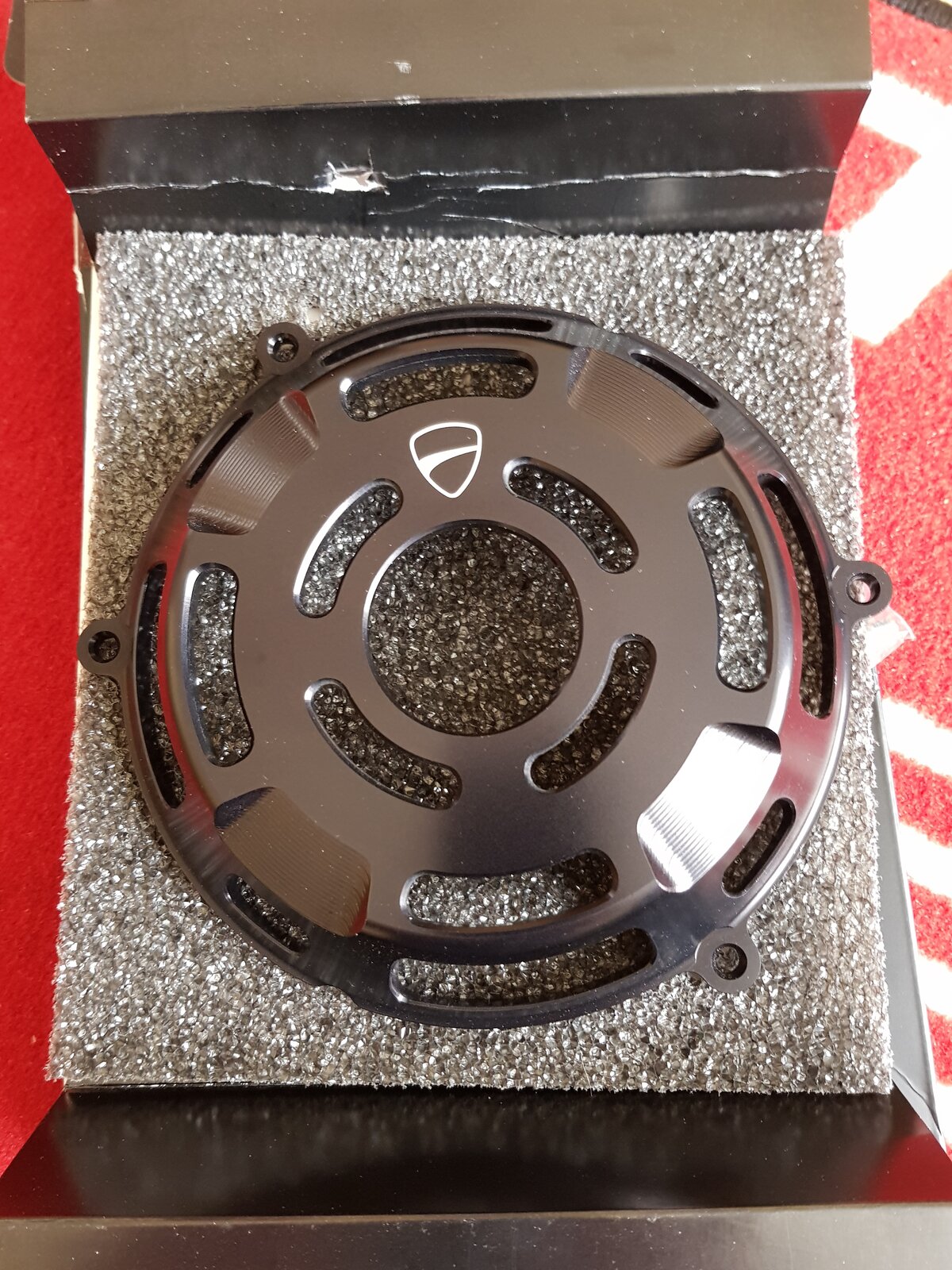

  10. Okay, my V4 dry clutch conversion kit has arrived or should I say most of the kit has arrived. Being one of the first people to order a kit back in February when it hit the catalogue, I’m now one of the first people to discover someone at Ducati forgot that the kit would need to include a V4R style clutch case. So V4/V4S owners with an engine number below ZDM1100W4#009397# be aware, you will need to order part number 243P0041BH as well. The part is not currently in stock but still hoping to have the conversion fitted for the Silverstone Ducati day at the end of July. Andy
    PS it turns out that the kit does include a clutch cover which is fully enclosed so you can’t see the bling STM workings.

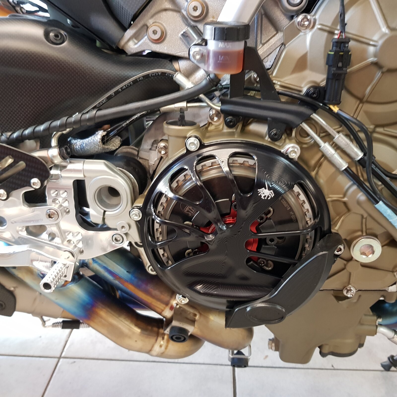

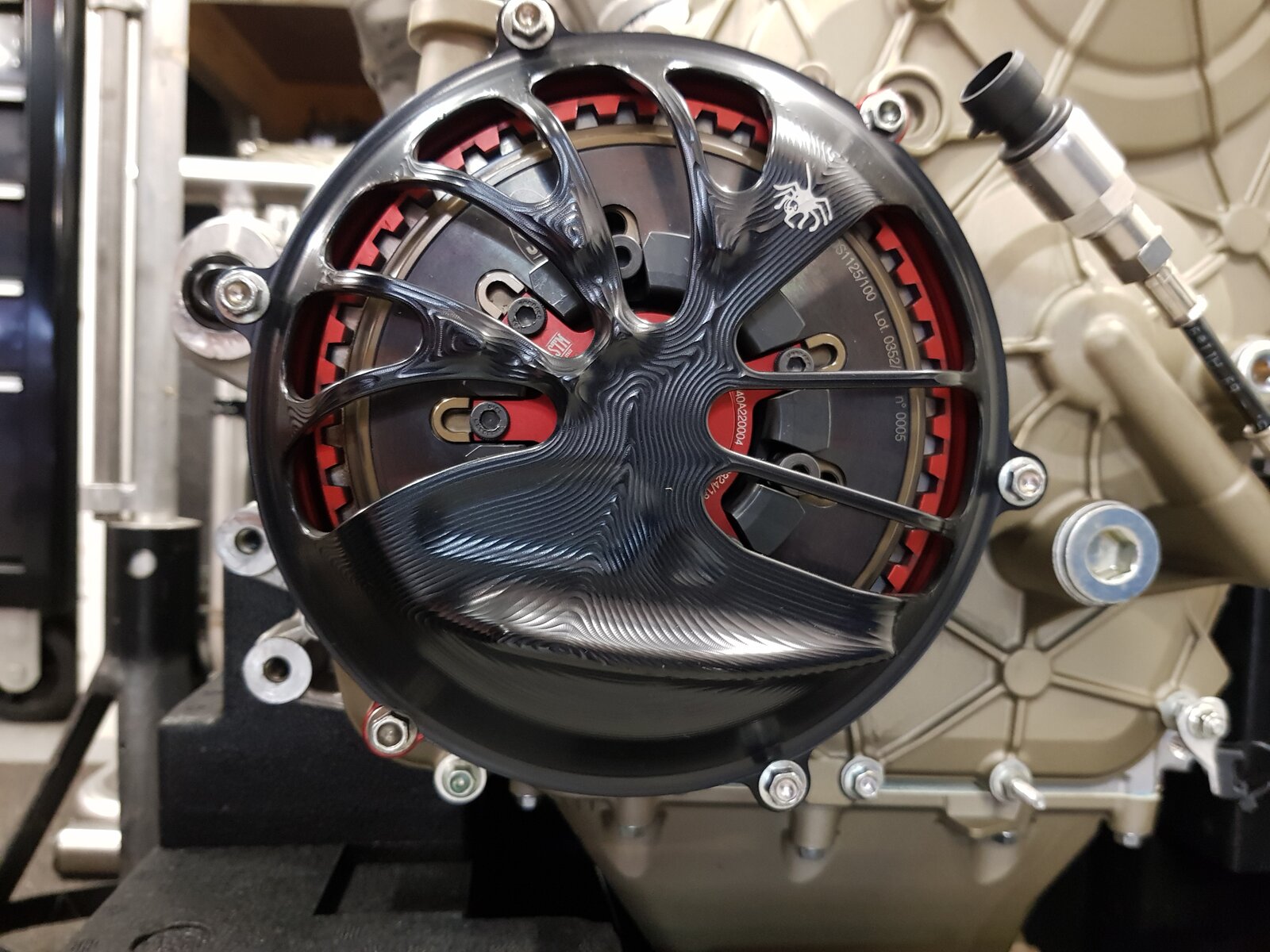

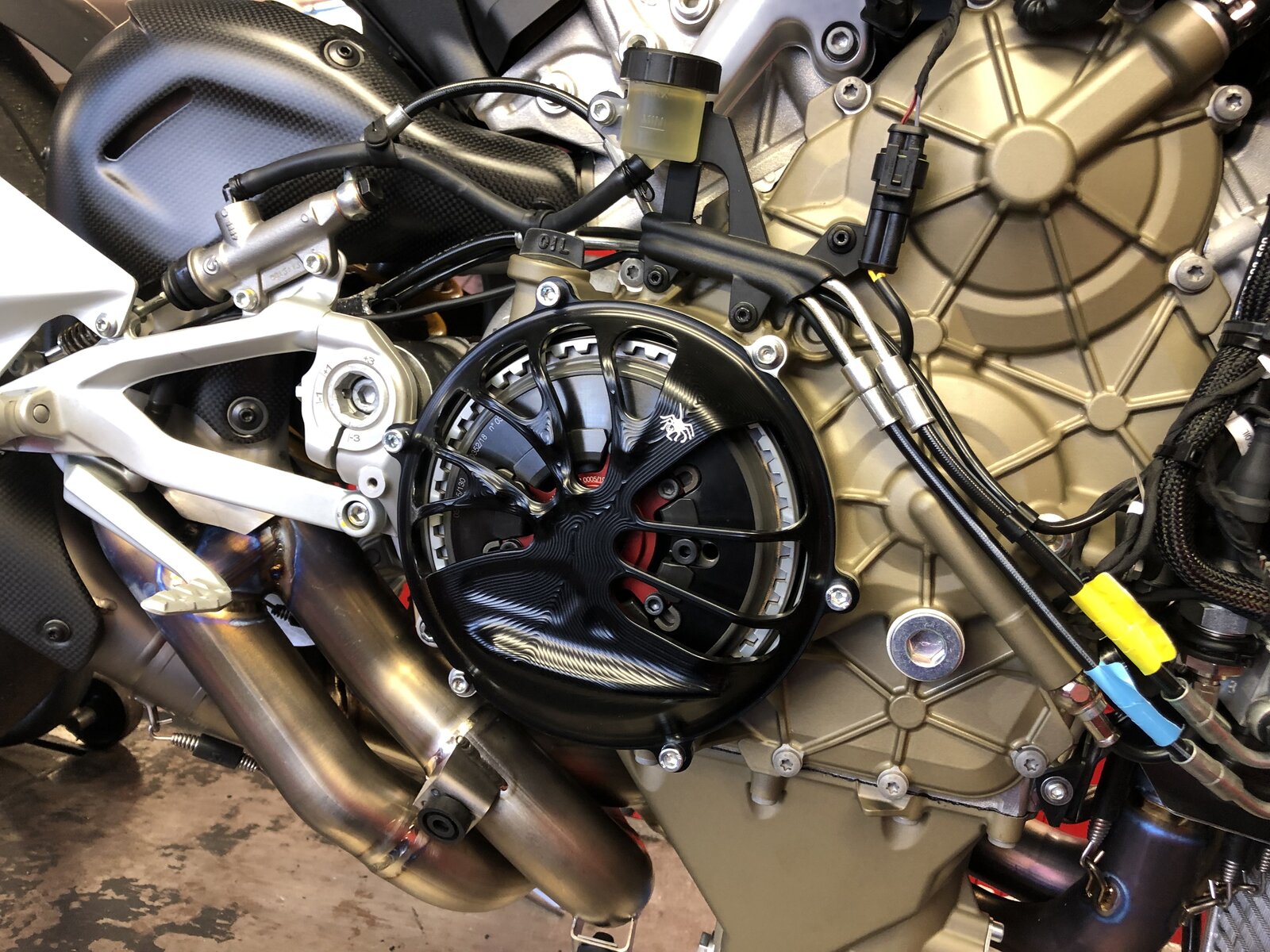

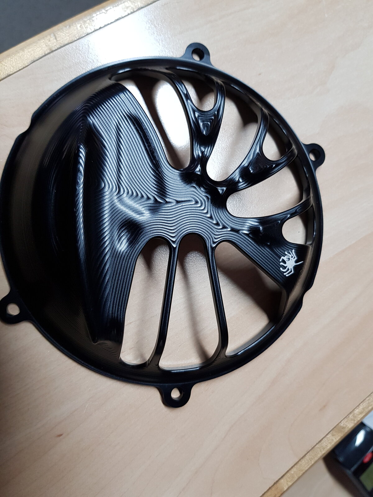

  14. Her are the Spyder Open Clutch & Generator kits sold by #motorapido. More expensive than the Ducati alternative but looks so much better.

  16. I now got the other side 3 months
  17. Coming together :D
  18. Wow!

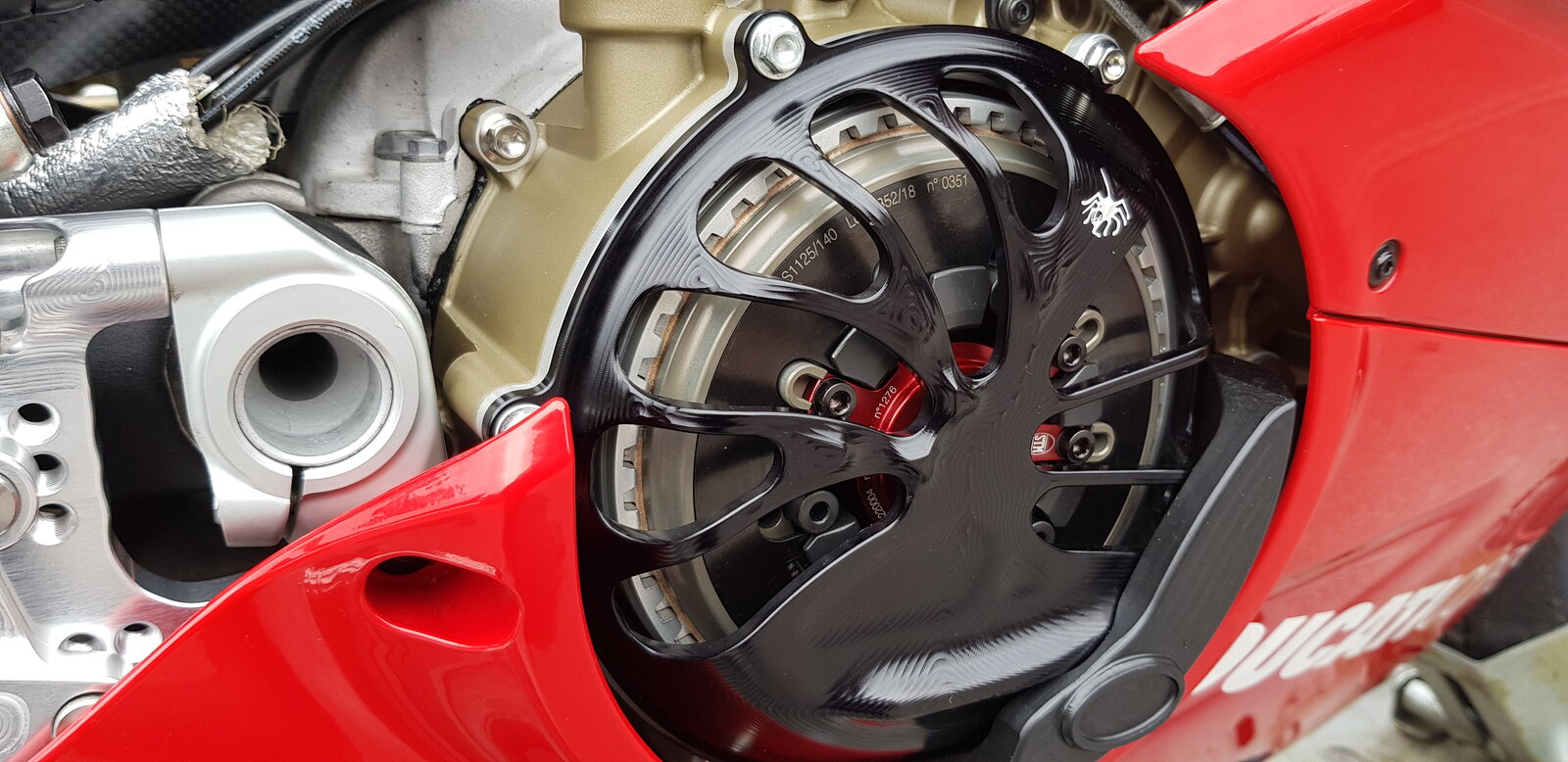

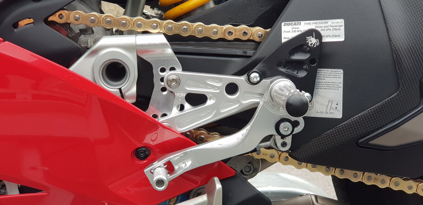

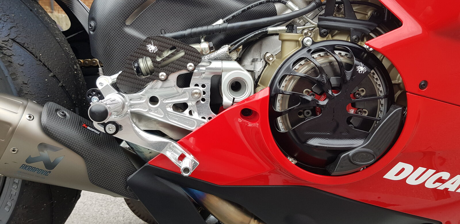

  19. Pick up this morning :D:D:D IMO, not biased at all of course, just the business. Must say thanks to the guys at Moto Rapido, the attention to detail has been fantastic. Andy
    • Dislike Dislike x 1
  20. Superb! Are they Spider rear sets? Or Rizoma?
