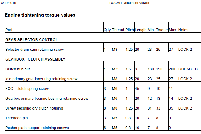

  1. Just fitting the clutch pack I bought from moto rapido thanks @Android853sp for the link!
    What is the torque value for the 30mm clutch hub nut?
  2. Unfortunately I have no idea. @Topolino however might. Andy
  3. 190nm!
    I've ordered the clutch hub holding tool so I can get it torqued properly.
    Also ordered a 70kg spring
