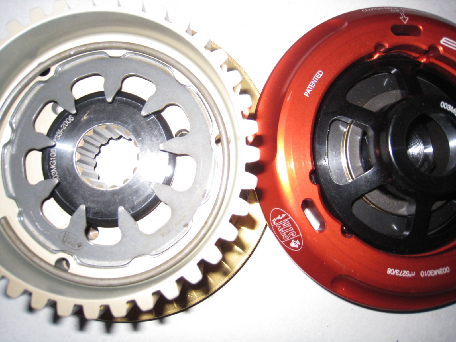

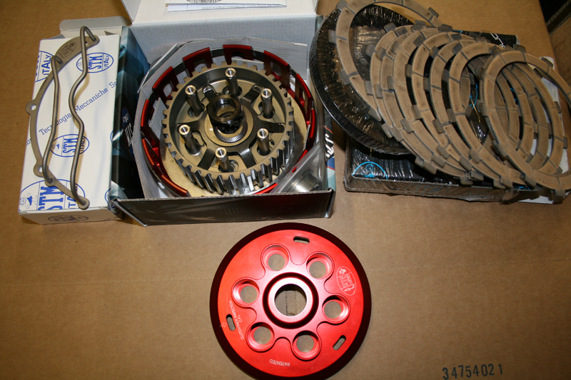

    Also id buy a spare spider spring if you have the old type STM fitted.Pic 1 new version.Pic 2 old type.
  11. Mines more like the second one.
    It felt fine the 3 times I rode it appart from grabbing a bit when hot. I was hoping a good clean out might sort it as its been stood quite a while.
    I'd like to learn to do it myself but maybe I'll let Geoff get it 100% so I have a good base/bench mark.
  12. The top one is the STM Evo' clutch.
    Very nice bit o' kit. Loads easier to dismantle, you can also fix the two drum halves together prior to disseminating. This prevents the sodding ball bearings dropping out!
  13. As Mr B has eluded to, it's all in the stack height AND the distance from the last plate to the top of the inner drum. Clearly one is relative to the other of course.
    Personally, and this is just my own experience, I've never worried about the dished plates, I may have some in there, I may not, I just get the stack in the the correct order, the height right and the last plate to drum distance correct and away ya go.... Slip sliding away....:upyeah:
    Fucking Ducati dry clutches belong more in the realm of Gandalf and Middle Earth rather than the realm of men!
  14. The old type is the one I have fitted.Ive tried newer design STM evoluzione and EVR diaphragm spring type slipper clutches and much prefer the older 6 spring type.All due to the feel of 6 spring compared to diaphragm.I also prefer the older 12t clutch plate and basket design as I found the 48t kit made a right racket after a few miles.
