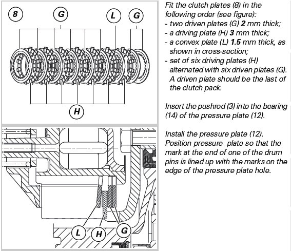

  10. Clutch plates are the same both sides. There is no orientation, turning it round won't make any difference. On the OEM clutch 2 plain plates go in first and there is often a convex plate. I usually juggle the position of the friction plates to distribute the wear. Here's picture of the clutch plate order for the OEM clutch -
