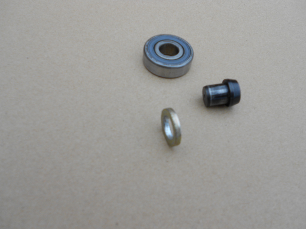

  12. The push rod should pull through, it has two O rings on it. It should pull out of the bearing in the preasure plate as well. The end that goes into the preasure plate has a top hat shaped bush that is also removable.
    Steve
  13. No 4 in that diagram is the bush that fits on the end of the push rod and into the preasure plate bearing.
    Steve

  15. The push rod has 2 x 0-rings they have to pass through the small oil seal at the end of the shaft, put some
    grease or oil on the push rod and work it in and out to lube the little oil seal and it should pull out ok.
    The push rod is stuck in the top hat/bush that fits into the clutch release bearing the small hole in the
    middle of it you can spray wd40 or oil in then use a small pin punch to tap the pushrod out.
    brian.
