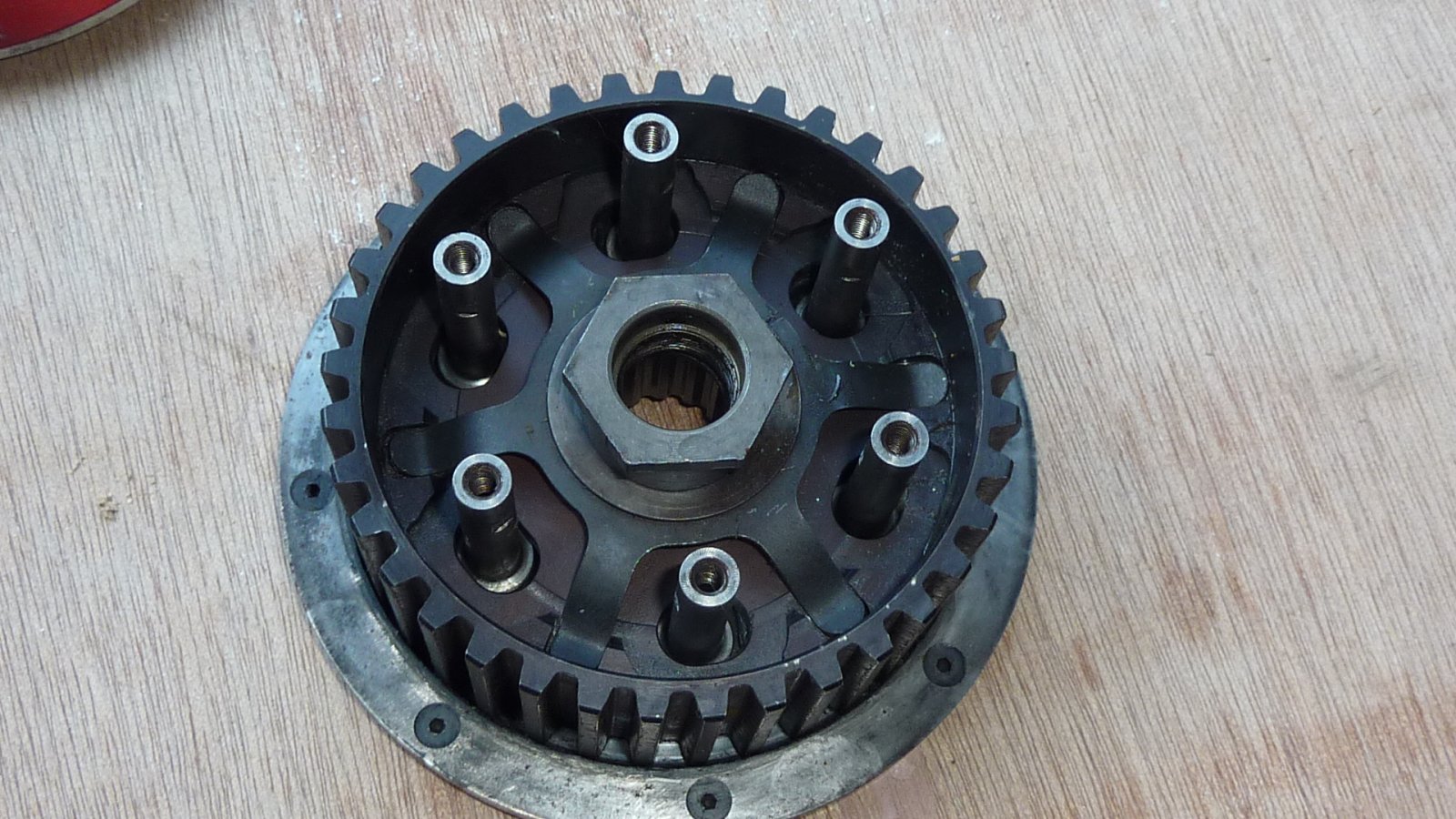

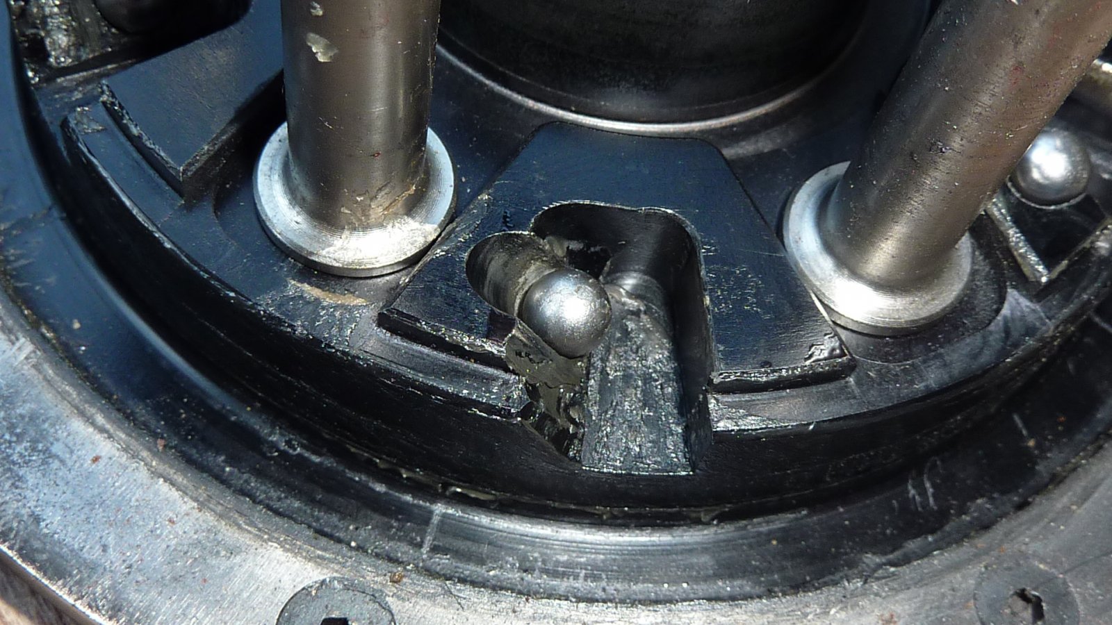

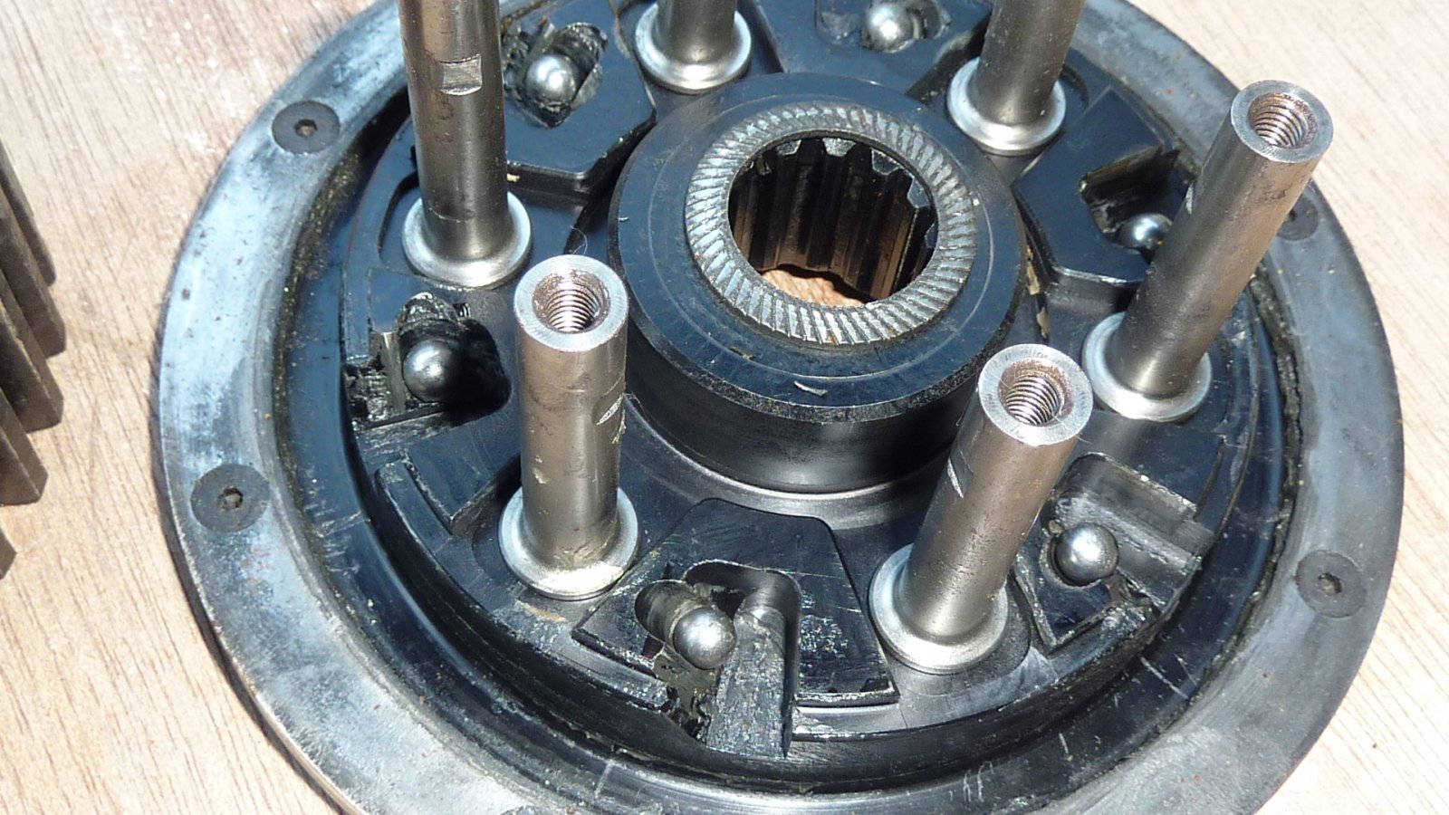

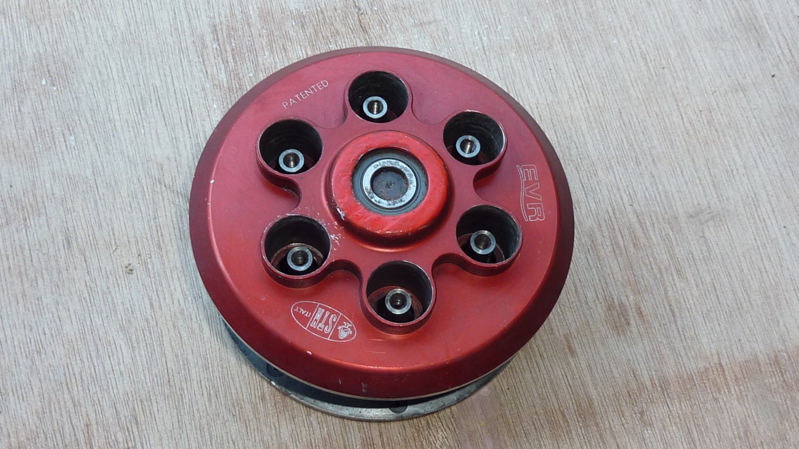

  11. I just happen to have one sat on my shelf so here's a brake down of what to look for.
    And a close up of the ball and ramp.
    Be careful not to lose any of the balls when removing the hub.
    Steve
