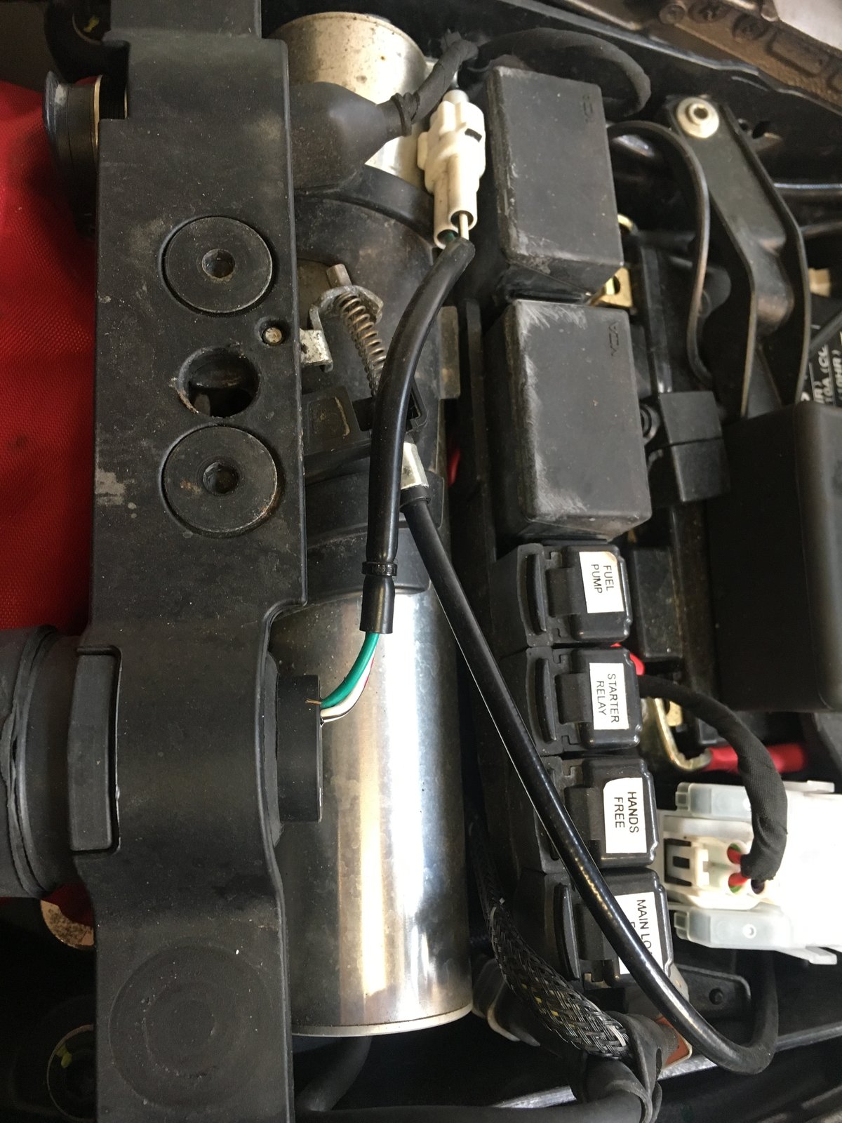

  14. The routing of that cable doesn't look right. Mine disappears down underneath the canister next to the frame.

    I've just checked mine and as al_b says above the routing doesn't look right. Standard seat on my bike.

  19. 419336BD-C63D-4512-B114-D0AA1625516E.jpeg Just went out and take picture of mine. All standard, nothing messed with, suspension etc never been out.
  20. Just re looked at yours and yes that big hose/wire over the top isn’t there. It’s like it’s been put on back to front. Have you had the shock out or any work on it?
