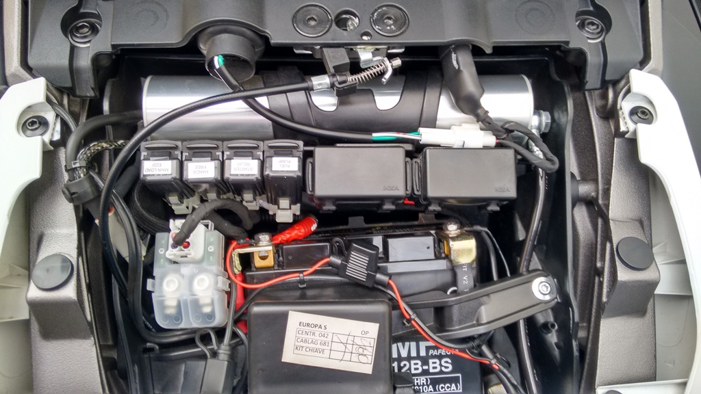

  3. My understanding is that the Touratwat seat (sorry Ducati Comfort Seat, made by Touatech) uses that same plastic base as the "non-comfort" seat supplied as standard. Even if it does use a different base, it's a Ducati accessory so there shouldn't be an issue with trapping cables (IMHO).
    Just had a look under the seat on my 2017 DVT and the cable in question is routed well out of the way to one side held in place with a standard rubber cable tidy. The non-standard small black tyrap above was installed by me to hold the battery tender cable out of way. By the way, I use a Comfort seat and have done for the last 2,000 odd miles.
