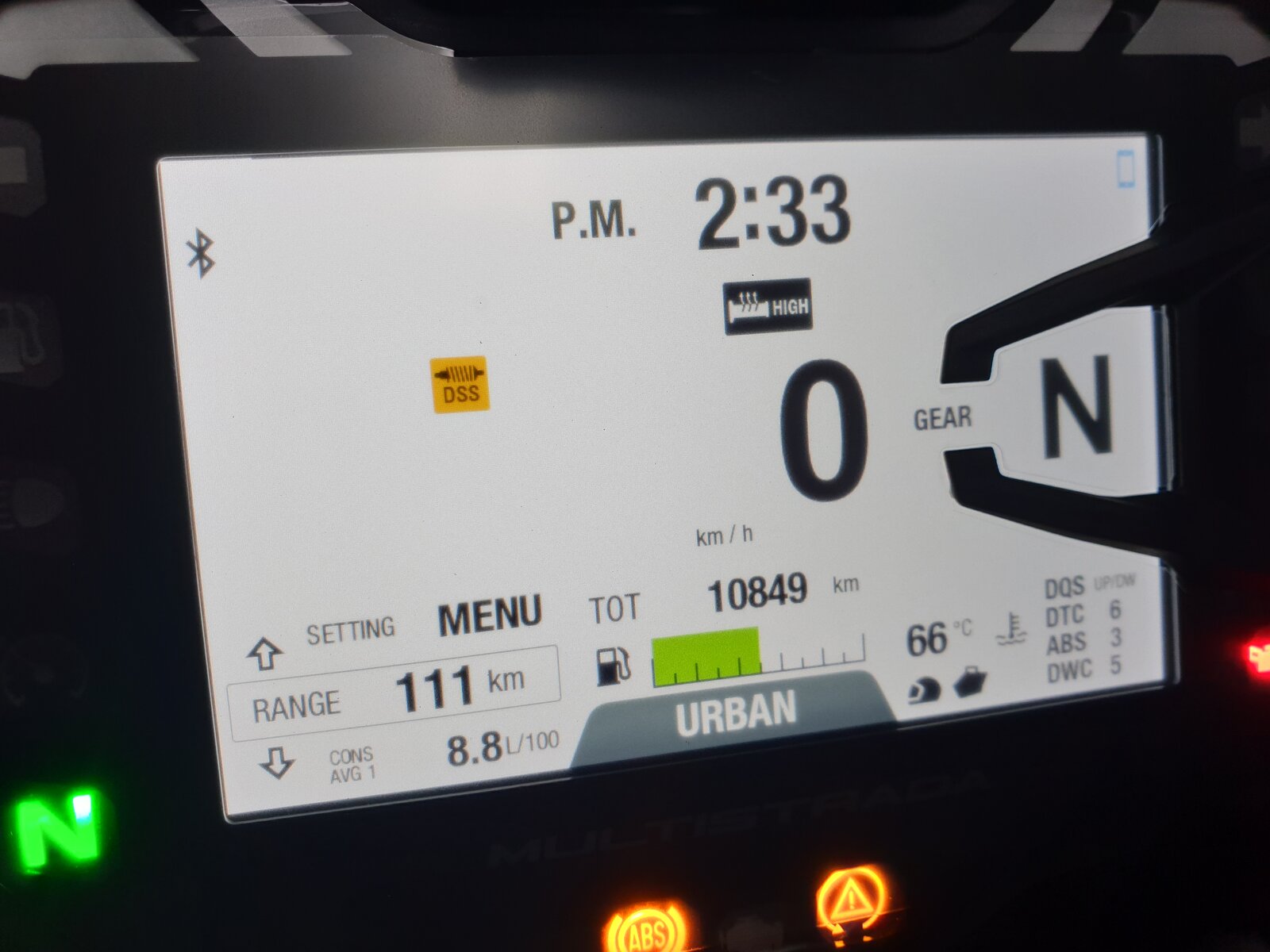

  8. Hello! I believe I did a big mistake. I belive I did accidentally plug the ESE into the DSS socket. And now I get an DSS error...
    What can I do to get things back in order and get rid of that error?!
    Thank you!
  9. Try disconnecting the battery. Leave a while and reconnect. Bike should recalibrate dss
  10. Hello! Thank you for the advice, but I tried this and the error is still there... I also took the bike out for a few kilometers with no success...
    It changes the riding modes; I hear the suspension working, but the error is still there.
  11.
  12. Try leaving it not connected to the battery for an extended time so computer can start from the beginning forcing a recalibration of the suspension. If not then dealer visit
