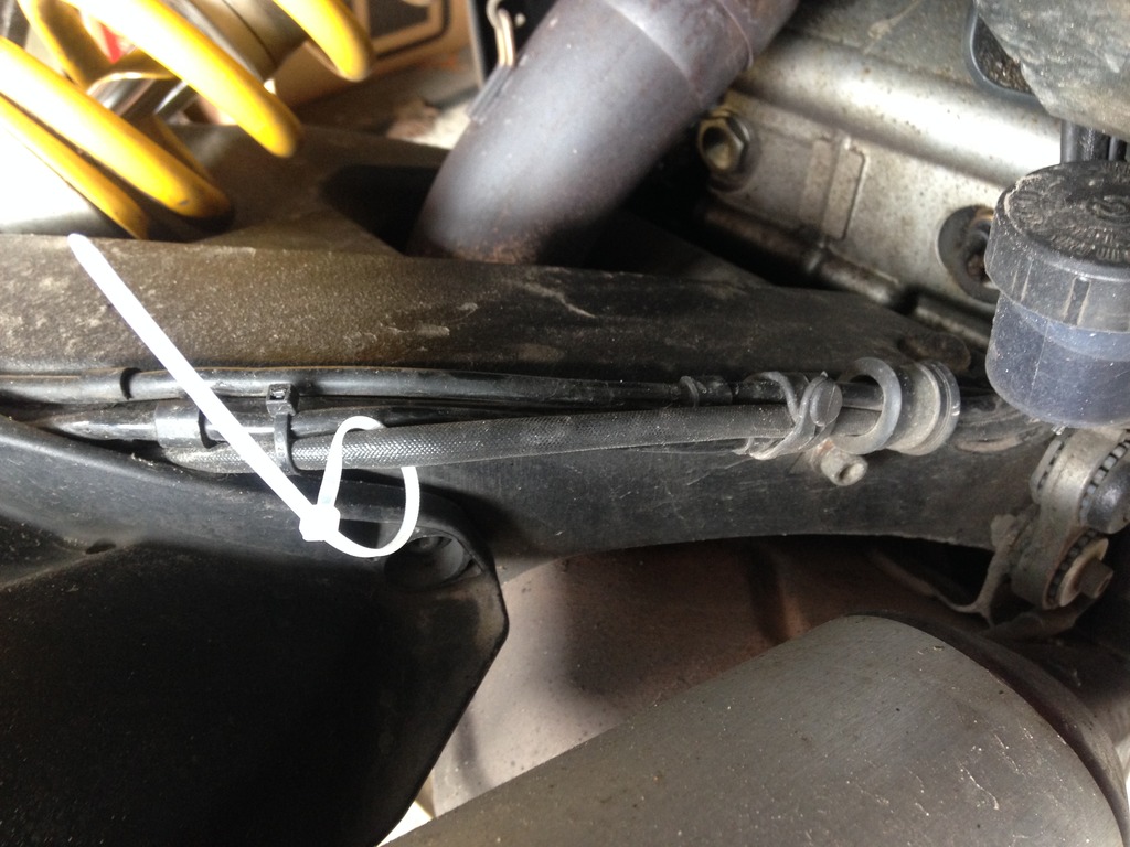

  1. The sensor is housed in this bit
    The replacement wire is the one I put the white cable tie on and you can see its a different coating on the outside than the rest of the wiring. I know the original wire wore through the coating as it was too tight and the new one is a little longer to prevent the rubbing
    Apologies for filthy bike but I commute on it daily and got soaked many times this week ...i'll clean it , I promise :)
  2. Thank you, I really appreciate you taking the time to post these, that's really helpful.
  3. Looked at mine this morning, and couldn't spot a cable with the different coating, so fingers crossed...
    I'll dig a bit deeper tonight, in case it's buried.
  4. Actually, looking closely, it looks like it's just visible where it disappears under the hugger, damn! Will have to check again tonight.
  5. The different coating is the new replacement wire....probably why you cant see it on yours ;)

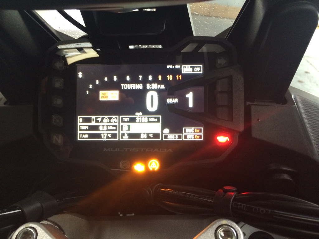

  11. And another DSS error on the dash. Out of warranty this time and diagnostic says its a front wheel accelerometer ....109 quid for the part then add how long it takes to fit ....ouch :astonished:

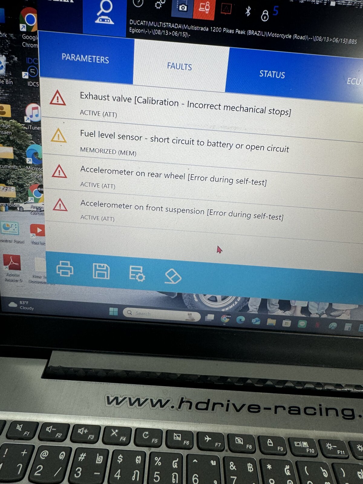

  16. I get dss error on my screen sometimes. what do I need to do to fix DIY.. the mechanic said I need to front suspension sensors.... anybody know where I can get them. 2014 met pikes peak located in Thailand.
  17. These sensors are linked via Cambus system I found this when , after getting intermittent faults on gear selection indication and dss, I then lost my fuel gauge . Tried the resistor in the cable to fool the bike into thinking it was half full but it made no difference! Plugged in fuel sensor and then started unplugging front sensors until the gauge started reading again . Found front accelerometer was u/s . They used to be expensive but only £24 now only difficulty is the connections are under the fuel tank left hand side and when rerouting cables on front mudguard take wheel off .
