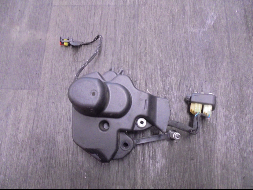

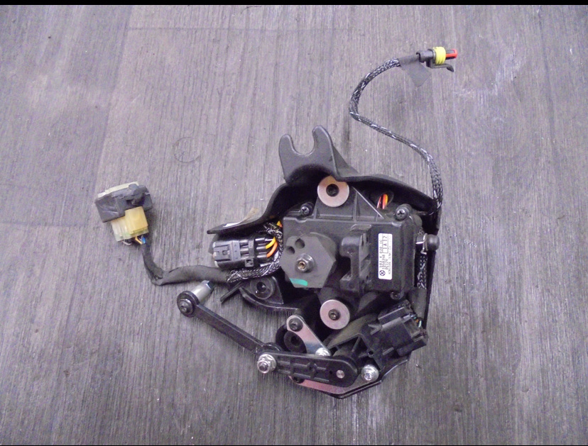

  1. That’s what I suspected :(. I guess that in the factory it was fixed to the inside of the frame and then the bike built around it.
    I’m hoping above hope your comment above(post #16) holds true and once one or both of the front accelerometers are replaced the system corrects itself.
    Sadly though, the pragmatic side of me says that won’t be the case :(. As someone has been at the exhaust servo in the past I suspect the fault may lie inside the unit.
  2. Thanks.
    For anyone else reading this now or in the future, this is what the unit looks like. The hexagonal cam is where the exhaust valve cable attaches to, the servo motor is underneath it. The rear suspension rotary sensor is the unit underneath that with the plastic arms attached.

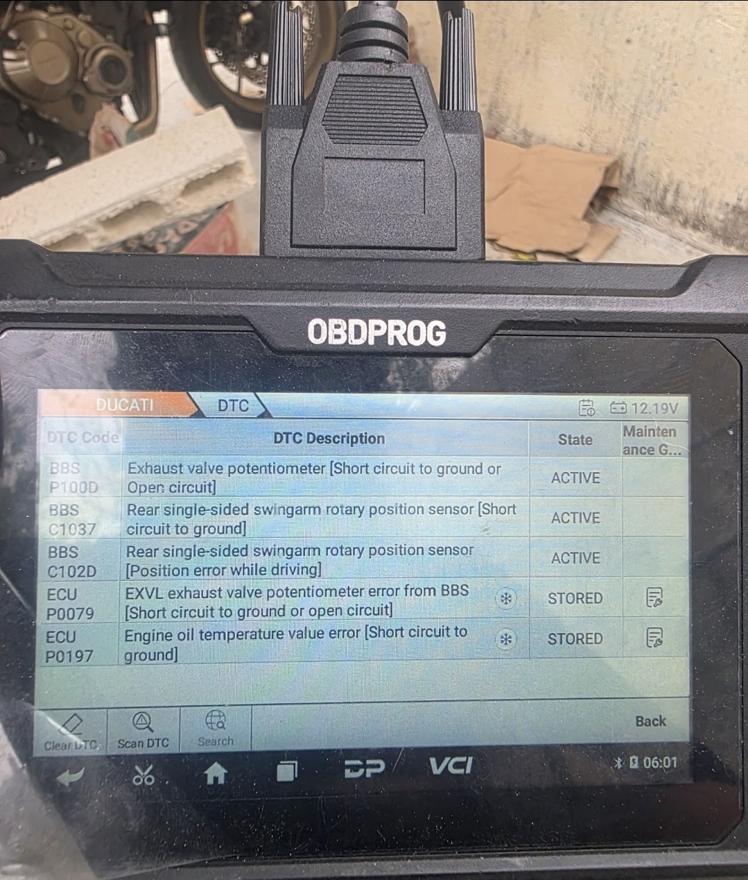

  6. The last few months I've been having a few issues coming and going intermittently. Neutral switch , dss lights and then my fuel gauge went. I thought I'd try the resistor trick but when that didn't work I thought ohoh! Using the obdstar found multiple alarms ,so started googling and came up with this thread , thanks Paul. Stripped bike down and started unplugging sensors and when I unplugged the accelerometer one on the fork leg the fuel gauge started working. I was watching this as I guessed they were all linked through the canbus? Most alarms cleared ordering new sensor tomorrow I'm glad the gauge had stopped working as this was my circuit tester ...
  7. Just reread the thread and as Nelly said mine also went into preload calibration. That rotary rear sensor kept coming up as an issue before the accelerometer was unplugged too. Bugger getting at front connections as fuel tank off job.
