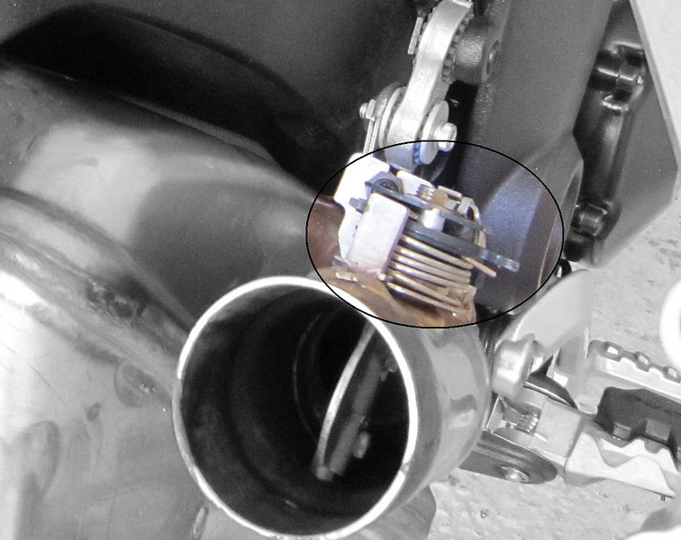

  4. Gee's, @Rainman. Dude, stop quoting stuff that just is not true. May I suggest you take the end can off and look at your exhaust valve with engine running. It's open at idle, pulls in during the mid rev ranges, and opens again at the higher rev ranges.

  5. The mechanic at P&H told me once you add the DUC-ee it just stops the valve closing, no need to remove the cable or any other changes.

  7. Mate, what are you on? Lol. What's in those videos is exactly as I described so I'm not sure what you're interpreting from those videos. There is another element that you're missing which I've discovered... it's not completely related to revs as the valve position is also dictated by throttle position. Take the cover off and go look for yourself. It's closed at idle. The sound alone tells you this and it's about as obvious as a kick in the balls. I'm riding around with the cover off because I've been pissing about with it so much lately so I'm watching it first hand.
    The reason that 2nd vid looks like it's changing at a point in the rev range low down is because the person operating the throttle is trying to hold it at 3000 RPM in neutral at a standstill, but when you're stationary and the engine isn't under load it's actually pretty hard to do and you're right on the hysteresis of the throttle being slightly open or shut. Therefore, when you try and hold at that low revs when not moving it jitters and moves around all over the place, because you're making the throttle position change. In the more basic terms, when you're riding that valve is as good as open and when you're stationary, it's closed - simples. Just your ears tell you this.

  8. It stops the valve from closing because to plug it in you have to disconnect the servo, but that's not the actual purpose of the DUC-EE however it is the net result. The only thing the DUC-EE actively does is clear the EML by sending the code to the ECU that the servo would otherwise have done. It's the absence of the servo that causes the EML to come on.
    The reason that Vizitech tell you to remove the cable is because it becomes superfluous and if there is some corrosion in the cable and it becomes stiff then that too could stop the valve from being closed by the spring. Having the DUC-EE installed also allows you to remove the cable, servo, etc and save some weight.
  9. I have looked loads, and the valve is fully open at idle. Unless the 1260 is different ? it pulls in during mid range to lessen the sound at town ride type revs, and re opens at high revs. That is exactly how the dvt and the ts bikes valves operate.
  10. Mate, go and watch the video again, but while doing so don't just listen to the engine revs, think about what the throttle position is likely to be. The valve closes the moment the throttle is shut, regardless of the revs. You can see the throttle completely shutting whilst the revs are reducing, well before it reaches idles ... because the throttle position is closed.

  13. The valve default is open at idle and in the video it pulls in as he revs it. I have drilled three out on 3 Multi's, and in all, during idle the valve is fully open. I can't be bothered to even debate any more cause as usual, your opinion is all that counts, one of the few folk who seem to confuse their own opinion with fact. Maybe the 1260 is different but the default on all the 1200s I've had is open at idle.
  14. You Sir are correct, default at idle is open as here...... :upyeah:
