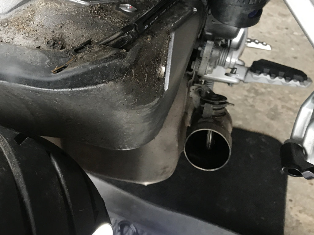

  2. You need to whip the end can off, not a great picture I am afraid...
  3. That’s great
    Thanks Grahamg
    Now I see what I need to get at

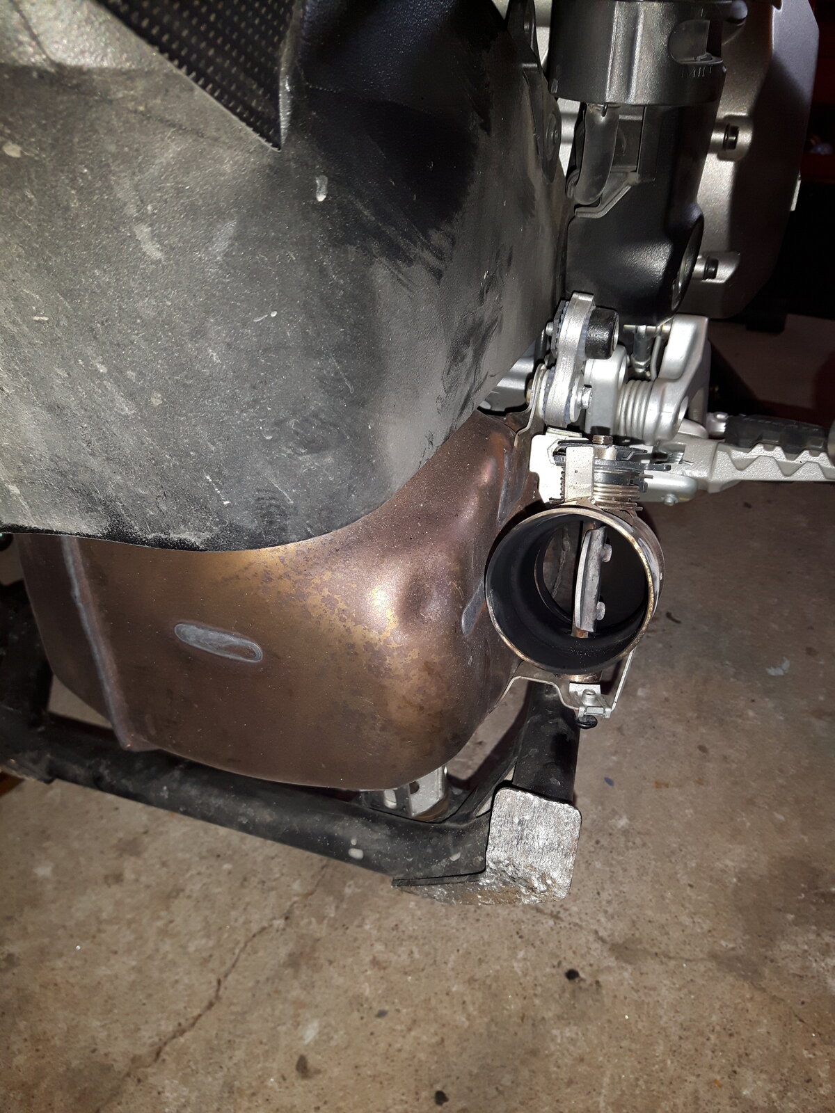

  4. While I had the rear wheel removed to get the tire replaced, I took the opportunity to toy with the engine sound while the exhaust is off the bike. Spoiler: No noticeable increase in volume without the end can. However, the tone may be somewhat different.
    I also toyed with the RPM's and Throttle Position.
    Observations: The valve is open at idle, closes at 3500 RPM and re-opens at around 6000 RPM and above.
    As you decrease the throttle, the exhaust valve re-closes as it passes though the 3.5k~6k zone and re-opens below 3.5k.
    I also tested if the TP had any effect on the exhaust valve while with electrical power but engine off. Nothing. While something inside the engine was moving (most likely throttle valves), the exhaust valve did not. While this is not conclusive evidence, the valve is most likely RPM related and not TP related.

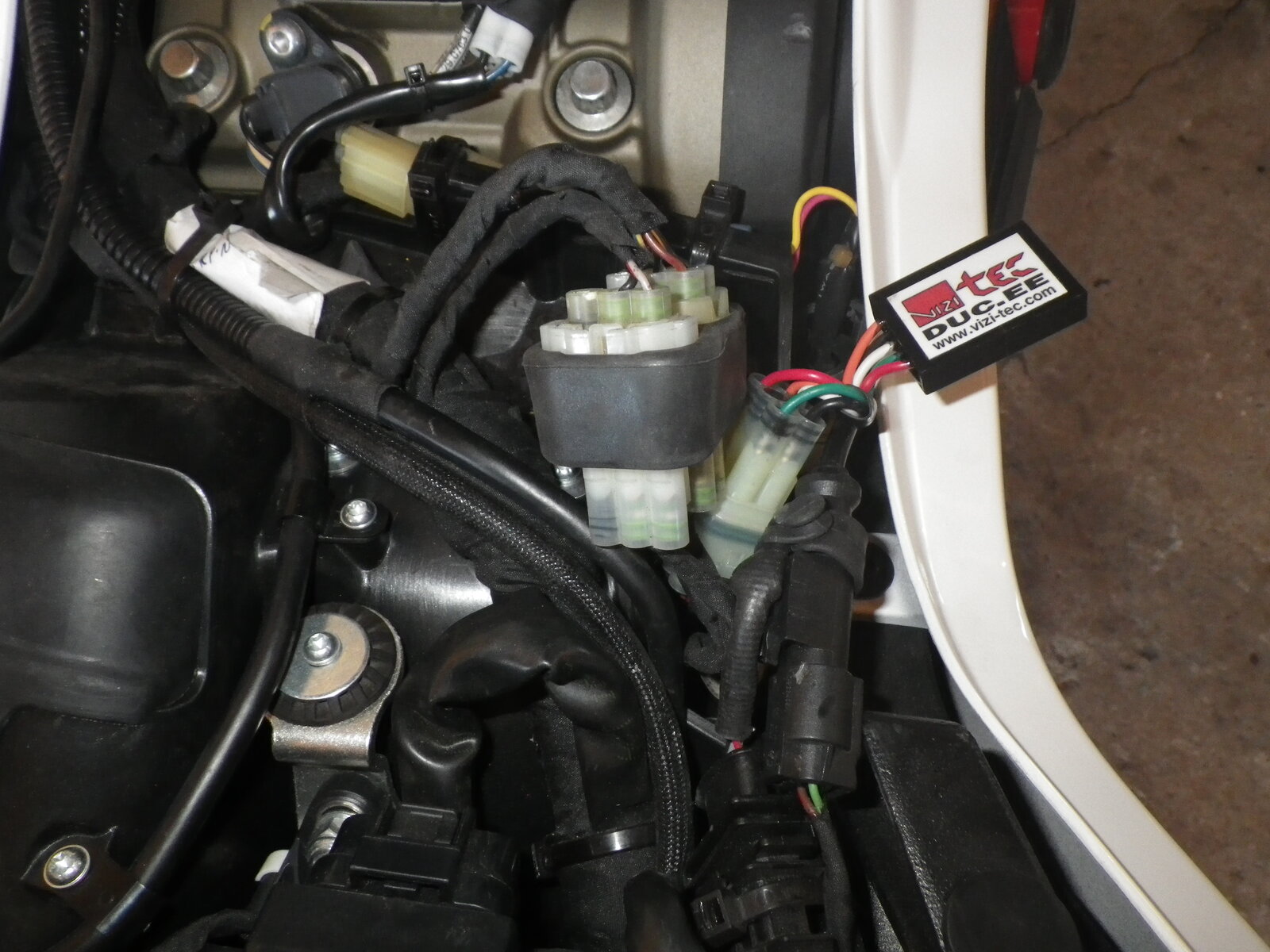

  7. Rainman,
    would it be possible for you to take a photo of the DUC-EE plugged in (or, since I read above that you have removed the DUC-EE, perhaps you took a photo before you removed it?) so that it is clear which plug under the seat of a Multi 1260 that it gets plugged into?
    i would appreciate it greatly.
  8. I'll take a few pics tomorrow.

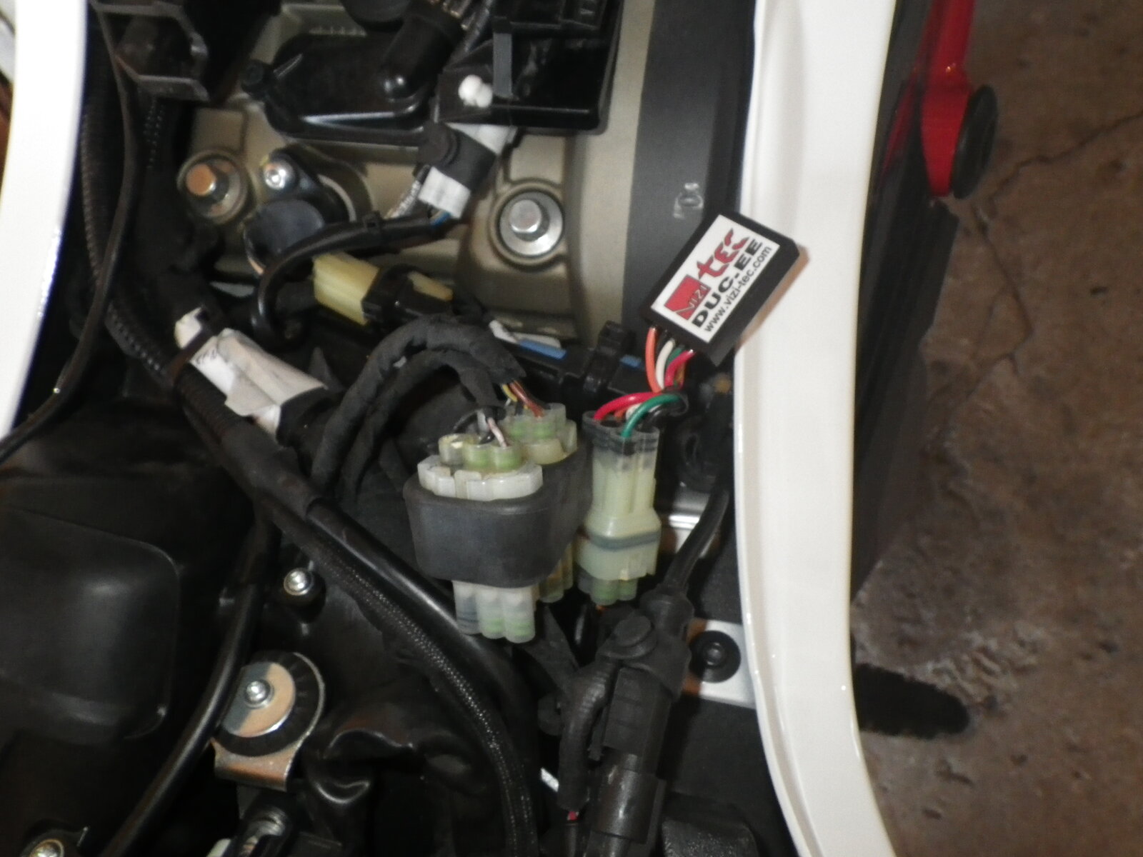

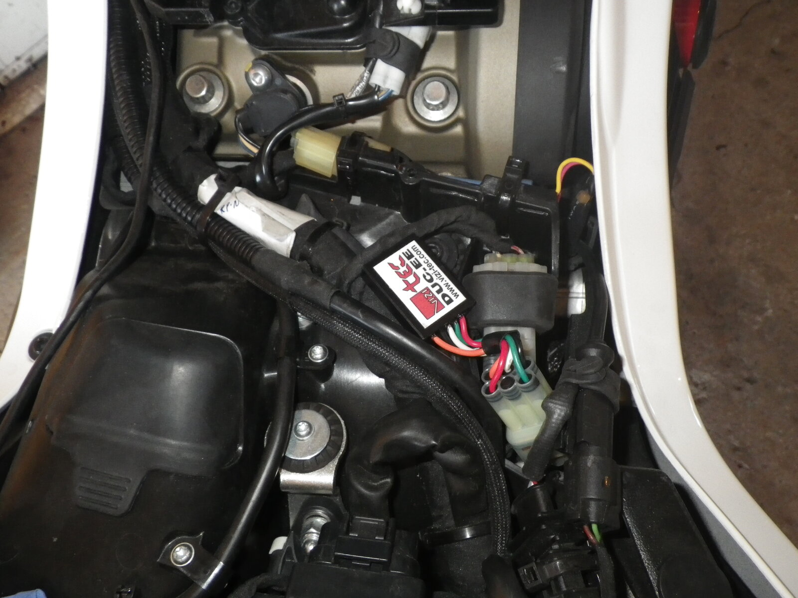

  14. Because of overwhelming demand, please find attached a few photos of the Ducc-EE installed.
    As previously mentioned, the plug is located under the two white plug cluster wrapped in a rubber holster on the throttle side of the bike. Simply pull these two upwards and the servo plug will be visible underneath. Once you un-plug the servo connector, there's enough slack to pull it upwards as shown to facilitate pluggin the Ducc-EE.
    Of course, I needed visual confirmation to check if this dongle works. Consequently, I removed the heel guard exposing the exhaust valve, rev'd-it-up and see if the Duc-ee did prevent it from closing. Valve did not move and no CE light. There you have it.
