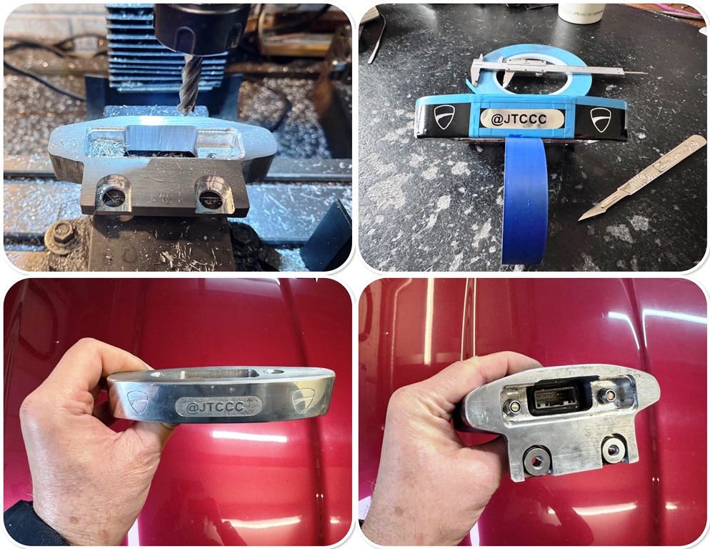

    I was so impressed with the speed/tacho I fitted to the Buell, I decided to fit one to this bike! A bit easier than the Buell housing as there were no complicated angles, bit it still took a while to machine. I managed to incorporate some grommets so its nicely rubber mounted as well.
    I don’t know what the alloy was (The scrap yard said it was from one of the aerospace companies locally) but it machined so nicely, The downside was the chips were small and very sharp… I had an official warning as somehow she kept finding the chips in the house…. and one ended up in her heel…. :eek:
    The instructions are in english, but a lot was lost in translation, so it took a while to figure out the wiring, and the programming for the speedo calibration and Tacho pulses, but I got there in the end. Its also nice to have a trip meter. As always I did a bit of etching to personalise it.

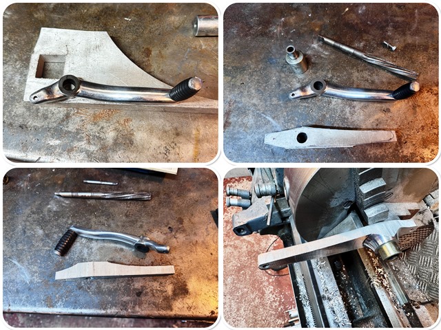

  19. I have done around 300 mile now, its running well! I love the torque, and it actually feels quite quick! It also handles and brakes beautifully. However, it does vibrate, and I had my first casualty… a bolt from the air filter dropped out! Maybe I didn’t tighten it enough, the design of the filter is not the best so I didn’t fully tighten the bolts. sods law it was a special bolt with a breather hole in it… I tried to make a couple in stainless, but I couldn’t broach a hexagon in it as it was way too hard.. I ended up making a couple of bolts in brass. I have now drilled the head on these so I can wire them in place.
    the other thing that definitely wasn’t right was the gear change… When the foot lever was in a comfortable position, the angles of the rod and levers was not right… I ended up making a new gear lever to get it all right. the difference this small thing made was HUGE! Its these sort of changes that make a real difference to how a bike rides.
