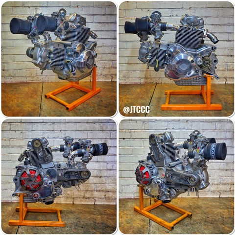

    Started the engine build… these are simple engines to build, just a couple of points to remember… There is one special bolt in the crankcase that has an oil feed hole in it. Its also much easier to pop the piston into the bore, and then put the pin in, the rings are very fragile (and expensive!) make sure you have some rag in holes though, those pin circlips have a life of their own! in one of the pictures you can see a plate which holds the flywheel… this is necessary as the alternator nut and crank nut are VERY tight and need torqueing to 190 NM.

  7. the engine parts I had been waiting for came, and I finished off the belt covers. I also made the housing for the hall effect triggers, the most accurate bit of machining I have done in years as I needed to locate the sensors exactly 135 degrees apart. I will post some pictures later on that. But for now here is the engine!
    • Like Like x 14
