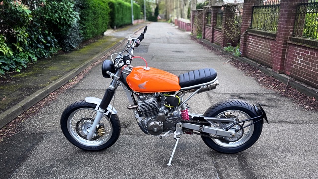

  13. hmm, i think you need to spray the mini orange
  14. Suzuki DR 800 is the largest but would imagine not many in the UK.
  15. Second that :D
