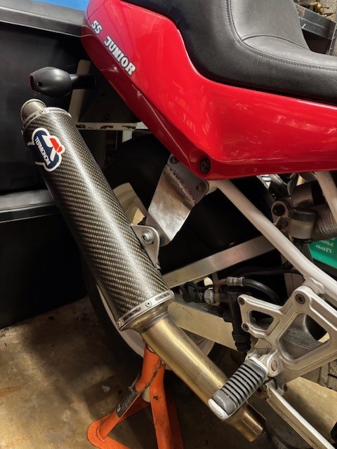

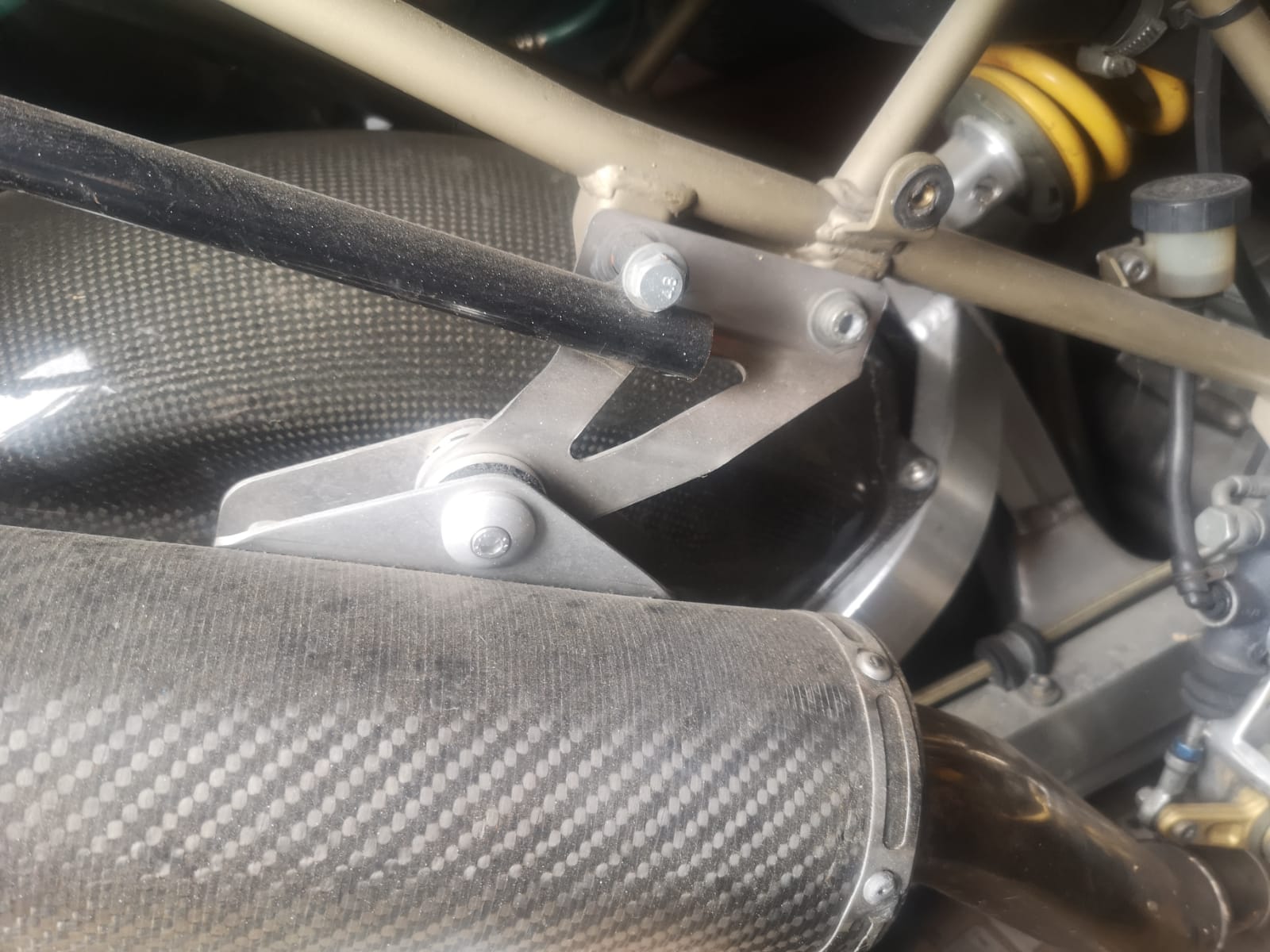

  1. 150 smackers for a pair of Termis! You've scored there! :astonished:
    This is the std hi-level hanger for the SL: (ignore the black tube as that is Ventura rack)
  2. The exhausts are a good buy at that price, but I think you will have to make some brackets for them.
    They look to be low pipes for a 900/851/888 so normally fit to the bottom of the pillion rests but the dims and angle of the 400/600/750 headers are subtly different and exhausts are not a direct fit from the smaller engine to the bigger engine/851/888.
    • Useful Useful x 2
  3. If you want to keep the pillion-peg mount intact with the Termi cans, perhaps consider tweaking the X-header outlet pipes (or modifying another to keep your standard one) to get everything to line up.

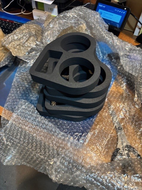

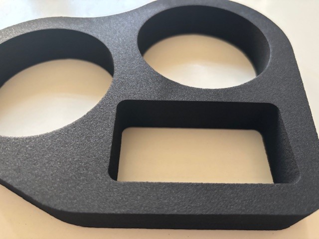

  4. Hi all,
    I ordered instrument panel foam surrounds, and i have spared available to sell. £30 posted (UK), im happy to post abroad but will need to quote on postage first.
    Ive added this in the for sale section of the forum too.
    Just DM me if youre interested.

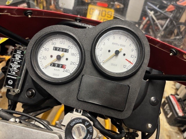

  5. Well done for getting the Foams made.
    Be aware though, the amount of grief I've had even from people on here regarding the Decals was surprising.

  6. Darrell,
    I see you got your foam.
    I provided you the .dxf file of the foam profile in the spirt of helping you with your renovation, not so you can make a quick buck on ebay. Your probably going to tell me there was a minimum order, fair enough I thought that would be the case, but no thanks, no recognition and no offer of a free part for my effort does not sit very well.
    Cheers Gaz
  7. Hi Gaz,
    Happy to provide a little context and explanation.
    Thanks for the .dxf file, it no-doubt saved me a lot of time not having to create the file myself. Furthermore, you did a very good job as the 'fit' is pretty-much perfect.
    I contacted many foam companies asking for quotes, most ignored me, some said no, finally i found one who would take on the job. I guess companies prefer larger production runs...
    I talked to the supplier who told me one-offs were expensive, and that it would make sense to order more if i had a need... So I ordered 5, they cost £180. £36 each.
    I dont know what they are worth to be honest, but i though it would be nice to offer them back to 'the forum', and £30 posted seemed like a price that i would expect to pay, so i went with that... £35 on ebay because i will lose more in fees, etc...
    So probably when accounting for postage, i would have spent £180, used one myself, and recouped £100 - so my foam would have cost me £80. Finally, the foam company did send extra (i guess they have a minimum production run, and included the surplus foam's rather than binning them) - so there is a chance i will break even, however it looks unlikely.
    Not exactly "making a quick buck", and maybe i should have offered you one first... but i assumed that having created the file some time ago, you would already have everything you need - although looking back at the DM you do state that you never printed these yourself, although others have...
    You did not make this file for me specifically, and you seemed happy to help a new forum member by sharing the file, you did not ask me to print a part for you either. I have incurred all of the costs and am trying to recoup some of those back in a manner that i thought was 'in the spirit of the forum', apologies if thats offended you, and if you want a free foam then DM me your address and i will post one to you.

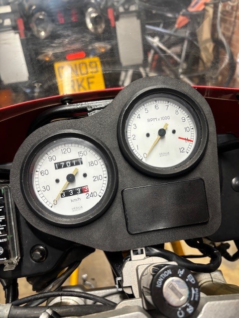

  8. Hey Team, politics aside I received my foam today. Happy Christmas to me.
    Having read Darrel's post I'm even more grateful. Thank you @Darrell
    And thank you @gaz92 for the pre-production work.
    Spurred on by the good fortune of finding this foam, I've ordered one of Nasher's dash light covers/vinyls/thingy. I'll be updating my restoration thread soon with shiny new stuff.

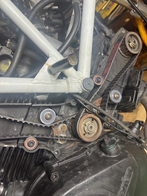

    Ive fitted new belts, just need to learn how to tighten-up the tensioners the correct amount:-

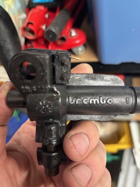

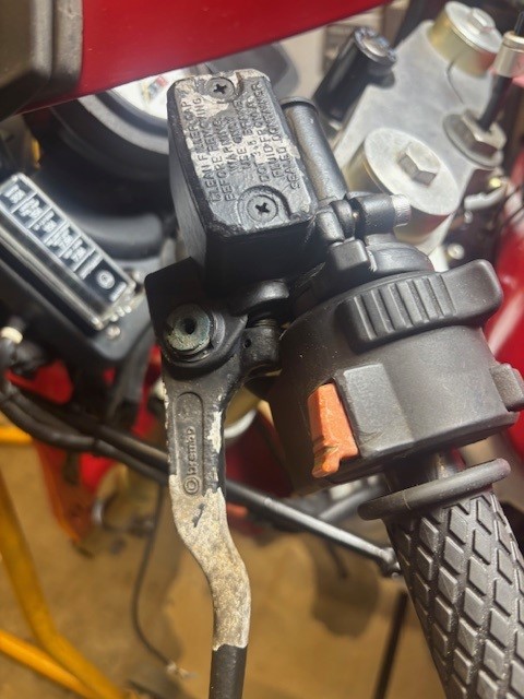

    Ive also routed the braided clutch hose and connected it to the engine, but im not sure what to do with the clutch (and brake) master-cylinders and levers... see below:-
    Any advice or experience in either restoring the paint on these, or replacement parts? Ive not taken the lid off the clutch reservoir yet - but the brake reservoir threads both look terrible, the bolts seem to have torn the threads out due to rust/corrosion/thread-lock... I will run a tap through them but i might be looking for replacement parts :-(

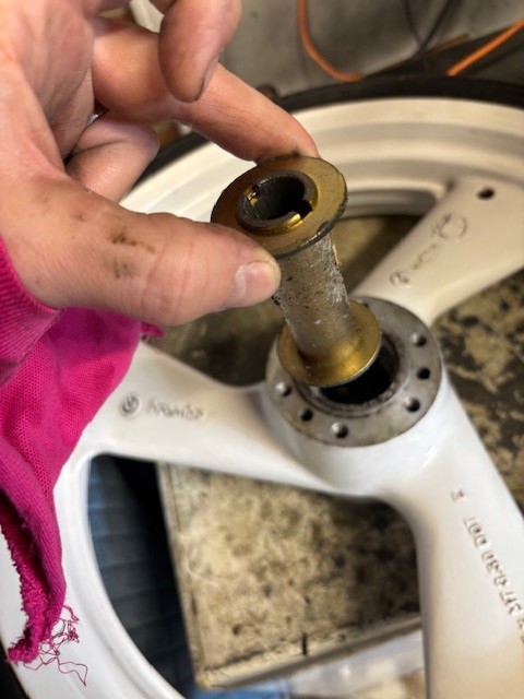

    I started replacing the front wheel bearings but i dont have a bearing puller (and i cant tap them through with a long screwdriver)... so that job is paused while i borrow/buy a puller...

    I would definitely wire brush, prime and repaint the master cylinder cover, they really do come back nicely. The lever, however, I would try to find a similar one in better shape. This one looks like it spent some time at the bottom of the channel…
    Redarding tensioning your belts, there are different methods to do it, and hundreds of tutorials and discussions about this on the web, including on this forum. You will certainly find them via google.

  14. Sonic tension is the right way to get the belts right, and is no more difficult than tuning an acoustic guitar. Just don’t forget that the recommended tensions are ambient temperature related, so if yours is quoted at 99 Hz @20 deg, don’t do it to 99 Hz in a freezing garage.
    You should not need a puller for the wheel bearings, the spacer will have wedged on the inner bearing races. Just get something like a 3/8 drive extension in there and knock it sideways hard enough to expose enough of the lower bearing inner to get an edge on it.

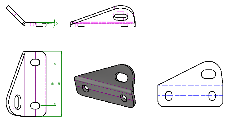

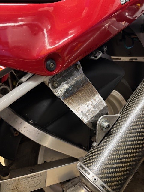

  16. Hope this helps with the exhaust, this is similar to standard bracket that attaches to the exhaust. I have offset the hole a bit and tried to make it a bit more compact as there does not seem to be too much room. I'll send a .pdf, so you can make a templet up, let me know any alterations. The hole centres might be different on Termi.
    Cheers Gaz

  18. Little update:-
    That answers why i was struggling to knock the wheel spacer to one side when removing the bearings...

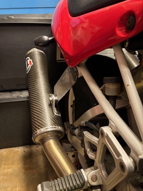

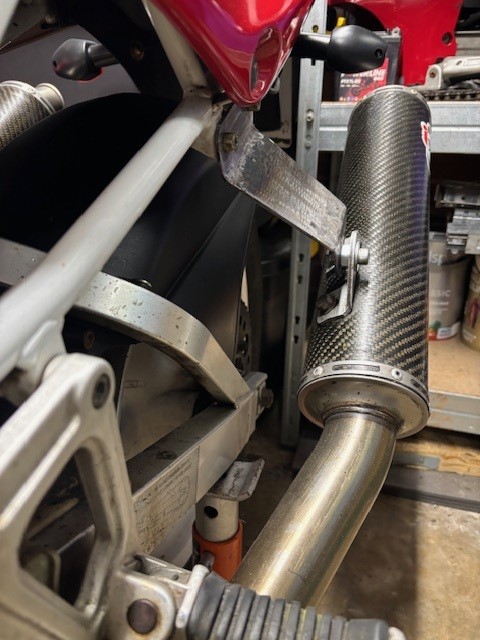

    Exhaust hangers are coming along... Not pretty (yet), and maybe not the final design, but this at least helps me get the sizes right...

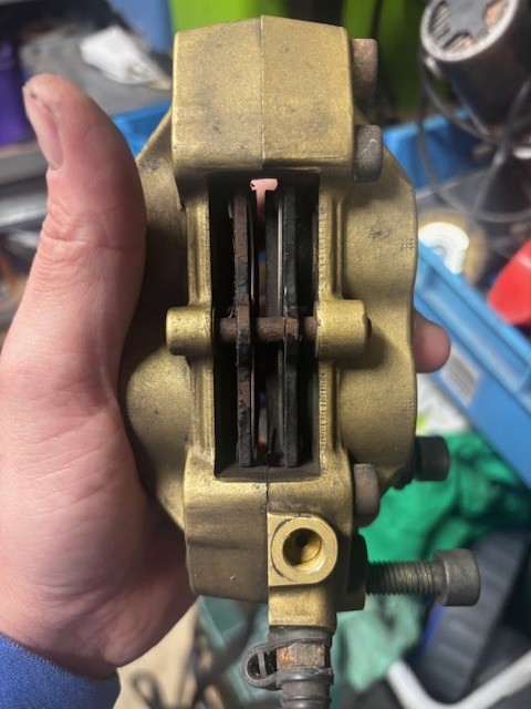

    And need to replace the brake pads... I assume the pin should push out using a drift? There was no r-clip...

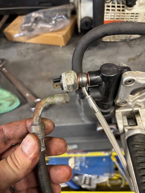

    And need a new brake hose for the rear, as the HEL one doesnt have the right bend in it to fit...
    Odd - I think that’s a rear wheel spacer - the front is normally an non-flanged aluminium tube with (6?) external processes.
    It may be worth checking if they were mixed up during an earlier rebuild (though I would have thought they would be a different width)
