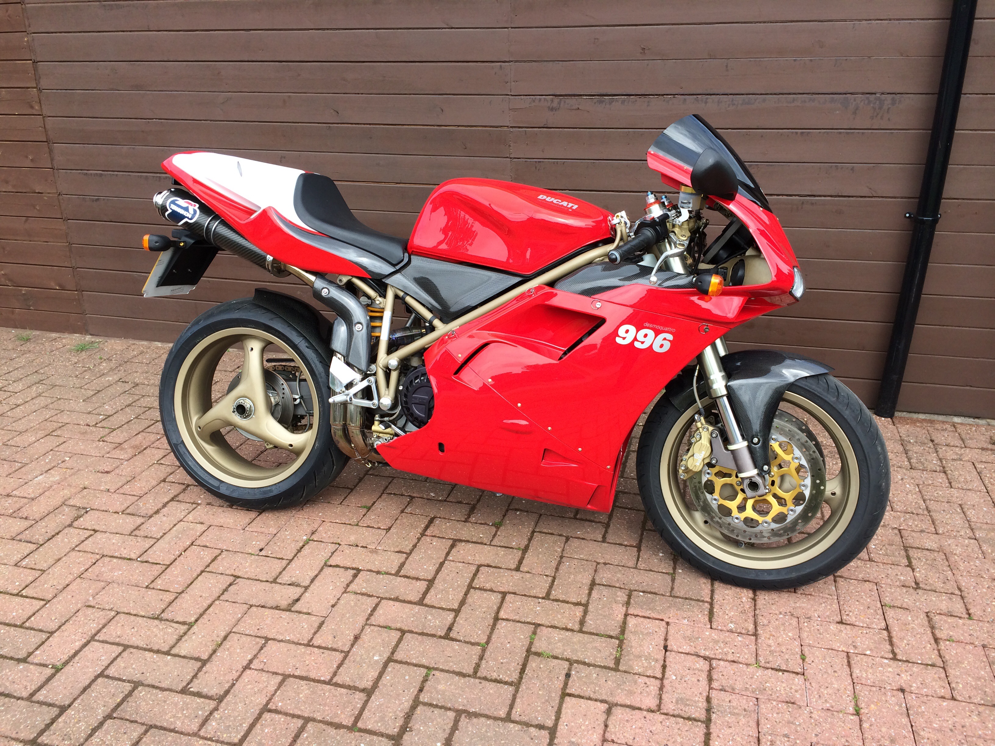

    £6000 seems quite high for a 996 unless its a SP or SPS.However with all those extras you got a good deal imho.A standard one gets what £4-5000.If you put it back to standard and sold the wheels ,carbon seat airbox airtubes slipper clutch etc etc then that bike would owe you way under standard money.
    Personaly I would rather pay a bit more for one like yours with much better spec than standard.

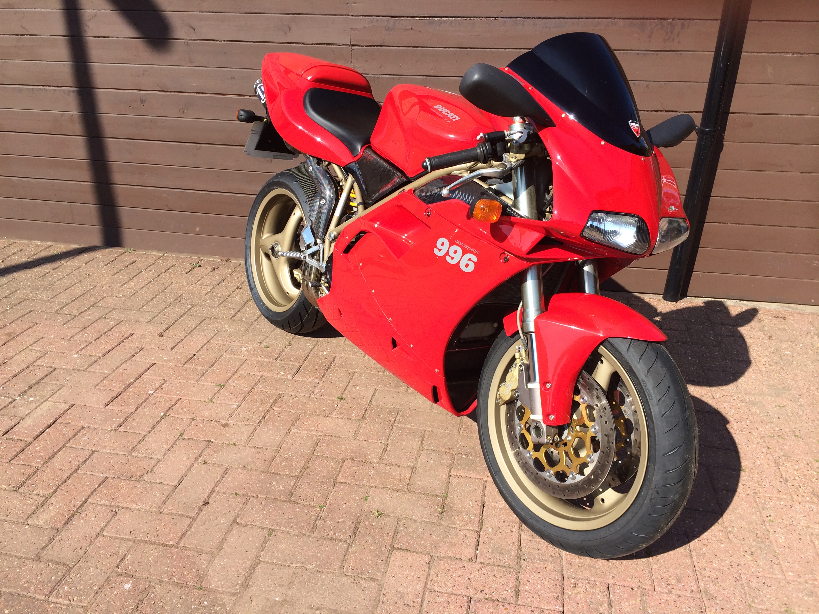

  5. Anyone know anything about these wheels? Are they ultra lite or anything special. Havent seen them close up to see what they are lol.
  6. They look like the old style PVM 5 spoke wheels in either alloy or mag.Nice alternative to marchesini wheels.
    If alloy cast they probably cost £1200 plus new.Forged add a few hundred more and magnesium add another grand.
