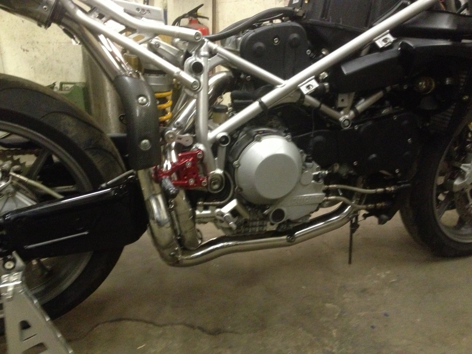

  10. New pipe fabricated.

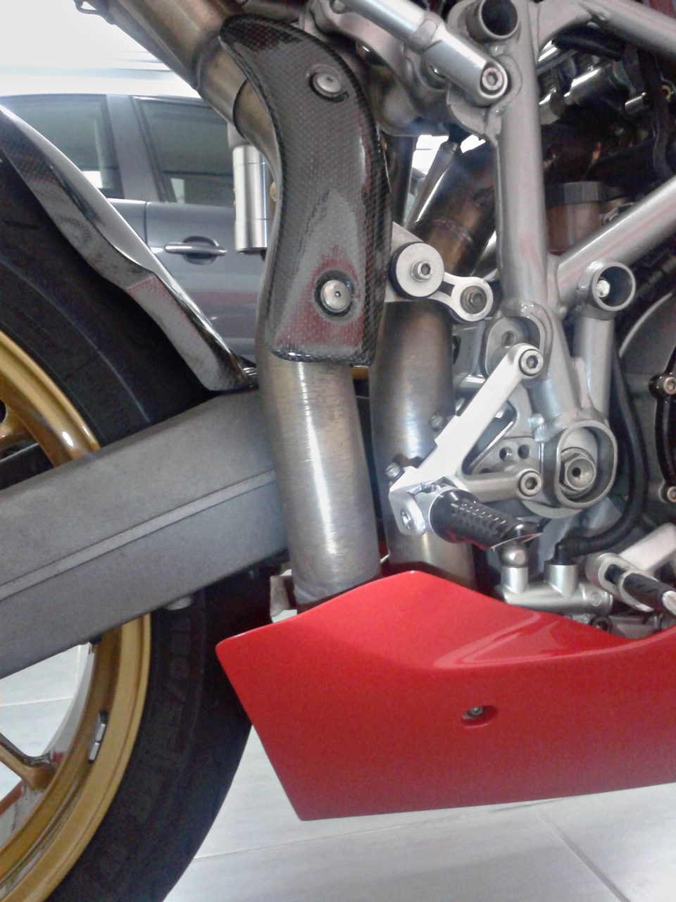

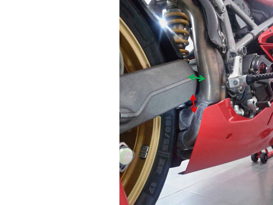

  15. I apologize to insist but took this 2 pictures! Would these help in order to tell me if it will fit or it will need any modification?
    Many Thanks!!:)
  16. I don't think your issue will be side clearance as in the green arrow - it will be depth as the black arm sits lower and is much deeper than the grey arm. I have read some people have fitted with no issue but also read that the black arm will clash with your exhaust.
    Looking at my 999R with full Ti system (2003) and my prototype 999 with black arm fitted, even side by side it is difficult to measure up to see if it will clash. But side to side clearance looks to be identical when measured, i.e approx. 170mm from the swing-arm to the end of the foot peg at a given point of comparison.
    I have a black arm waiting to go on mine so will be interested on the result, you might have to just go ahead and try it to see what happens :)
  17. Just looking at your photo there ,,,, with my 54mm they come further back. , ( on side view ) they come almost to end of the fairing , which looks like they would foul on your grey swing arm , maybe the black box has more clearance at that point .
  18. That doesn't look like a 50mm system to me - more like a 57mm 2-1-2 job.
  19. Definitely not a 57mm system.
  20. It really is 50mm system. :)
