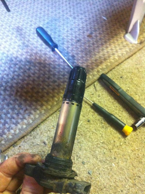

  15. Hi guys. So bit of wd40 and wigglin works wonders.
    Got the plug removed. Looks like this.
    Does this open?looks sealed unit to me.
    Sprayed contact cleaner on the 3 pin connectors on cable but apart from that I don't know what it should look like

  17. Can I please add that the first pic above here does NOT have two screw drivers sticking from it.
    Just looked at post and pic may imply that. Lol.
    Screw drivers were on floor. Not relate to the thing in my hand.
  18. Ah right. I was thinking you had a bout of Rage & stabbed it? :biggrin:
    Black stuff in the plug chamber does look like oil?? No idea how that would get in there tho?
