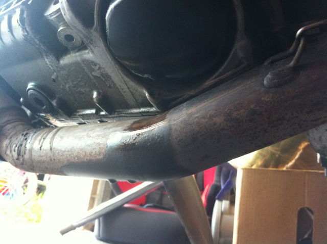

  14. Started bike in garage with fairings off.
    Noticed small amounts of oil dripping from the bottom of the oil filter onto the exhaust pipe below it.
    Also noticed the probe I removed from the horizontal cylinder was oily.
    Is there too much oil in this bike or has something gone?
  15. I'm beginning to think that this is a bike that could usefully go to a dealer for them to sort it.
  16. Was this AFTER you changed the sparkplug out? Has the plug been done?? :frown:
  17. That could just be the filter seal.
  18. That could be a leaky filter seal and by probe I take it you mean coil pack. have you tried to see if you've got a spark yet .
    As Glid says though you could use the services of a dealer methinks.
