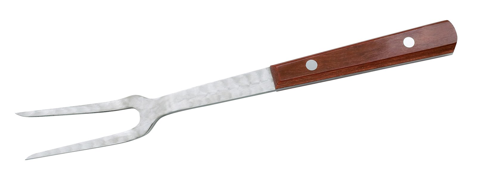

  2. Hard knock, if you don't have a spare battery lead you can bridge the two heavy duty connectors of the solenoid with one of these Fork-Fork-Carving2[1].jpg it takes two seconds. However 12.5v on my batteries (across the terminals under no load) indicates time for a new one (or the meter needs a new battery)
