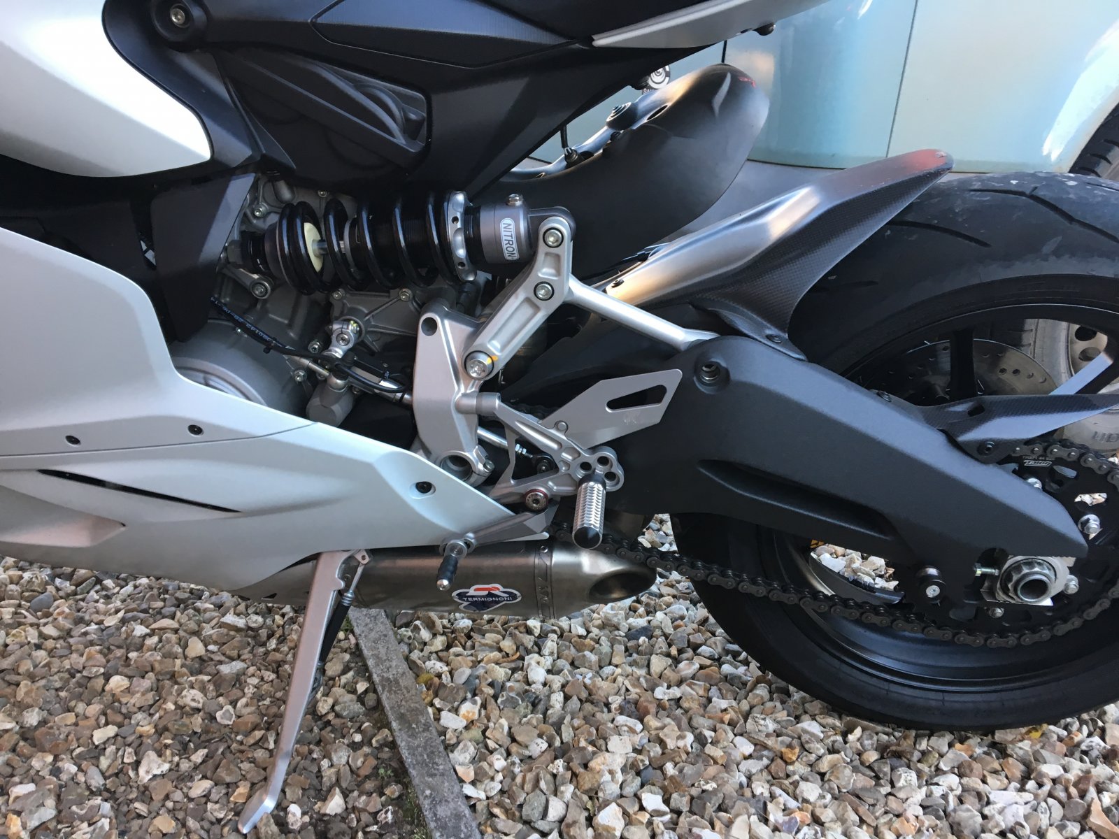

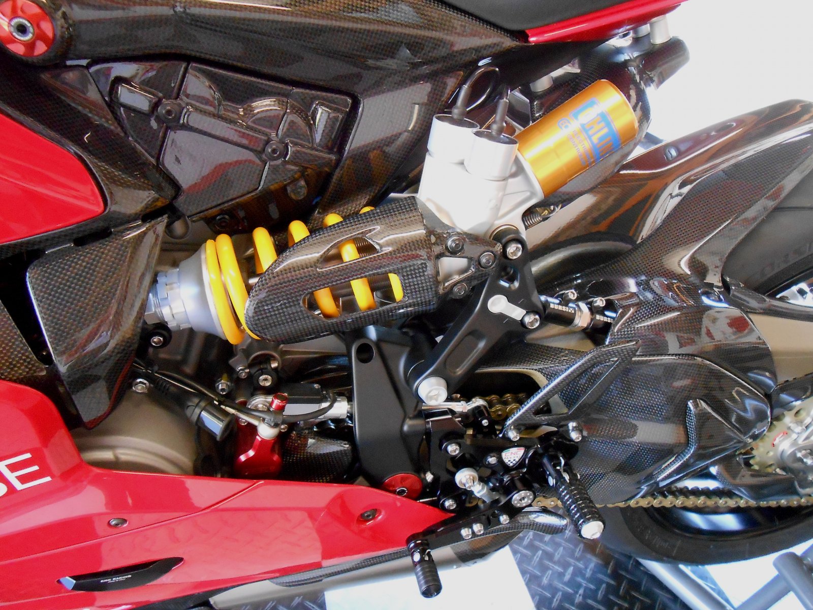

  1. I fitted a Nitron shock from my 1199 to my 899. There was a small issue with part of the top mounting eye fouling on the 899 linkage, but this just meant I had to mount the shock upside down, i.e. the markings on the spring are now hidden but it's just a cosmetic difference rather than anything mechanical.
  2. So, with a little Poirot style deduction, are we safe conclude that the 899 & 959 shocks are interchangeable, the 1199 fits the 899.....and the 1199 fits the 1299......drum roll...... Then surely the 1299, 1199, 959 & 899 are all interchangeable???
    Obviously don't take my word for it, I haven't even got a panigale yet ;)
  3. #403 flatstick959, Oct 25, 2016
  4. @flatstick959, can you please take some photos of how you used the teflon spacer and sleeve when you have installed the damper? Couldn't quite figure out the best way to fit my new Ohlins on my 1299.
  5. Also the instructions say to cable tie the brake reservoir pipe out of the way but mine wasn't touching. Not sure if it's different on 1199 and 899 - I think they have different mounting brackets for the reservoirs
  6. Thank you @flatstick959 I did it the same way but there seems to be a gap between the chassis and the damper. Seems like there should be a spacer at the bottom in addition to the one on the top.
  7. There should be a slight gap so the ball joint has room to swivel.
  8. Would we say that the ohlins damper is worth while on the 899, I've never really felt a problem with the standard one on the 899...
    1199/1299 though is well and truly under gunned for the job!

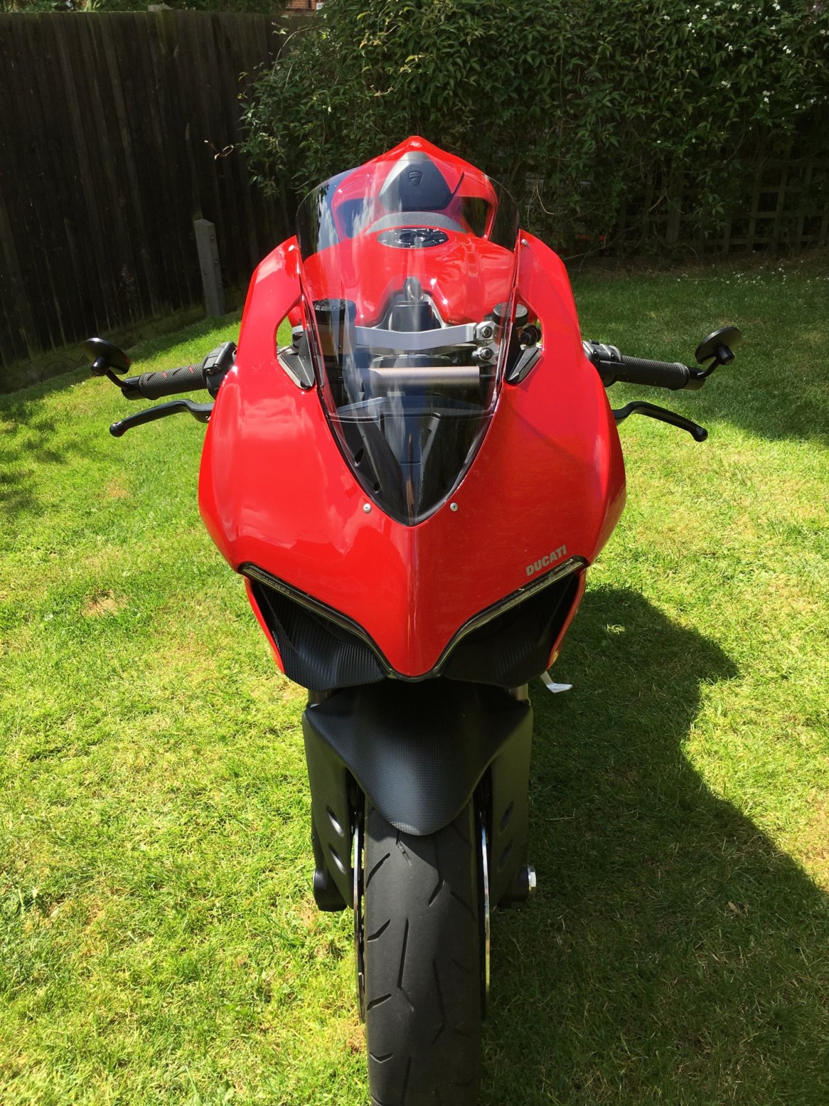

    Also removed the mirrors for indy blank offs (very pleased with them, very bright on a pitch black m25 last night)
    New puig grips and screen too.

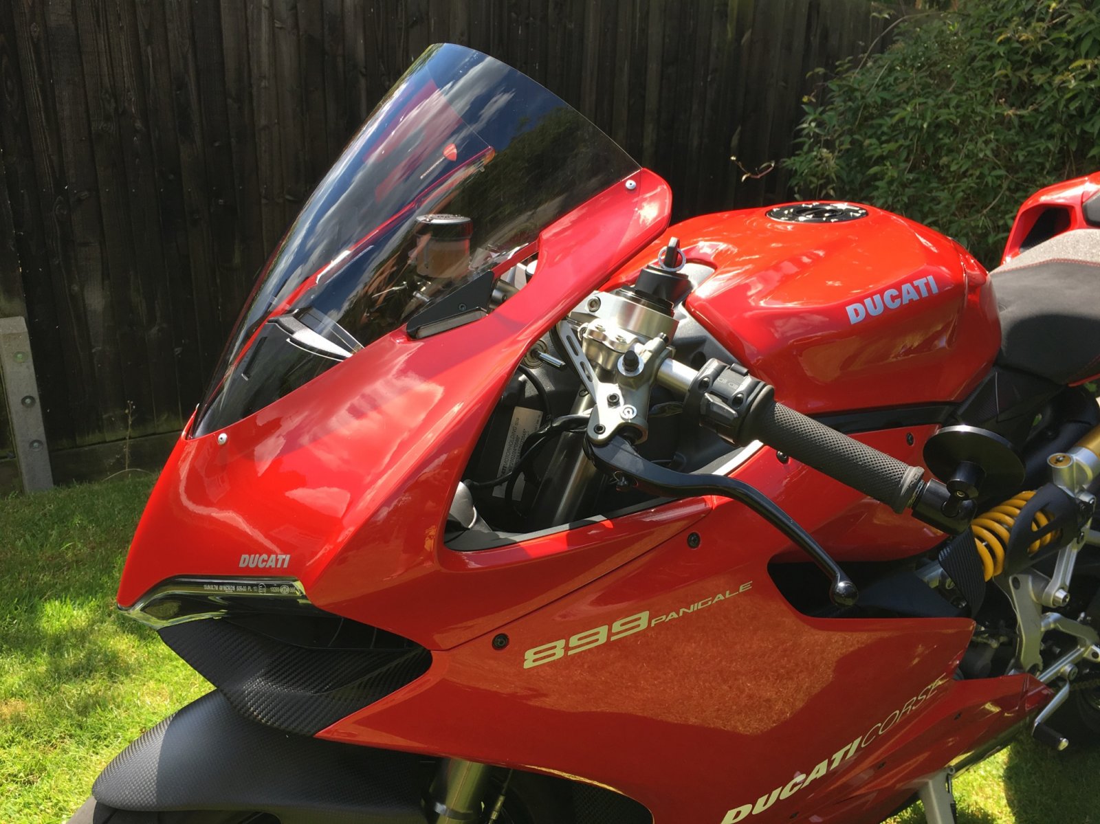

  12. bike feels really tiny with no mirrors lol
  13. Nice, looks much better without the mirrors.
    I did mine a few months ago and thought it was also much quieter with less wind noise?

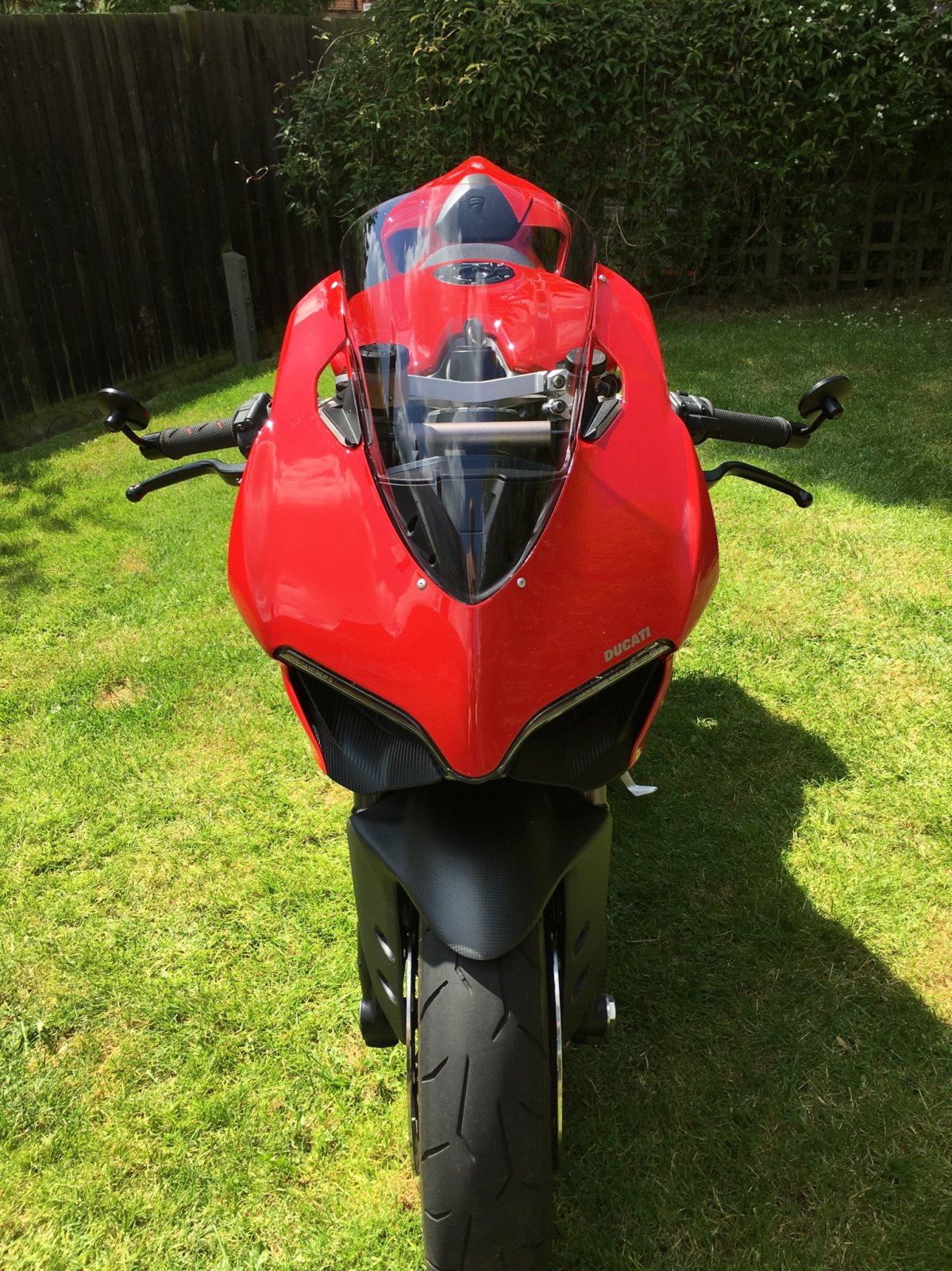

  14. But how do you see behind you?
    Bar end mirrors, I can now see behind me without moving my upper body to see past my arms.
  16. What make mirrors are they and how tiny is everything?
  17. They are Oberon street fighter mirrors, 60mm.
    They are small but I find them better because they are now in a more useful position.

  19. Had the shock fitted. Liking the lack of yellow...
