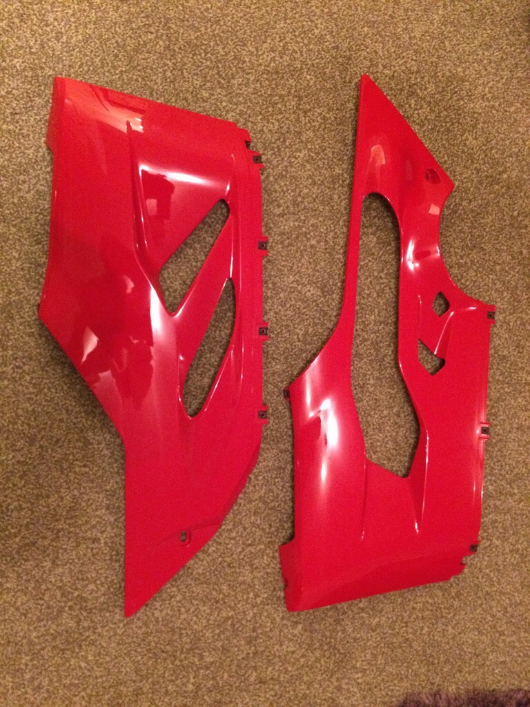

  10. [​IMG]
    Job done

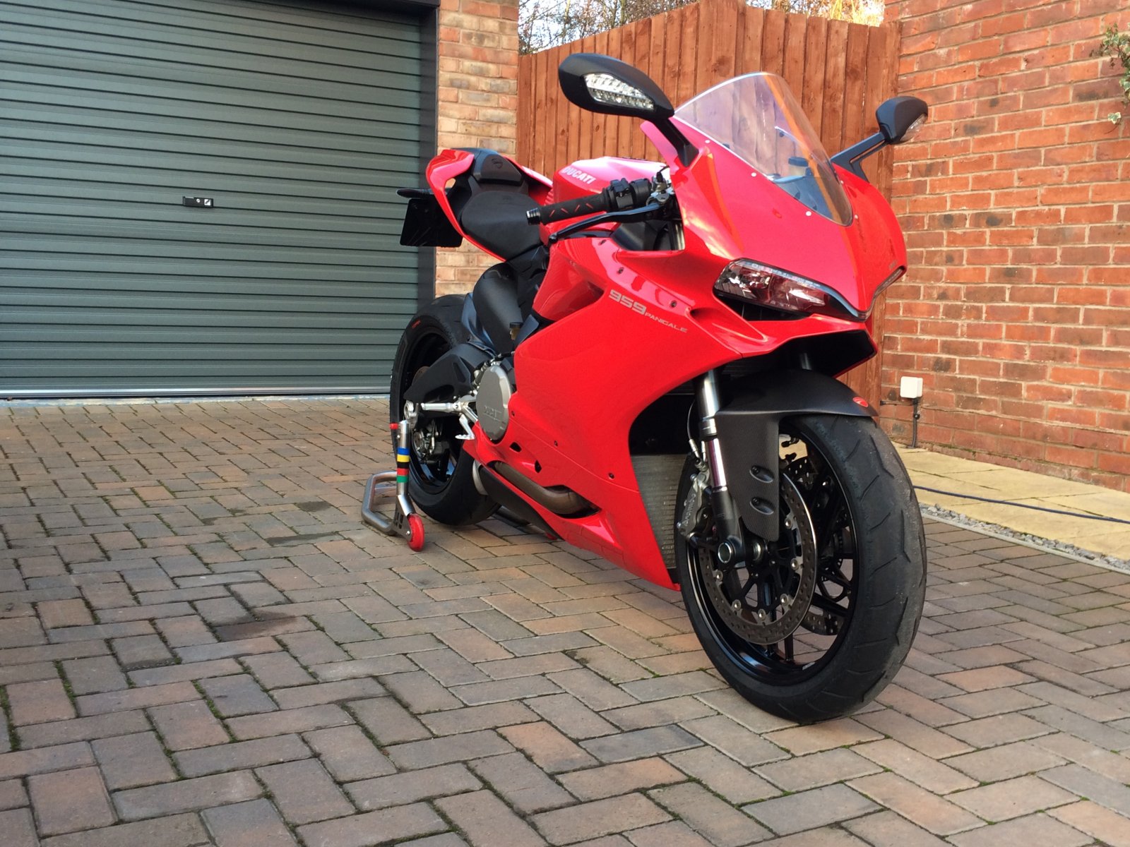

  16. Finished installing my 1299 exhaust (except for fairings, which are on back order)
    Bit of a pain in the backside of a job (like so many on these bikes - certainly not like a jap bike!)
    The bike feels noticeably lighter pushing it around and feels smaller without the pipe up the side.
    Not the most straight forward of jobs - I found it easier just removing the rear header and releasing the shock/swing arm Bolt as it's extremely Tight getting the link pipe disconnected.
    http://s1110.photobucket.com/user/elbowsg450x/media/84883F6D-F14E-42CD-AAE5-393CEDBF5590_zps2awjz1eb.jpg.html][​IMG][/URL]
    http://s1110.photobucket.com/user/elbowsg450x/media/AE0D015F-8E1A-4C4A-A142-695FD44A5A89_zpsmmhkc1ka.jpg.html][​IMG][/URL]
    http://s1110.photobucket.com/user/elbowsg450x/media/E73D39DA-0276-475A-ADDB-E6EC53F8EC26_zpsuvvabgg8.jpg.html][​IMG][/URL]

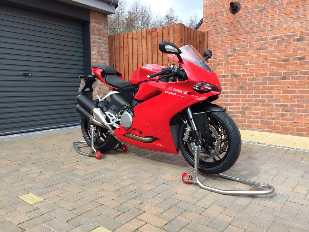

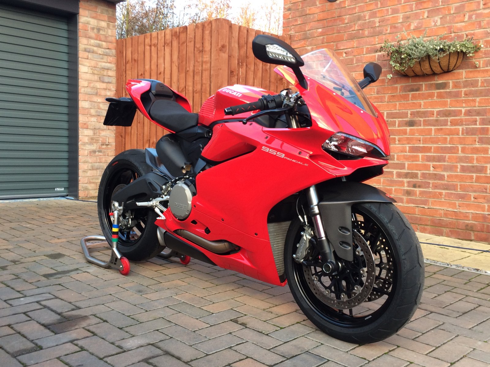

  17. My fairings unexpectedly arrived so got them on right away.
    Before
    After

  18. Just looks so right now - stunning
  19. Thanks
    I wanted to remove the cylinder head plastic trim also but it looks a right pain so left it on. I think it looks much better when you can see the engine.
  20. Anyone else notice the other difference in the before and after you pics?
