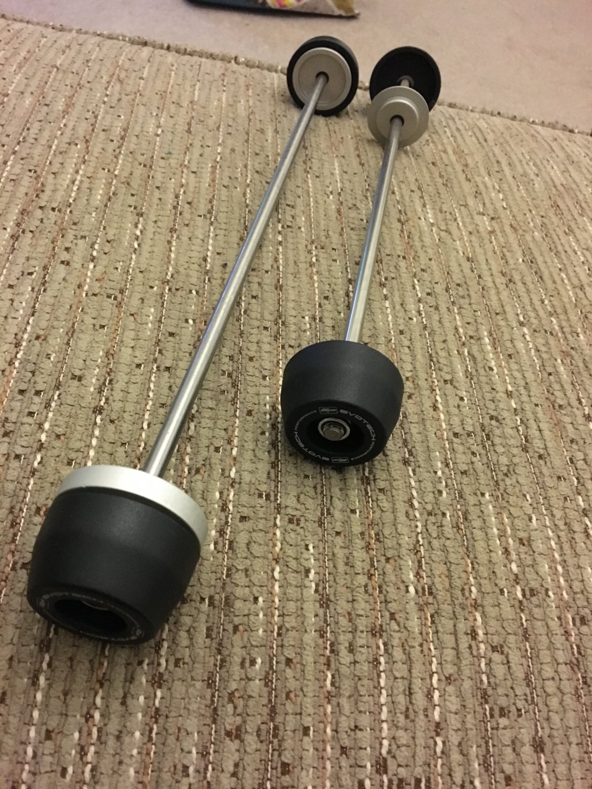

    Christmas pressie

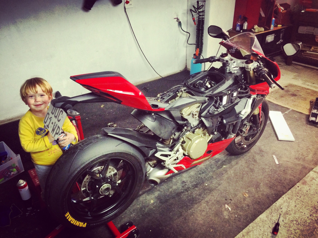

  7. I took a lot of plastic off.... I took the head plastics off first. Not that much of a pain, loosen the sub frame and lift it to get plastics out. Looks 10 times better. Then removed the shock guard plastic, reduced the hugger and cable routing. Removed the shark fin and chain guard.
    Uncluttered the swingarm side basically.
    Polished the OEM exhaust headers
    Only mod that has cost anything was the QS by translogic. Well worth it.

  9. Cheers so you just loosen the 4 subframe bolts and pull it up? How are the plastic panels held on? How may bolts and where are they?
  10. Remove the seat
    Remove the fuel tank
    Remove the 2 lower subframe bolts completely
    Loosen the left and right subframe bolts, lift the tail piece until it clears the head plastics and tighten the left and right bolts a bit so that the tail piece stays in the tilted position,
    Now you can loosen the plastics with all the visible bolts, put them all back after you remove the covers.
    Left hand side wire really routes next to the frame...

  12. [​IMG]
    Looks like a lot of work, but it is easy.
    To make it all look really good you actually need some early 1199 bolts to clean up the look, I will do that later.

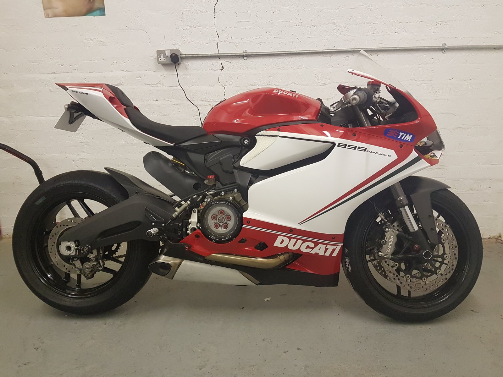

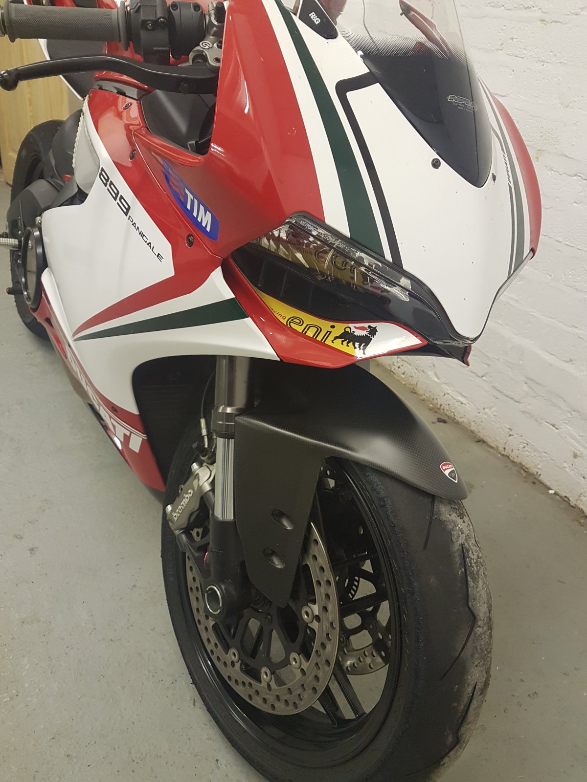

  14. Yesterday was spent fitting the 1199 clutch case, ducabike clutch cover, DID gold chain and carbon front fender. A few hurdles along the way, but chuffed with the result
  15. Looking good. Where did you get eni stickers that are under the lights from

  17. Cheers. Rob Jarvis printed them for me, he's on here.
