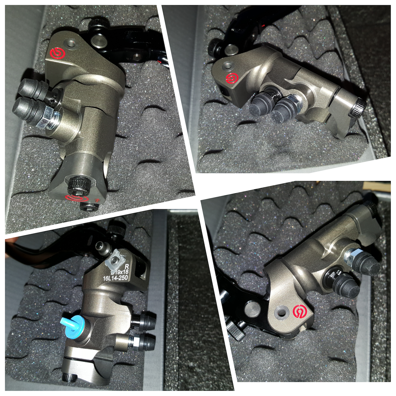

  2. Billet Brembo MC delivered, what a beauty!!!
    Still waiting for matching clutch to arrive.
  3. How much did you pay for it buddy?
  4. Them billet mc are real nice. I had both brake and clutch and sold them. :Eggonface:

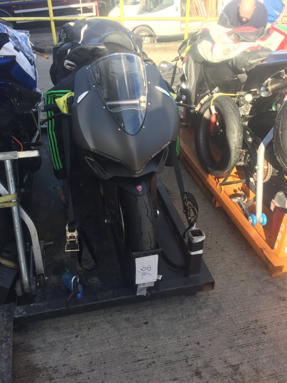

    Loaded and ready for its first holiday

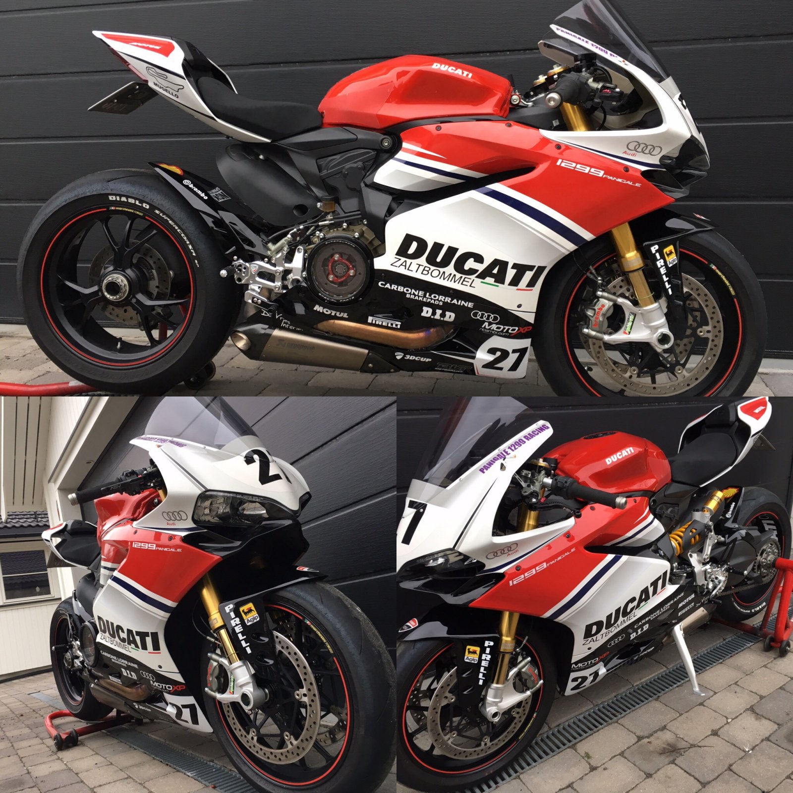

  7. Fitted Ohlins forks and rear shock, Ohlin steering damper, CNC rearsets and new fairings. 05842191-A78D-4D43-9194-E3E594C82949.jpg

  8. Stunning.

  11. Nice fairings, can I ask if you commissioned the paint yourself or bought them ready done? And if so where :)
  12. Bought the stickers here:
    Ducati - Motoxp Ricambi Zaltbomme
    A friend of a friend did the painting after I put the stickers on.

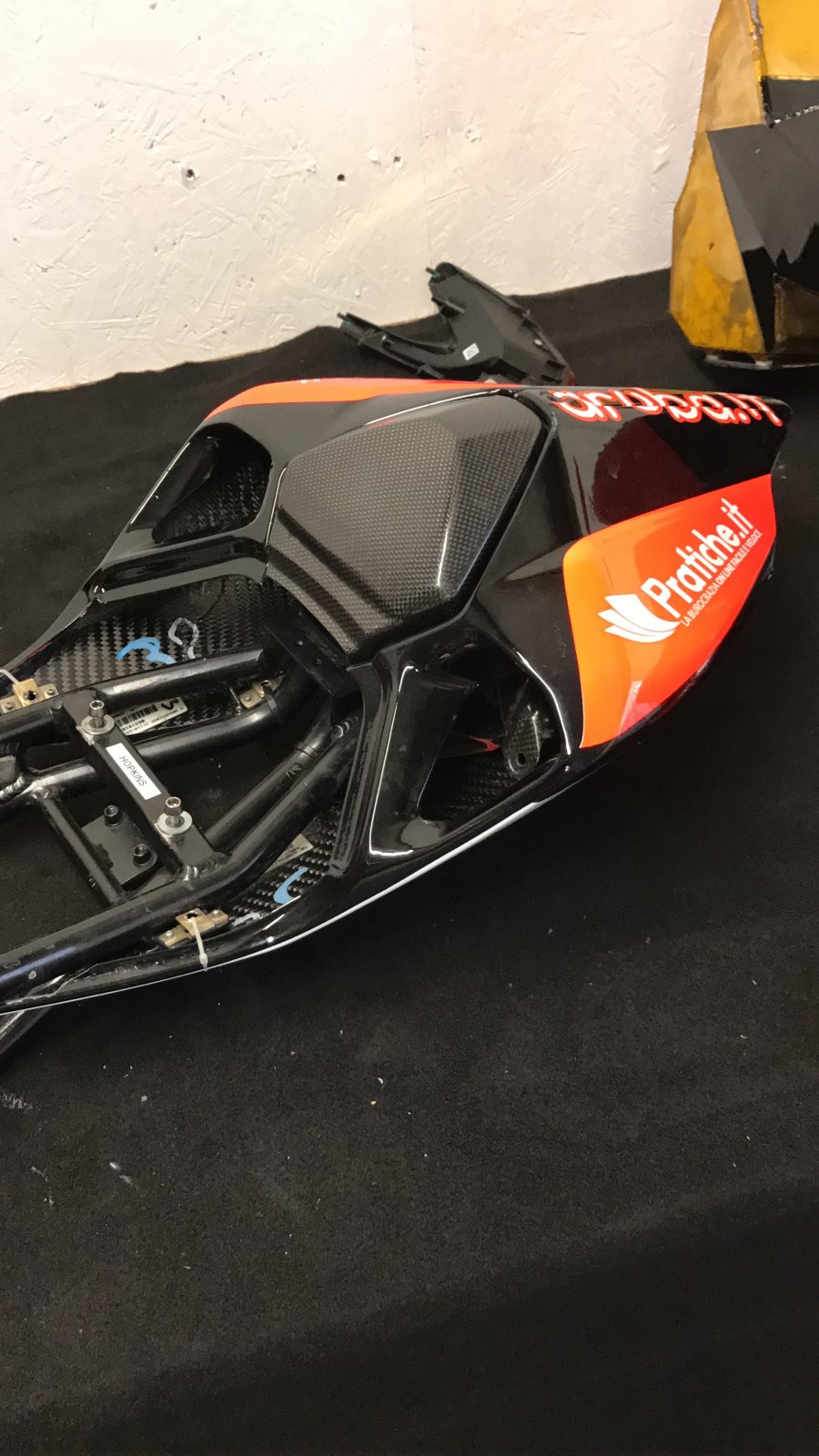

  13. It wouldn't have fitted anyway, the pipe work is different and all fixing points, i have the f015 subframe for the rs and had to cut bits to get it to fit on mine
    That is the genuine wsbk tail section from chaz's bike
  14. one of the Motorapido ones?
  15. Yes mate
    I have the f015 RS so i played around with the tail sectuon to get it fit my subframe

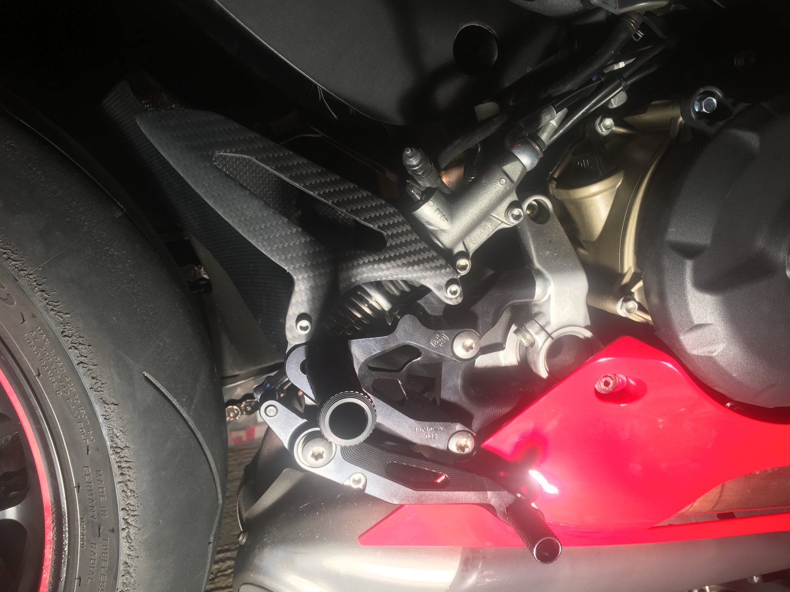

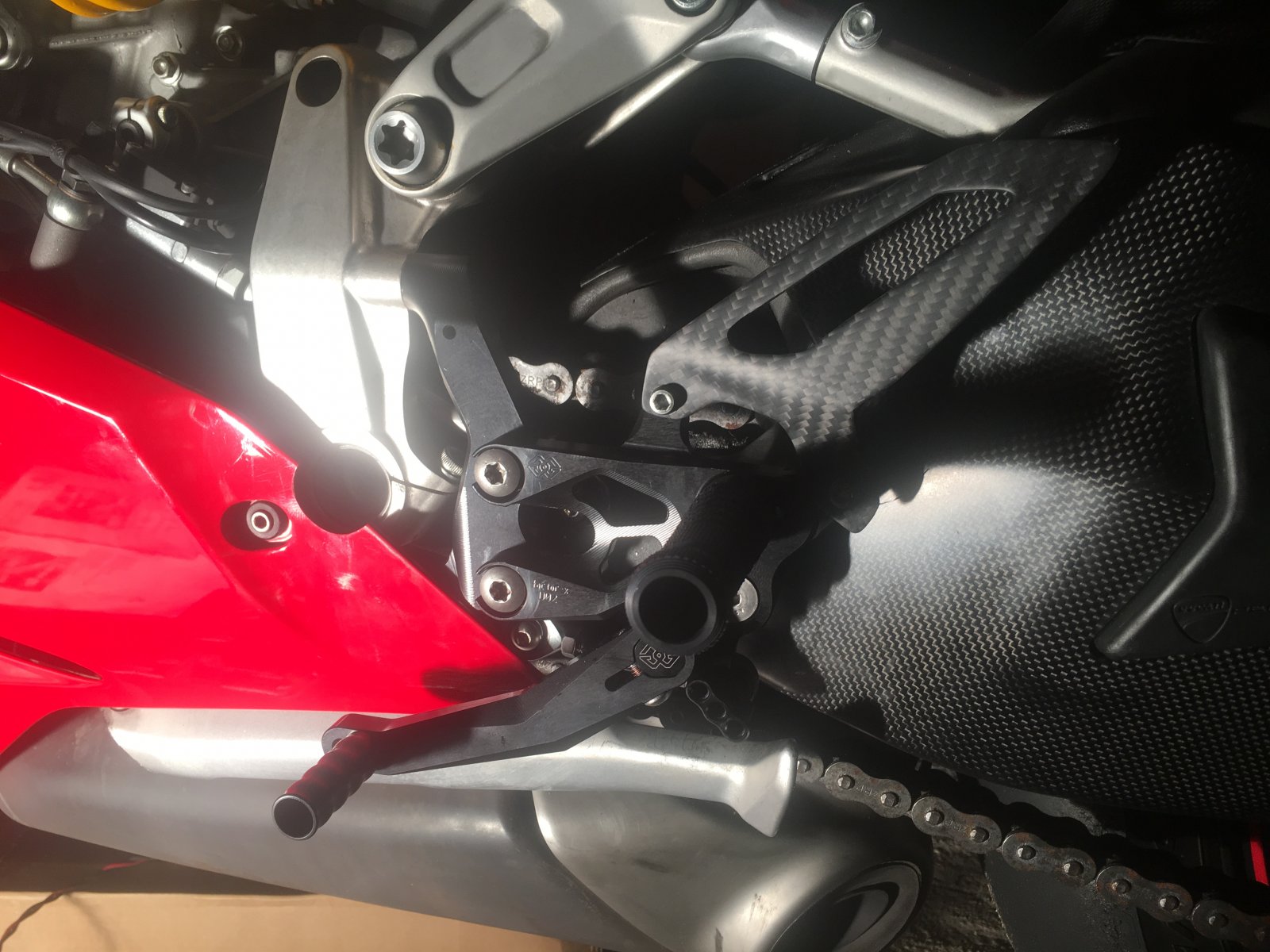

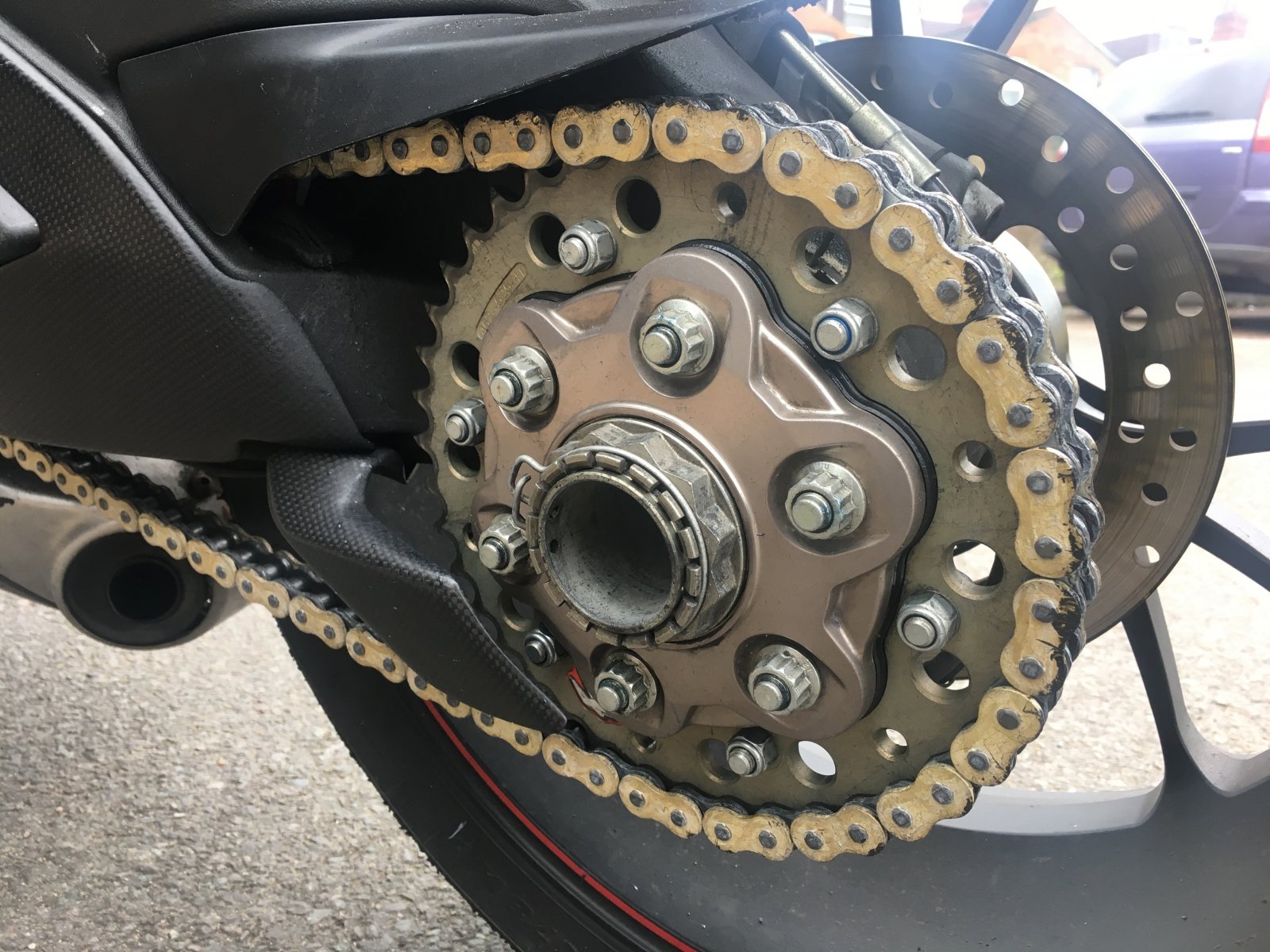

  16. Some Gilles FXR rearsets and a new Renthal chain and sprockets (+2T on rear because the 1299 is a bit of a slouch!):

    How much a adjustment is there? Did you measure the difference?
  18. They are not infinitely adjustable like the VCR ones (but are £200 cheaper). From OEM, the three holes for the footpegs are:
    10mm up & 10mm back
    20mm up & 10mm back
    20mm up & 20mm back
    I have mine set at 10mm back and 20mm up from OEM. Doesn't feel a lot diffferent, but should give a little more clearance on track.
  19. Ok cheers
    The VCR ones can go lower according th the chart which would be useful on the road. Not really keen on the look of the VCR type though
