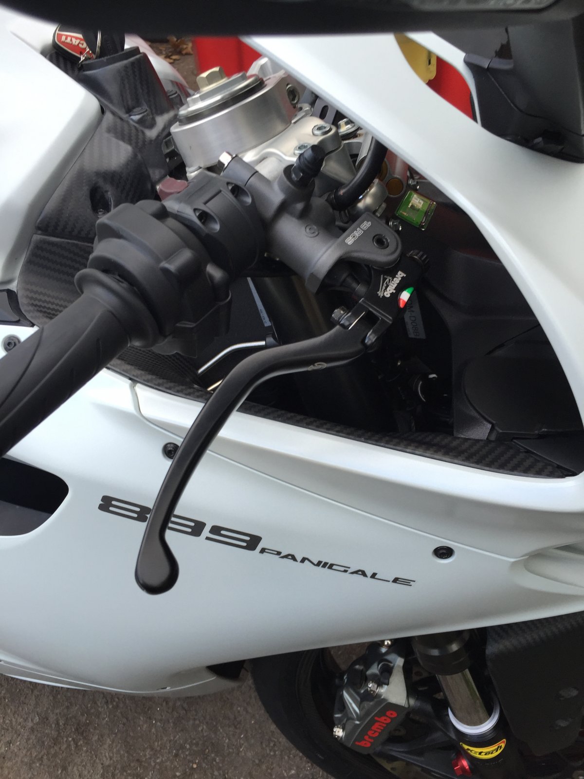

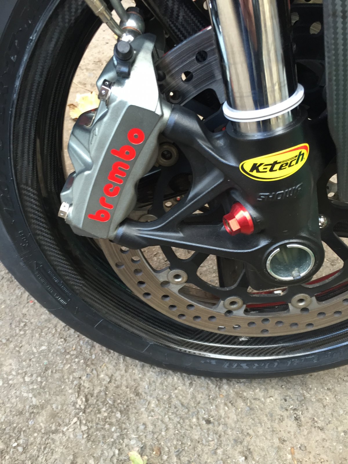

  5. Brembo master, 1198r calipers ktech inserts and sigma clutch in, big improvement

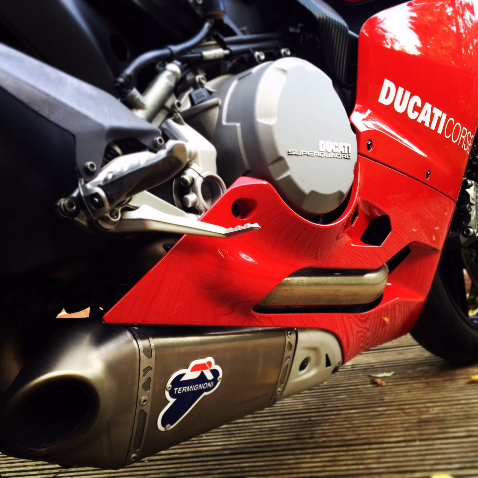

  6. Termignoni cans
    DP carbon heat shields
    DP rearsets
    DP heal guards
    DP screen
    DP race seat
    DP mirror blanks
    Seat cowl and rear comfort seat
    Evo tech rad gaurds
    Evo tech tail tidy

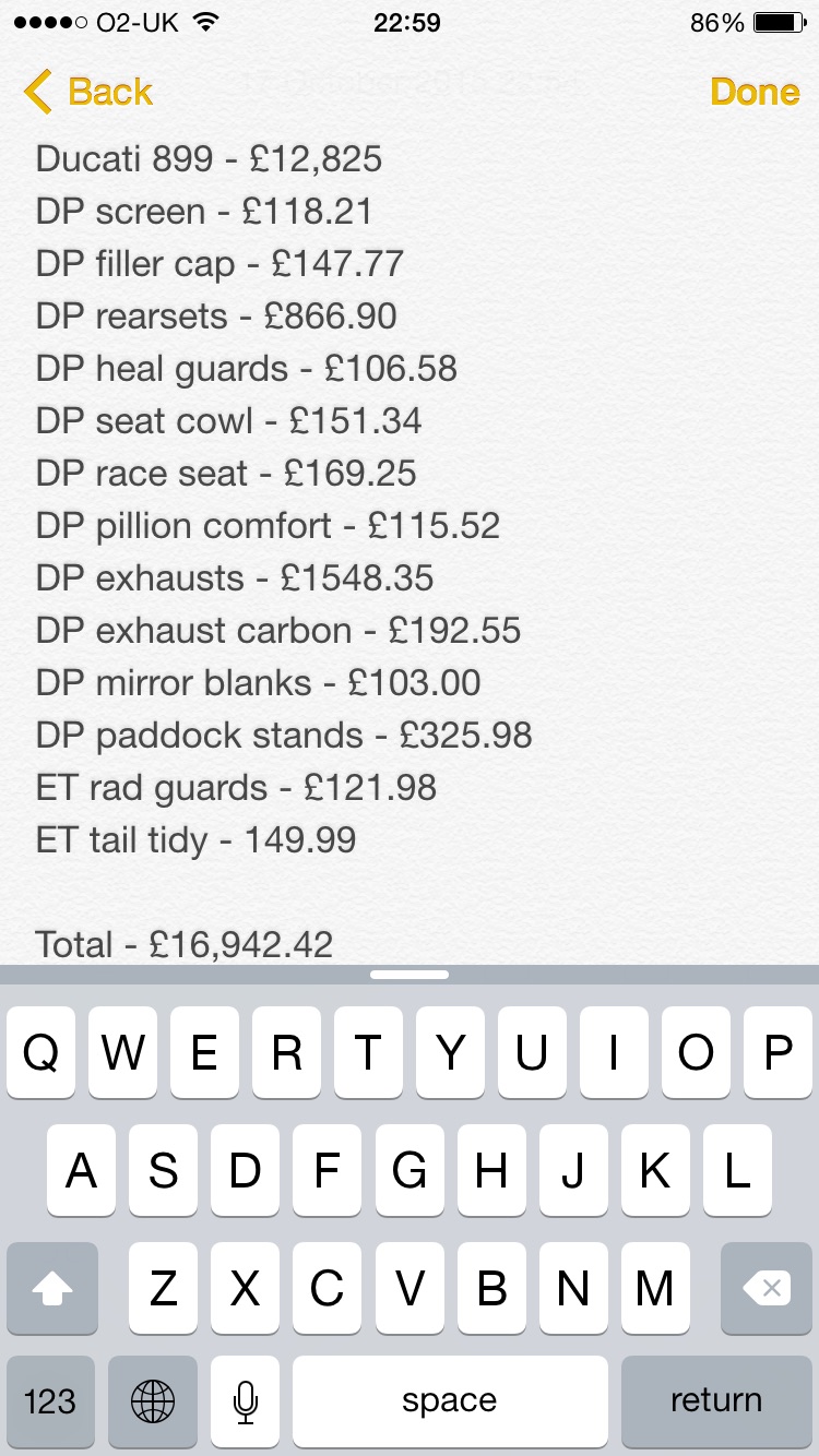

  7. So having put down what I've done to my 899 which in all fairness isn't that much it had me thinking how much have i actually spent?? I did get certain things cheaper but t he RRP....think ill stop where i am
  8. Just out of interest why remove the standard monoblock calipers to replace them with the older m4 monoblock? Surely a step sideways Rather than forwards as I'm sure tech has got better since 2007 when they were first seen on a 1098. I'd of gone to m50 calipers from a 1199 but understand they have a wider track so a bit more hassle
  9. I dread to think what my total spend is. I've been through 2 carbon huggers, 3 different heat shields, I had a ducabike clear cover then decided I didn't like it. I could have easily bought myself an S model with the money I've spent, but hey ho :)
  10. Valid points, the m50's don't work unless you fit the 1199 abs pump, I have spoken to people that tried and they had issues with the abs cutting in all the time and warning lights on
    So I tried the m4's and they have the same feel and bit as the m50's, theirs a big improvement in performance over the standard calipers which I didn't like the feel off and on track they didn't fill me with confidence on the late breaking front
    Along with the 19mm master cylinder they now stop as well and as quick as my mates 1199 so job done
  11. I had a 848 fitted with M4's and HEL individual lines and the brakes were brilliant. I tested a 899 and the brakes were rubbish compared which made me a bit confused. I ended up buying a 1199 which was in a different league with the M50's. Now ive got a 899 and my brakes are loads better than the 899 i tested originally. Id say a bit better feel than the M4 on my 848.

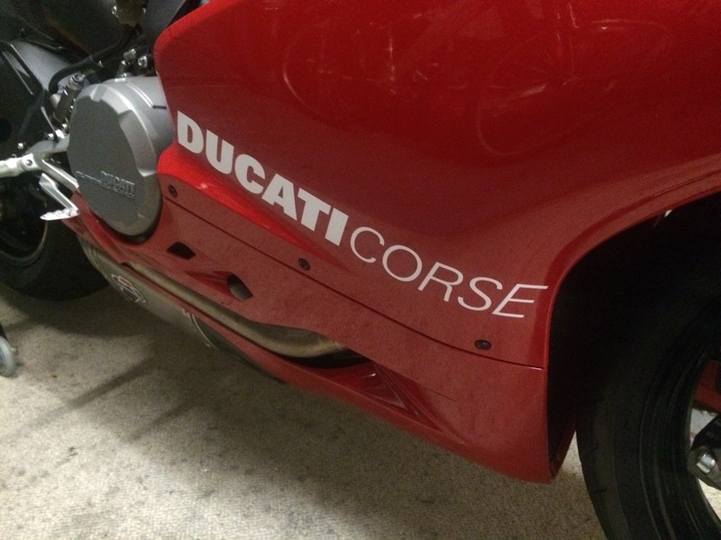

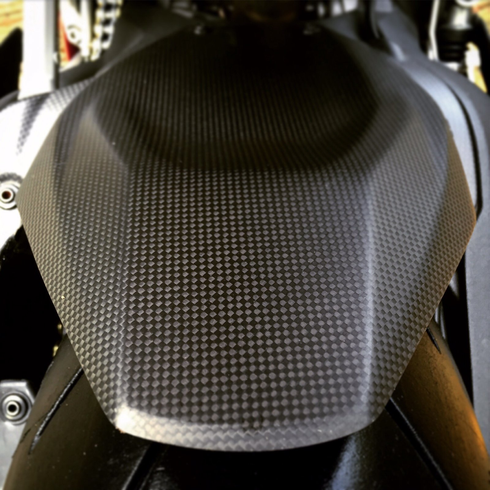

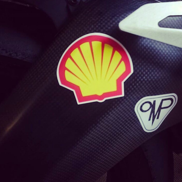

  12. Put some decals on today

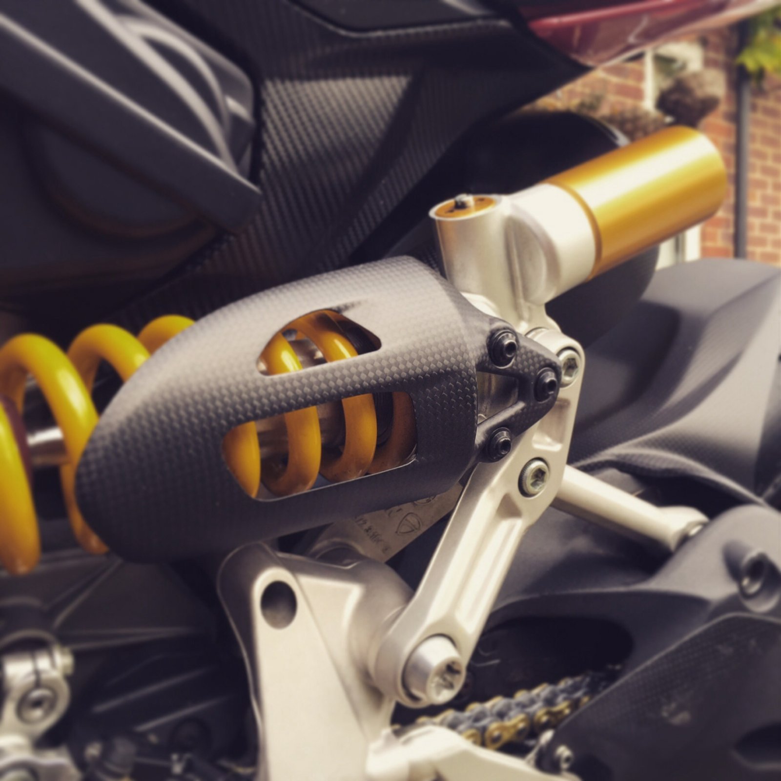

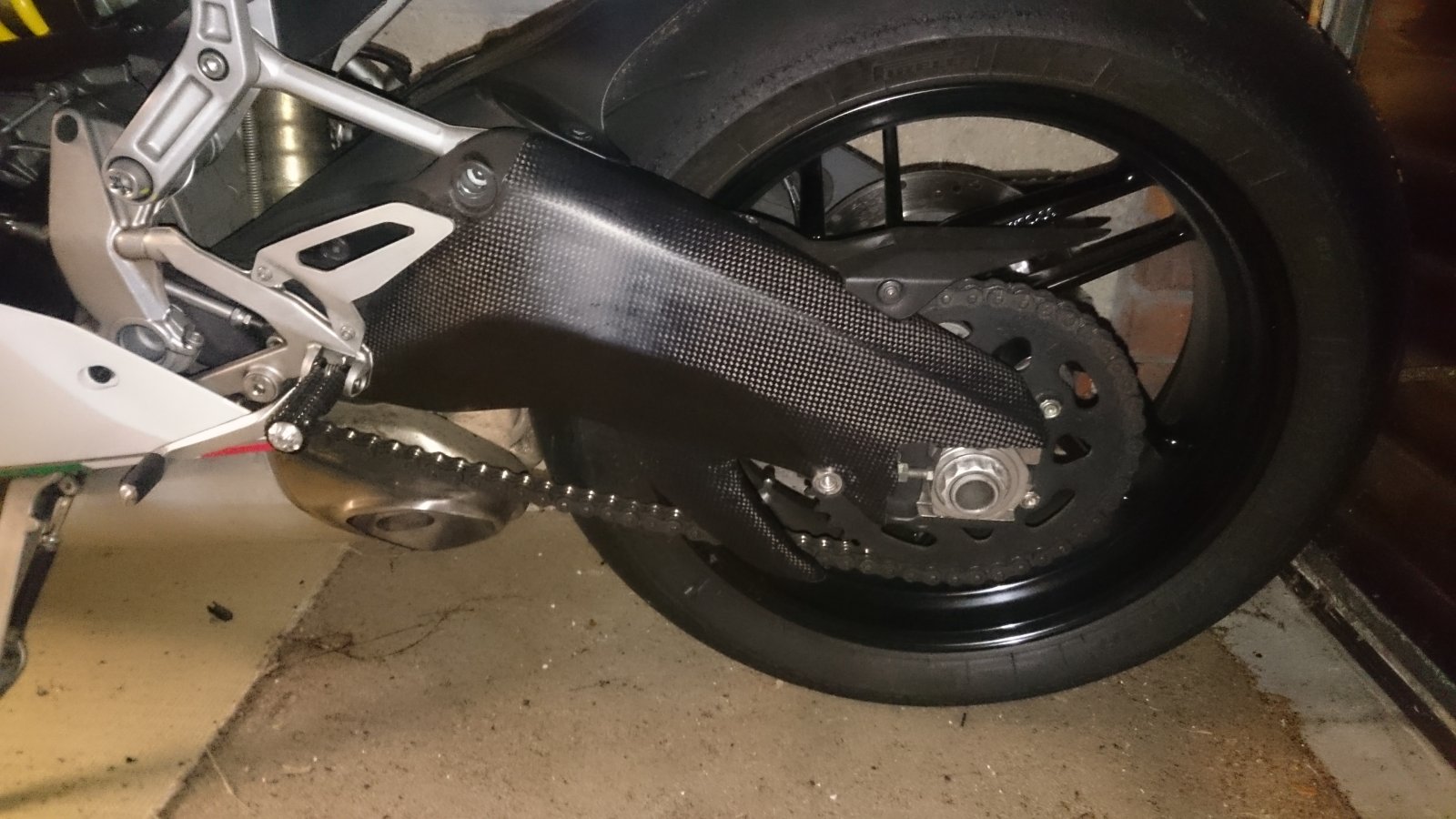

  13. Jhp swingarm covers!
  14. 1199 indicators fitted and recall on the clutch oil seal done
  15. Jhp swingarm cover left sidepic, with sharks fin toe guard all incorporated in one piece. Love how swing arm now looks solid.

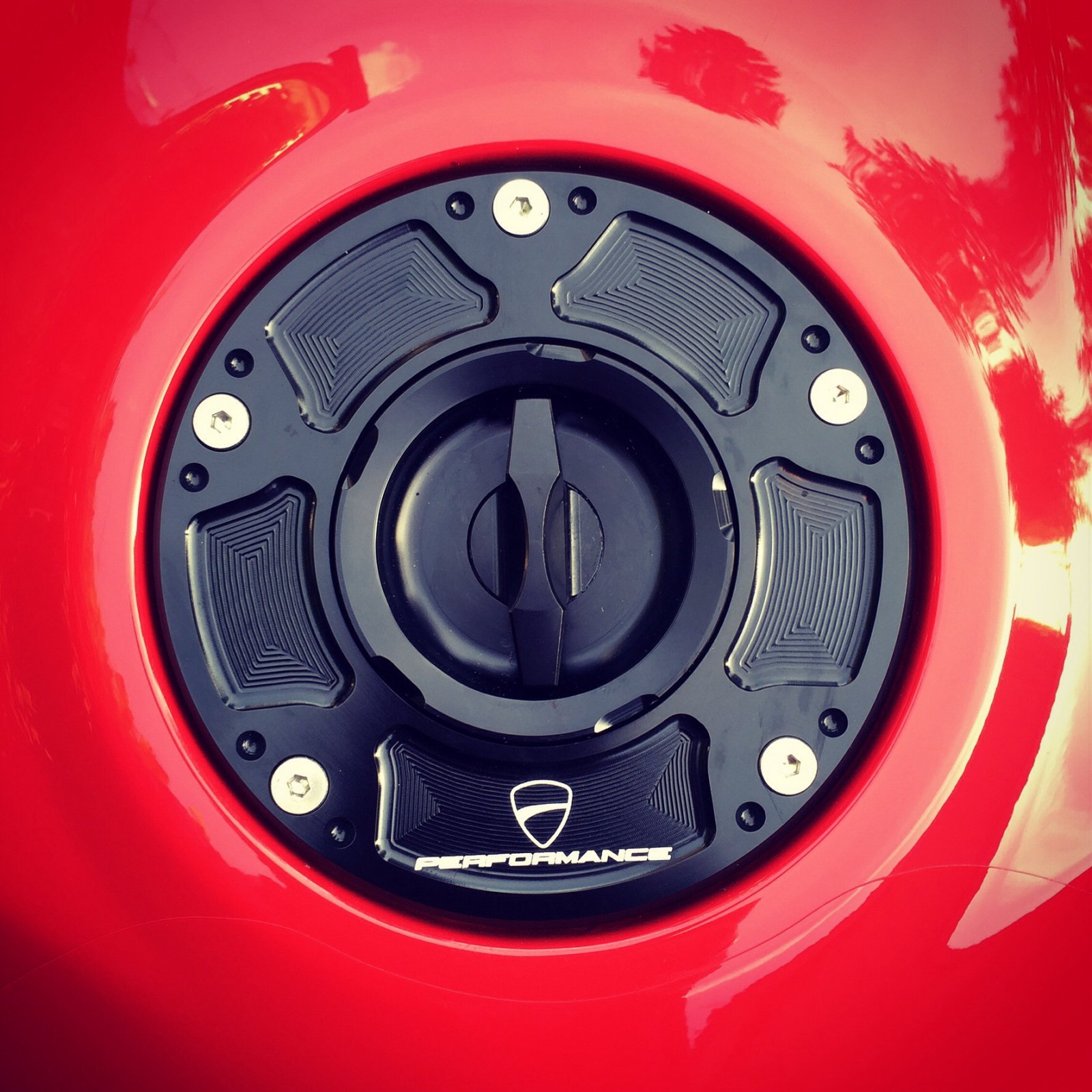

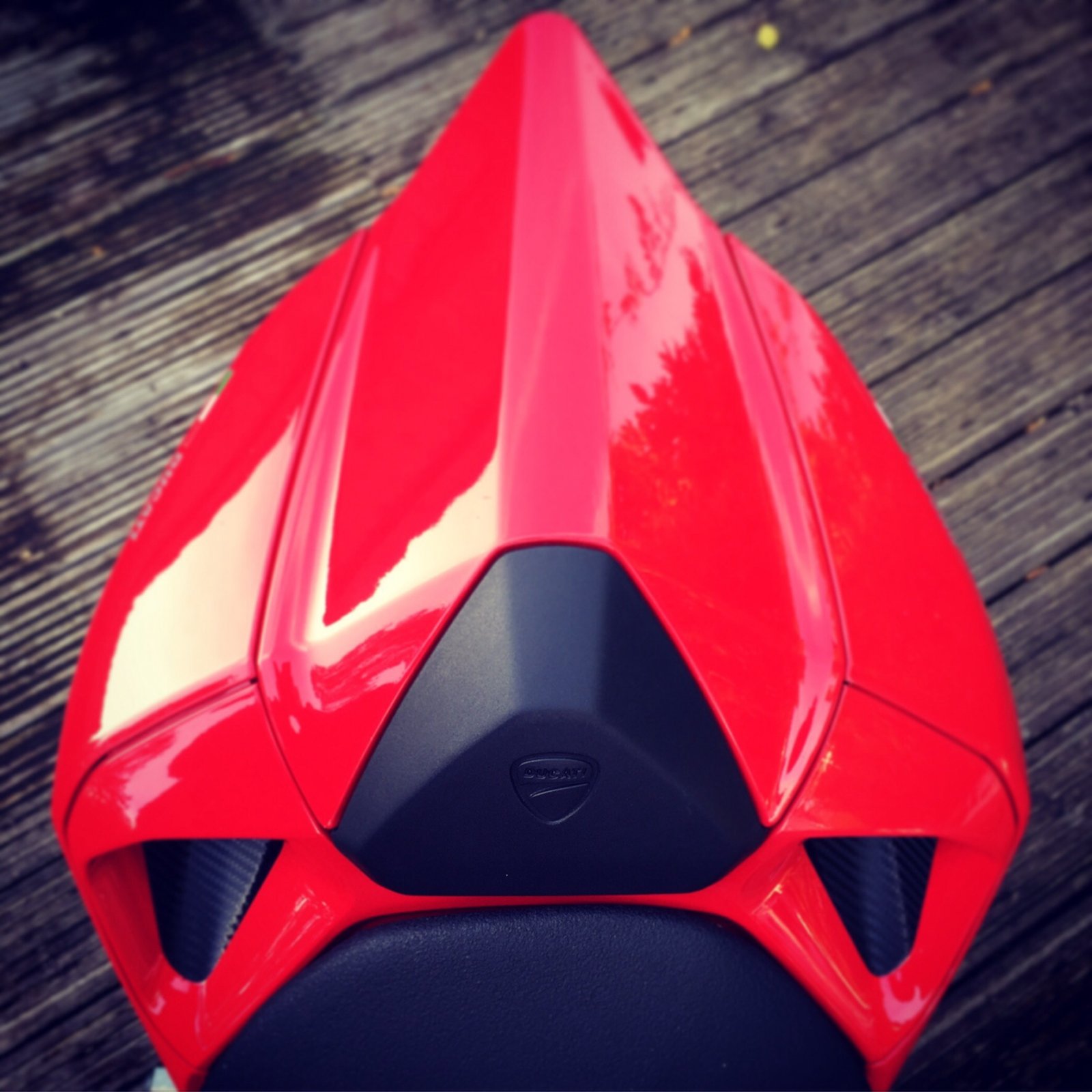

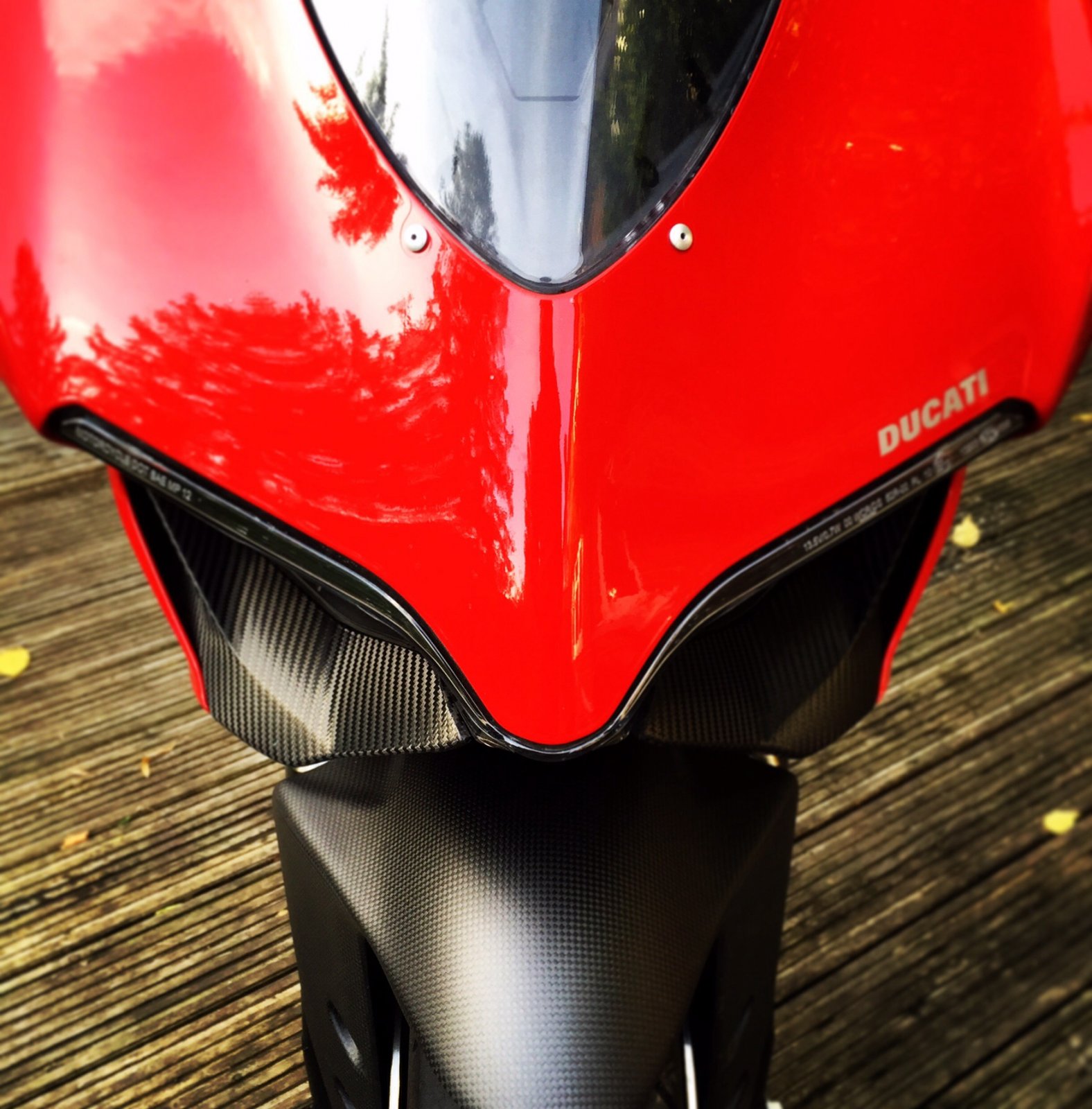

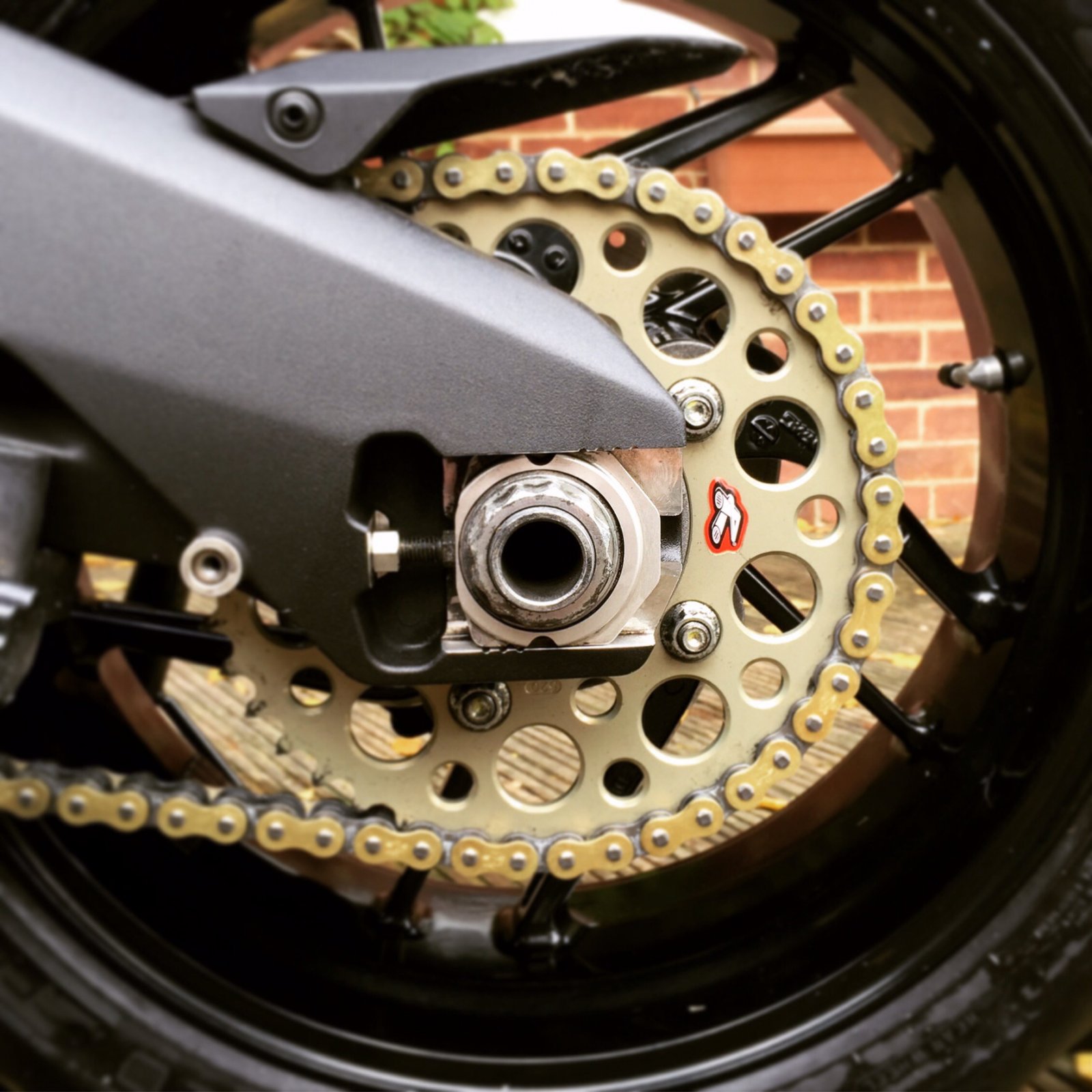

  18. image.jpg image.jpg image.jpg image.jpg image.jpg image.jpg image.jpg A selection of little things to my 899 over the last 12 months:
    DP comfort seat
    Termi's
    Seat cowl
    Corse stickers
    Full six front mud guard
    Full six rear hugger
    Full six exhaust shield
    Full six heal guards
    Full six shock cover
    Carbon wrap under the headlights
    Renthal chain and sprocket set
    DP fuel cap
  19. How frustrating that the weather is closing in. New Bike with a mere 19 miles on the clock, I cannot find it in myself to go get her minging. Putting 600 miles on the clock before Feb is going to be hard work, I need a roasting dry day to go bang a load of miles on.
