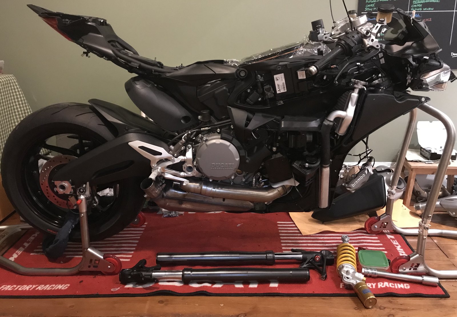

  1. Suspension off to see a specialist.....
  2. Pics or it didn’t happen. :innocent:
  3. I would say I'll do it this weekend but that wont happen cos of everything else going on.
  4. I’m just going to assume you ride this till then.
  5. You know the rules @El Toro, no photo's means it didn't happen!
    Edit to add: Bollock's, I was beaten to it... I still don't believe you though :p

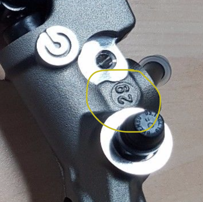

  7. Yes, the M50 caliper on the 1299 is a funny old beast. It has a different piston size to the M4’s, so the M/C is different. M50s use a 16mm piston radial Master Cylinder,
    M4's have a 19mm radial MC. You’ll get totally the wrong feel with the 899 M/C.
    NEVER EVER trust an eBay add that says something is for 899/1199/959/1299, because most sellers just don’t check.
  8. Where did you sent your suspension Ron? I’m going to get the nix cartridge kit and ttx shock from mot over the winter
  9. My feeling too but its Motorapido!!! How much would you want for the MC, I've been looking at RCS17's

  12. Look under the M/C there is a code there (from memory). Worth checking if it has already been changed before needlessly changing it.
  13. +18 5E18 Is what I can find laser etched
    In the casting on top is 15, underside 17 (as in picture) Think this might be what tooling was used during manufacture
