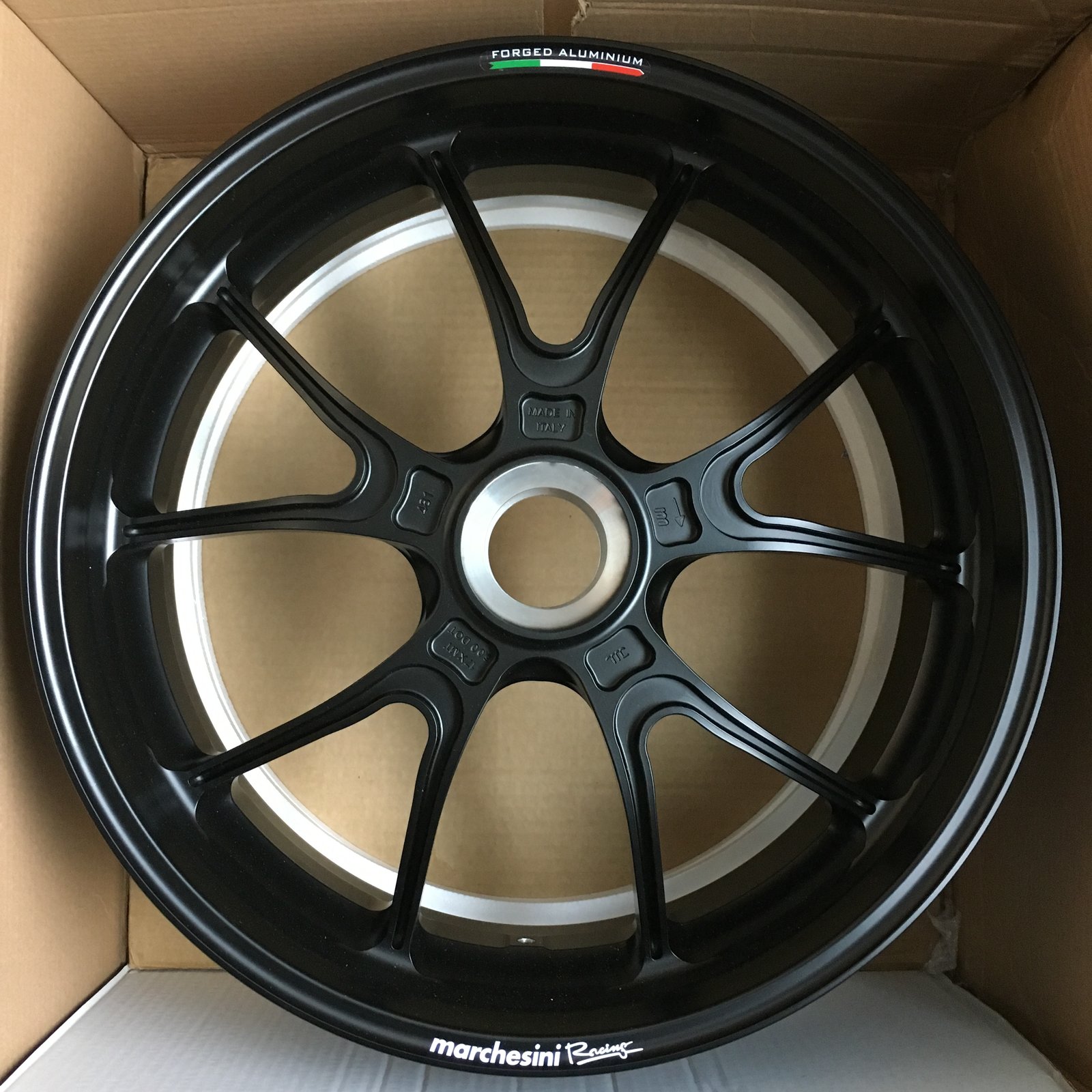

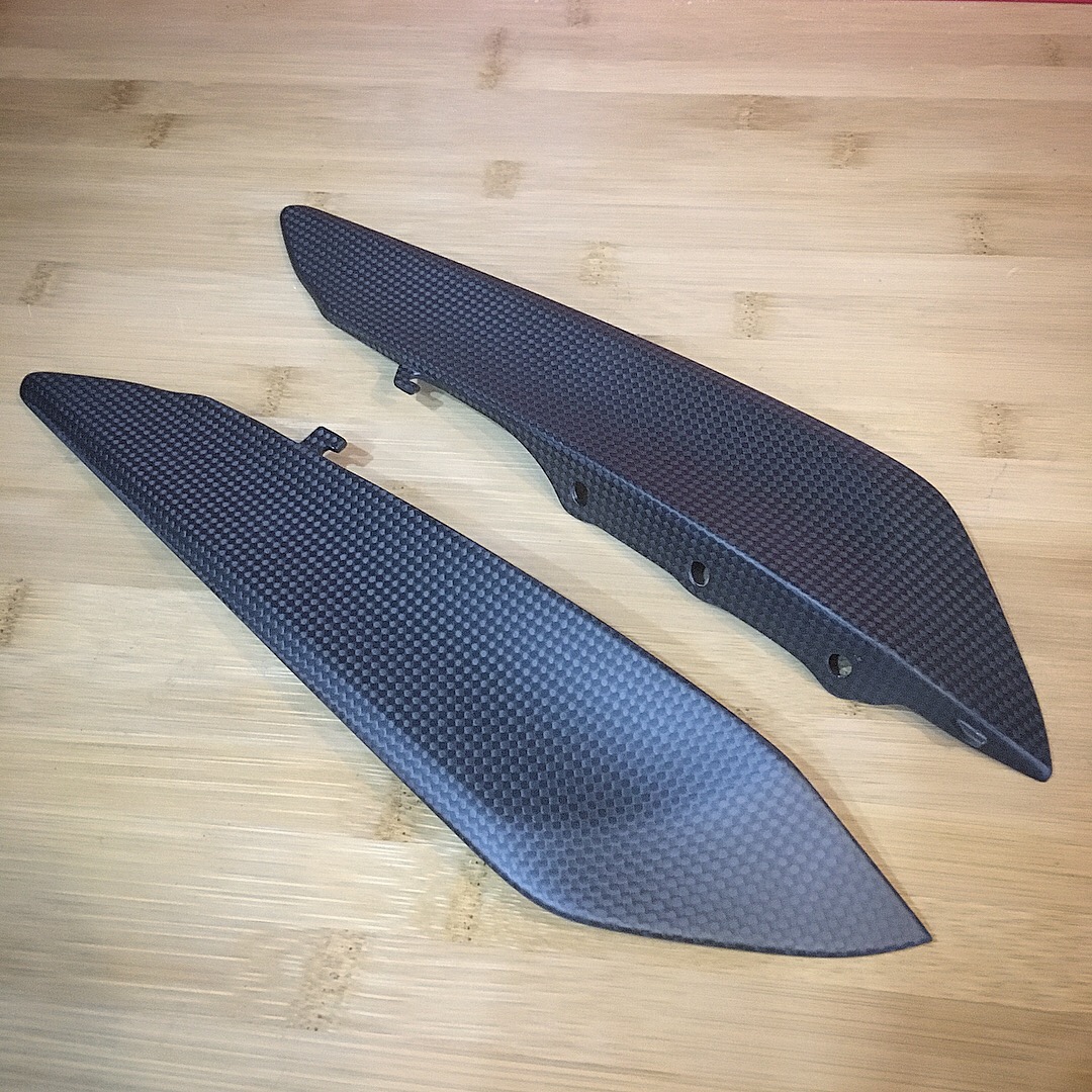

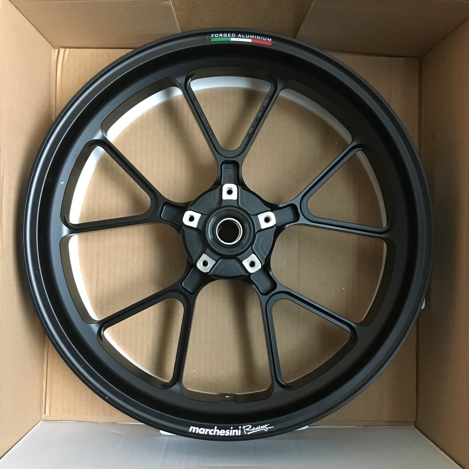

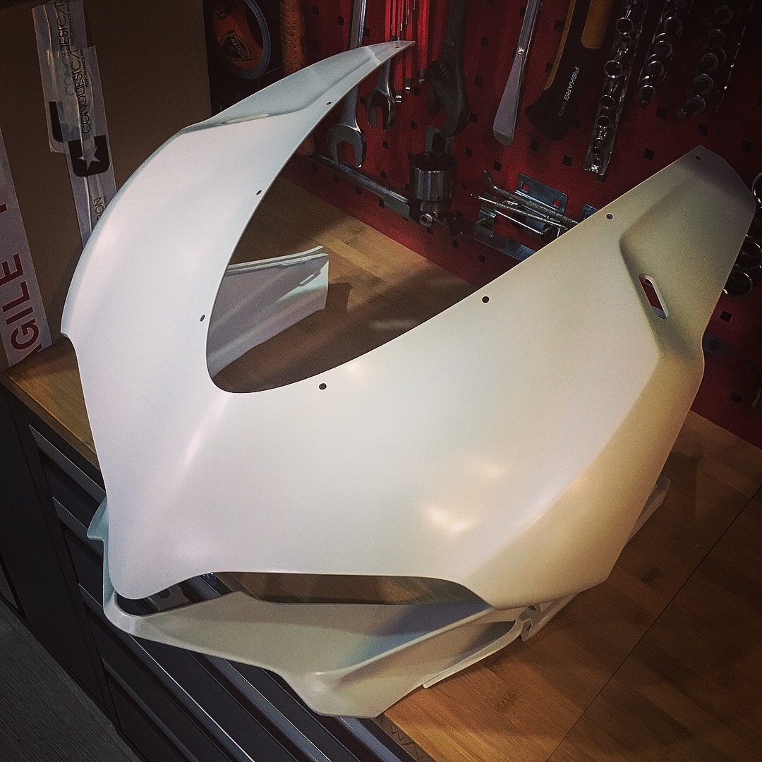

  13. Been collecting parts for my Final Edition.
    Got a spare set of fairings and carbon rear cowl to get sprayed up to get red of the FE paint scheme...
    B1D17CEE-8EB6-4718-B80D-583ED27477E9.jpeg 1BB20794-0FA5-4ABD-9C20-BDA603E3D7A4.jpeg
    Wheels arrived today so need to get them fitted.
    And this is what she should look like, in homage to the fact it’s an R it will be red, but the rear cowls will be left with Carbon edges like the SL in the fact it has the SL motor.
  14. Thats well smart Jim. Those rims are absolutely stunning :upyeah:
  15. Thank you
    Many an hour was spent deliberating!

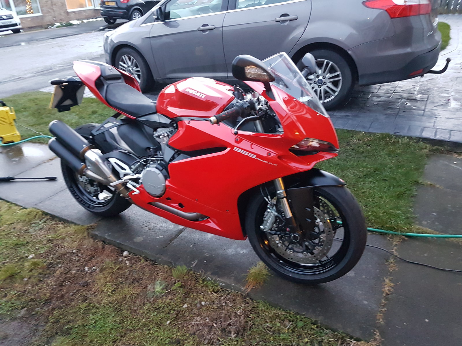

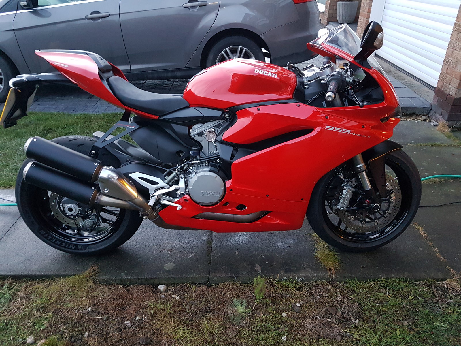

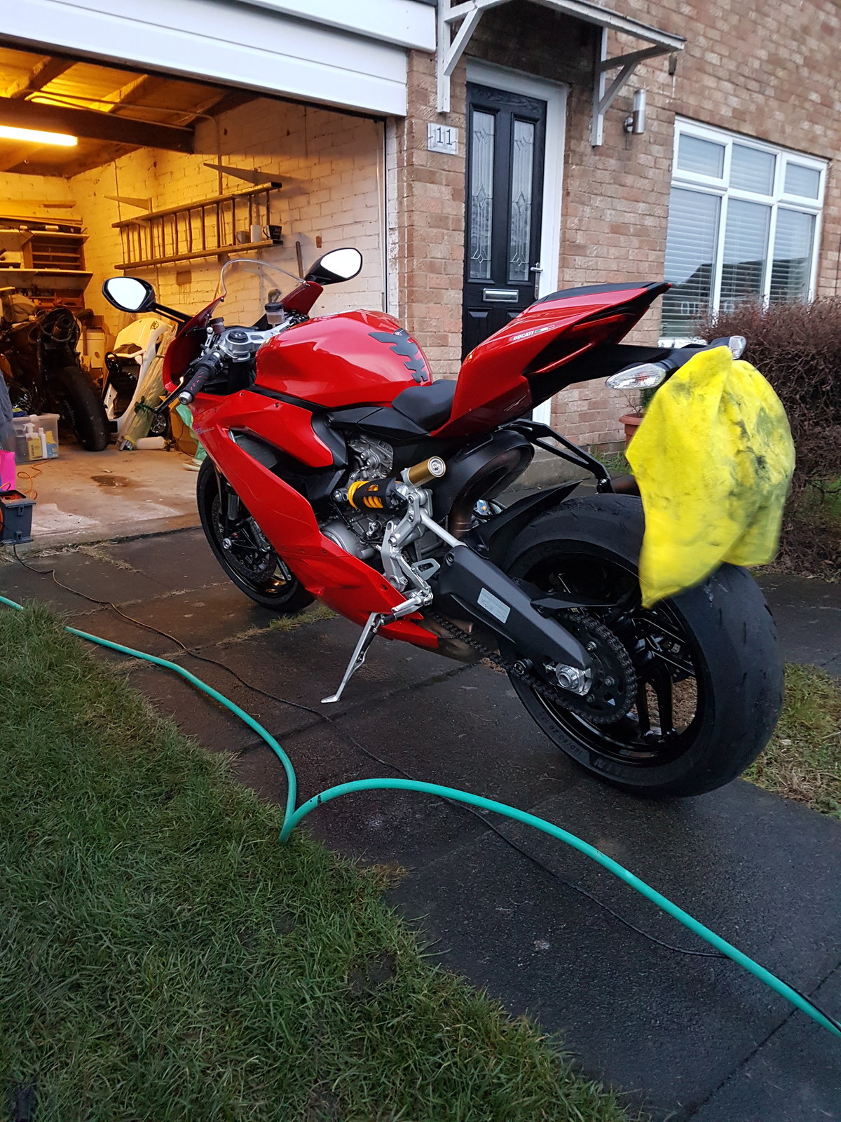

  16. Gave the 959 a well needed clean and polish.
    • Like Like x 7

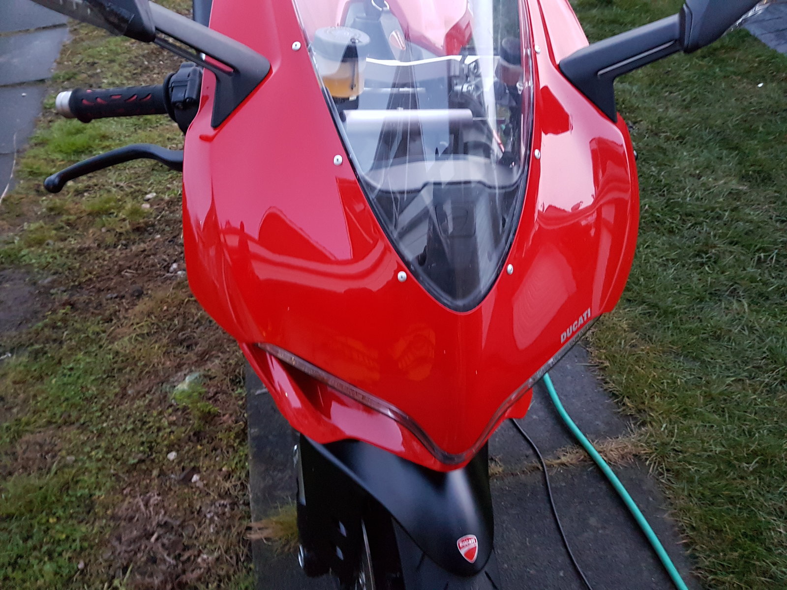

  17. Some minor protection without looking too hideous. :)
    #997 ResB1299, Dec 30, 2017
  18. Chemical guys v34 for scratch removal and carbon collective ceramic detailer. My mate gave me a hand as he's in to all that stuff.

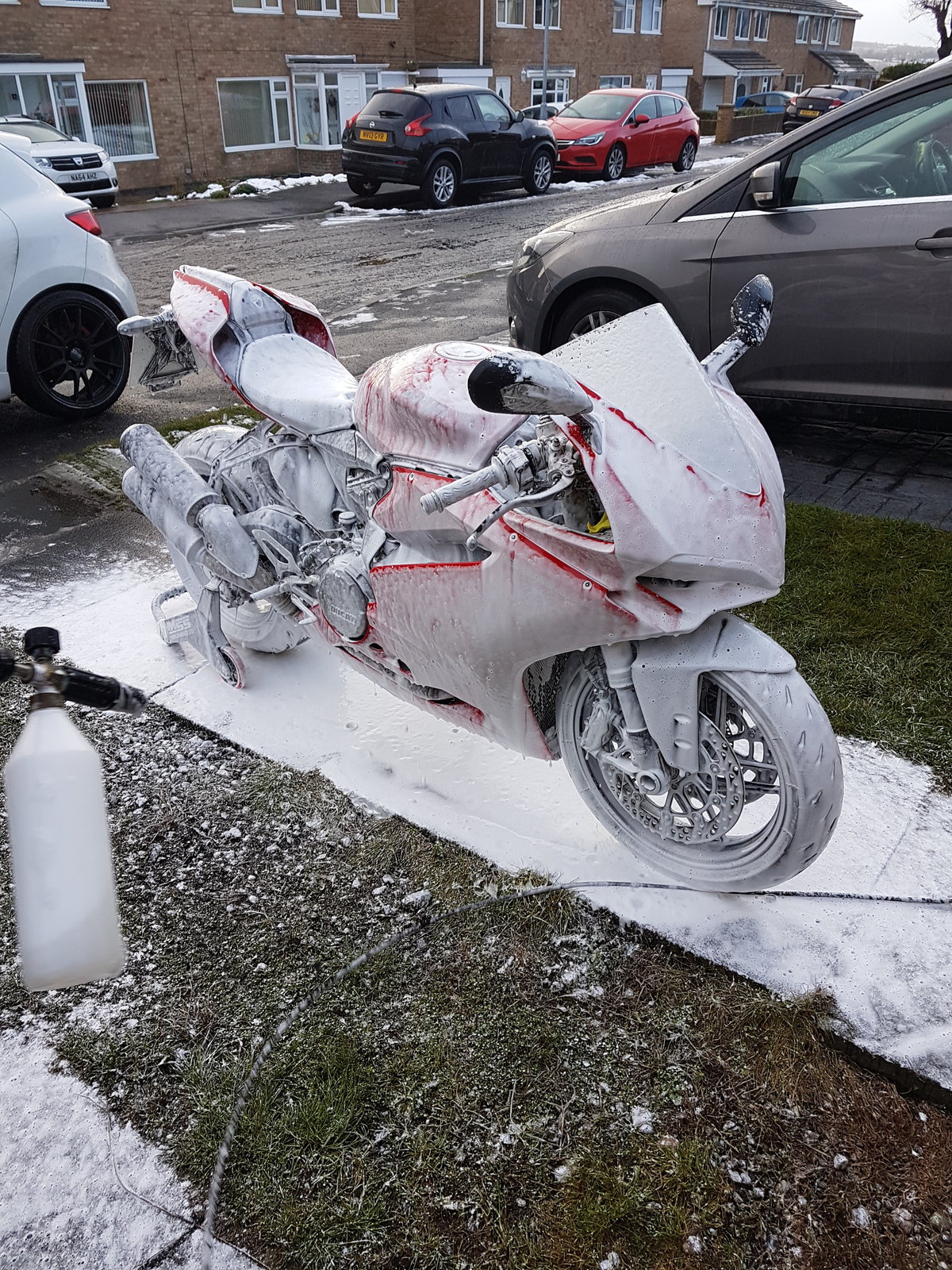

    The car gets a snow foam I never usually do the bike I normally soak it in muc off then after 5 mins rinse it off and wash with soapy water and a mit. I tend to use that muc off speed polish which is easy to use and over the winter take the fairing off and do it properly
