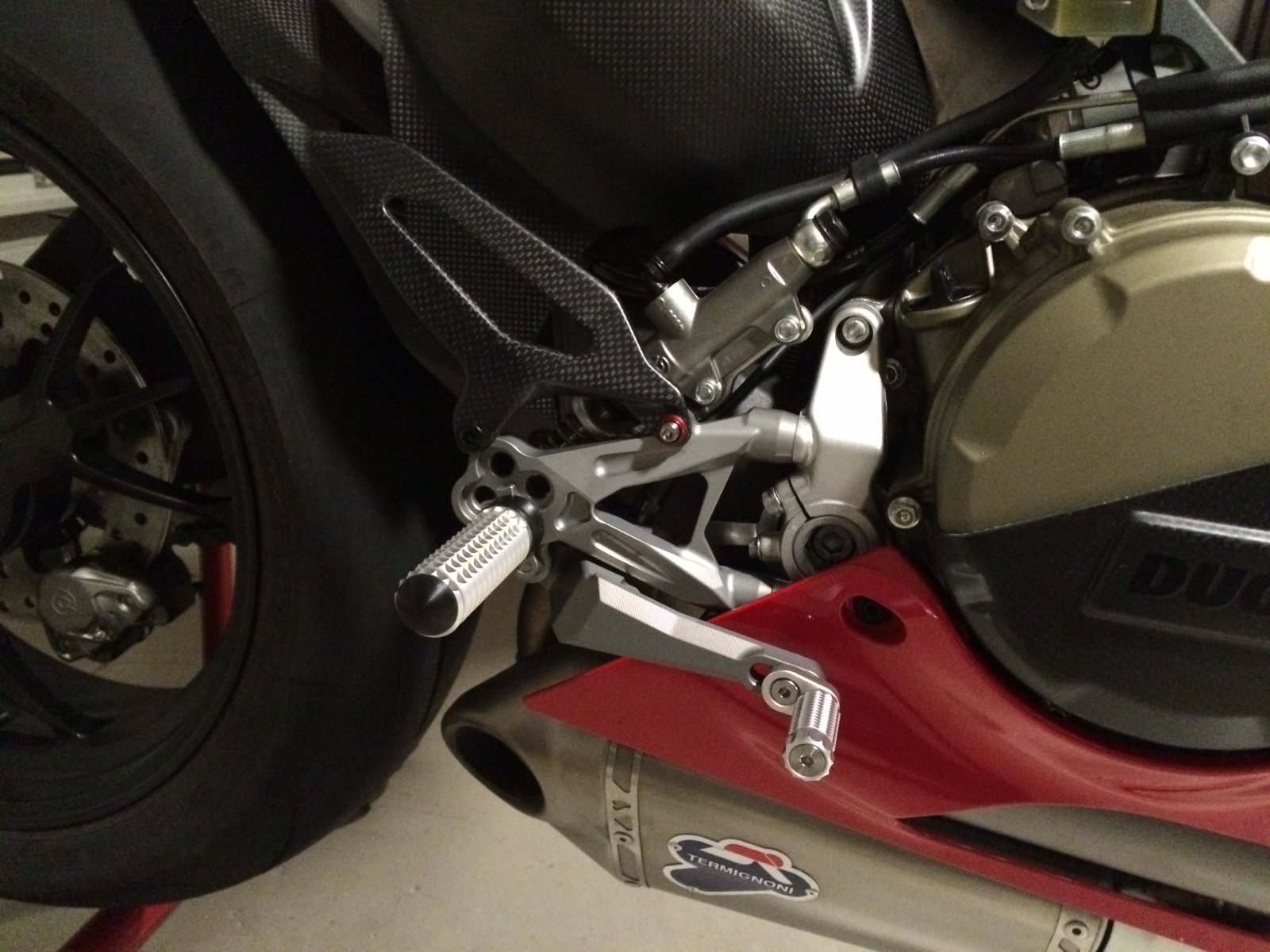

  1. I see you've gone for solid non-folding footrests, any particular reason?
    Just wondering...

  3. A bit of added crash protection......I've also got so GB Racing engine covers on the way....

  5. Ok but just FYI I was advised the reason the DP rearsets are folding is because the rearsets bolt to the frame radially. In a crash the solid footrest transmits force to those radial lugs on the frame and could bend them. Unlike most other bikes which seem to have non-radial bolts to secure the rearsets. Don't know how true the above is but from an engineering view it looks like it might make sense?

  6. Personally the only cash protection I'd buy, having decked my bike, is Woodcraft. It's billet and on the clutch side, equipped with a replaceable billet slider (in a choice of colours!). Costs about £100. On the clutch, I have seen GB Racing covers worn through (A Focused Events hire bike) & personally seen my own Ducati "Performance" protector simply ripped off as the bike slide down Craners at Donington.

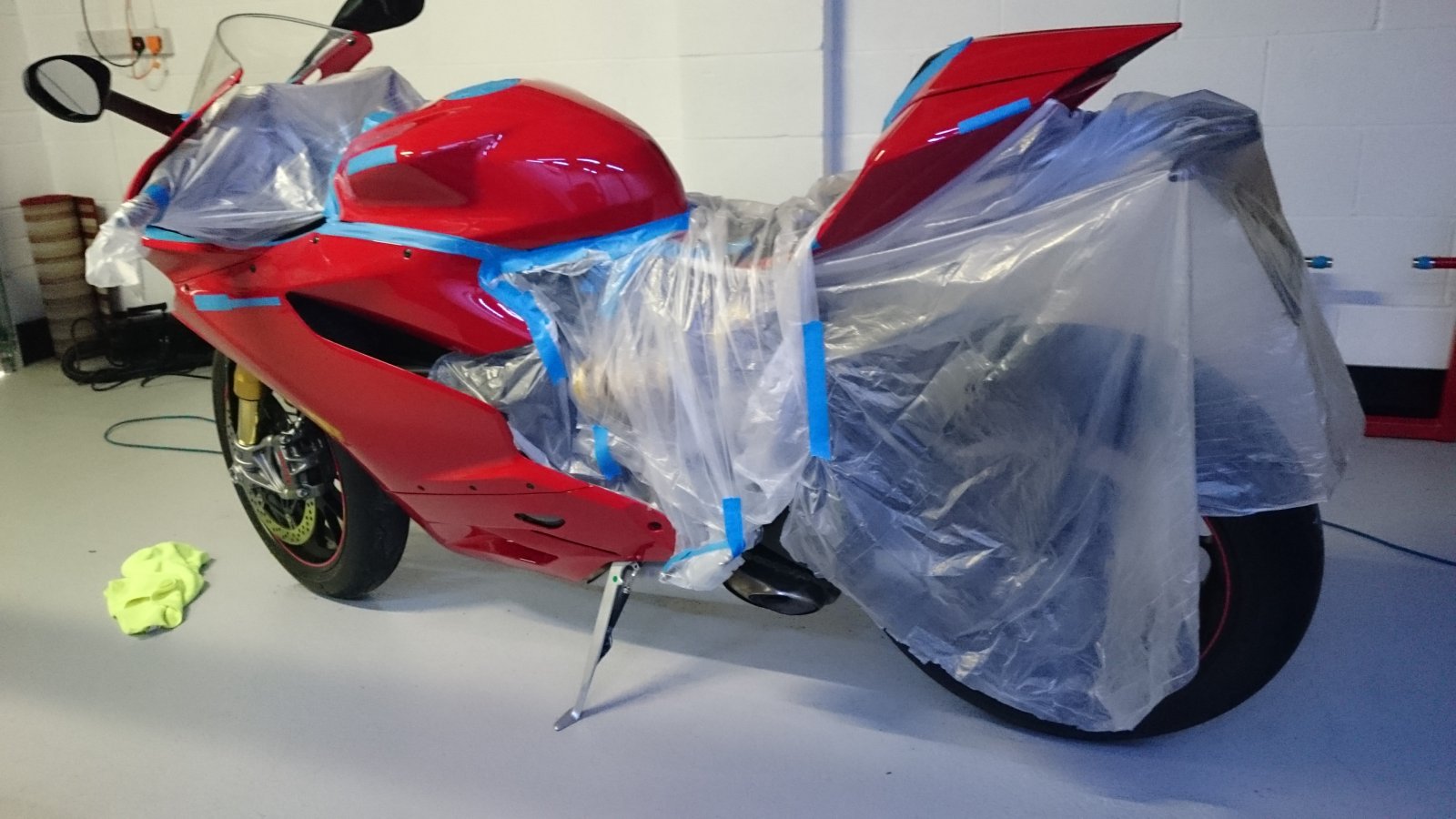

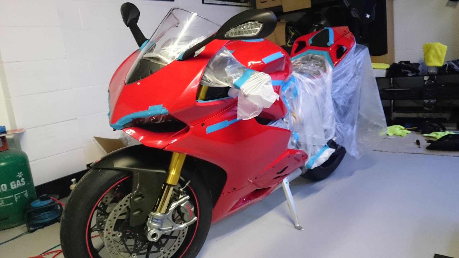

  8. What did you polish it with? I've found the paint swirls if you so much as look at it the wrong way?
  9. Randomly, I made best progress with a DA, green 3m compounding pad and meguiars 105. Tried the flex rotary with various pads and polishes and it just wasn't working. I was happy with a couple of passes with that before wiping down with eraser and checking it.
  10. Thanks. I didn't have the nerve to do mine properly since the paint / plastic appeared so soft. I did an ok job on the car a couple of times (borrowing someone's Rupes something or other) but wasn't brave enough for the bike. I eventually put Ventureshield on mine after 4000 miles or so. I wish I'd done it at the start since the cleaning process / polishing (taking it really easily just to remove the lightest of swirls etc) took an age and the odd stone chip etc showed up badly under the film.

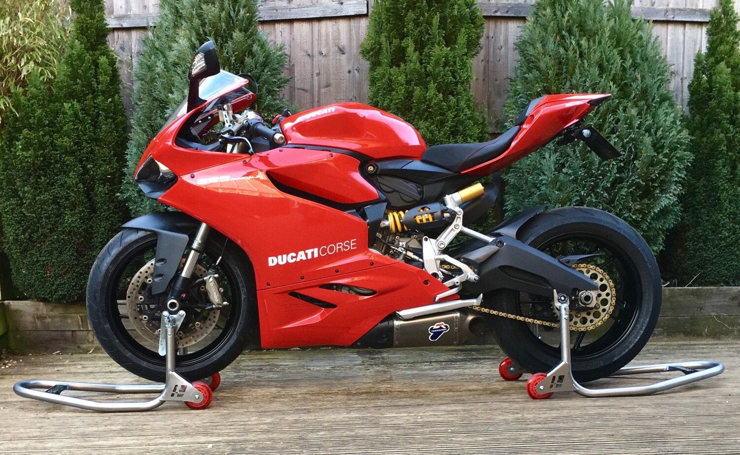

  11. New Harris paddock stands are my latest addition.

  14. How much room is there under the rear wheel?
  15. image.jpg On a flat surface it sits much higher.
    As you can see here, the wheels of the rear stand are sat in the gaps of the decking so it dropped about 15mm.

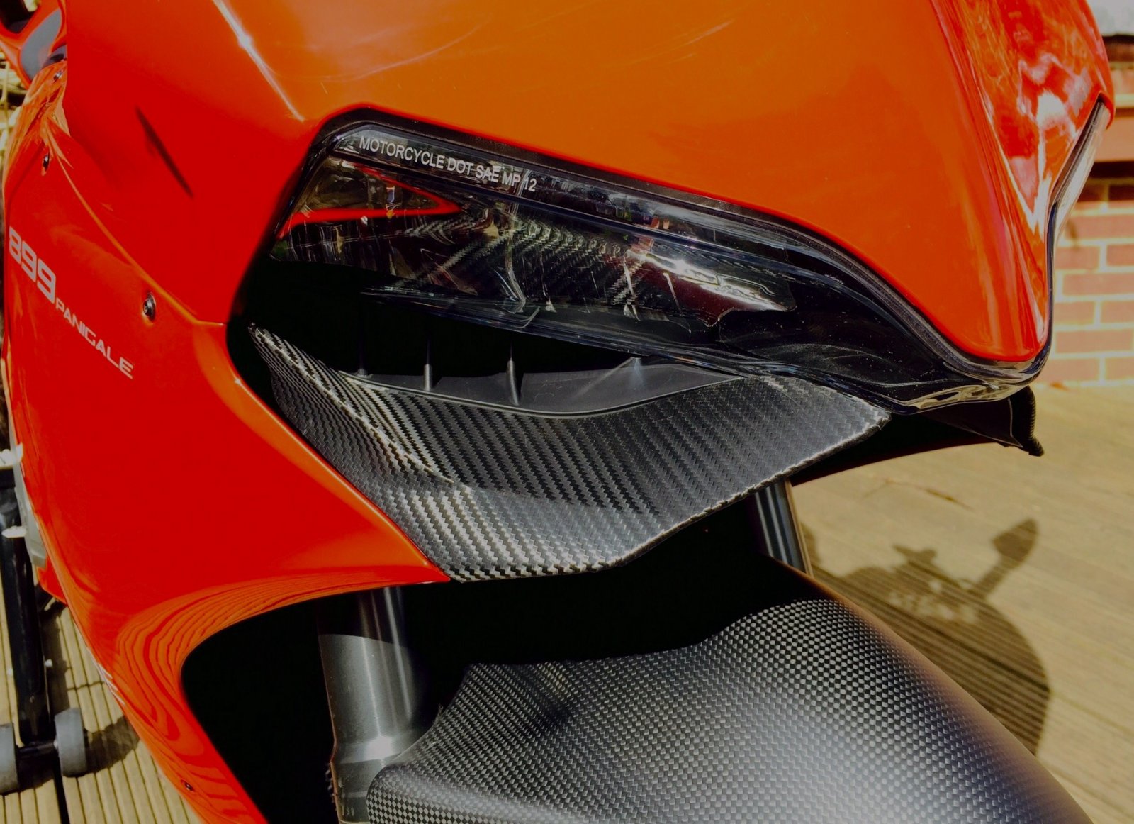

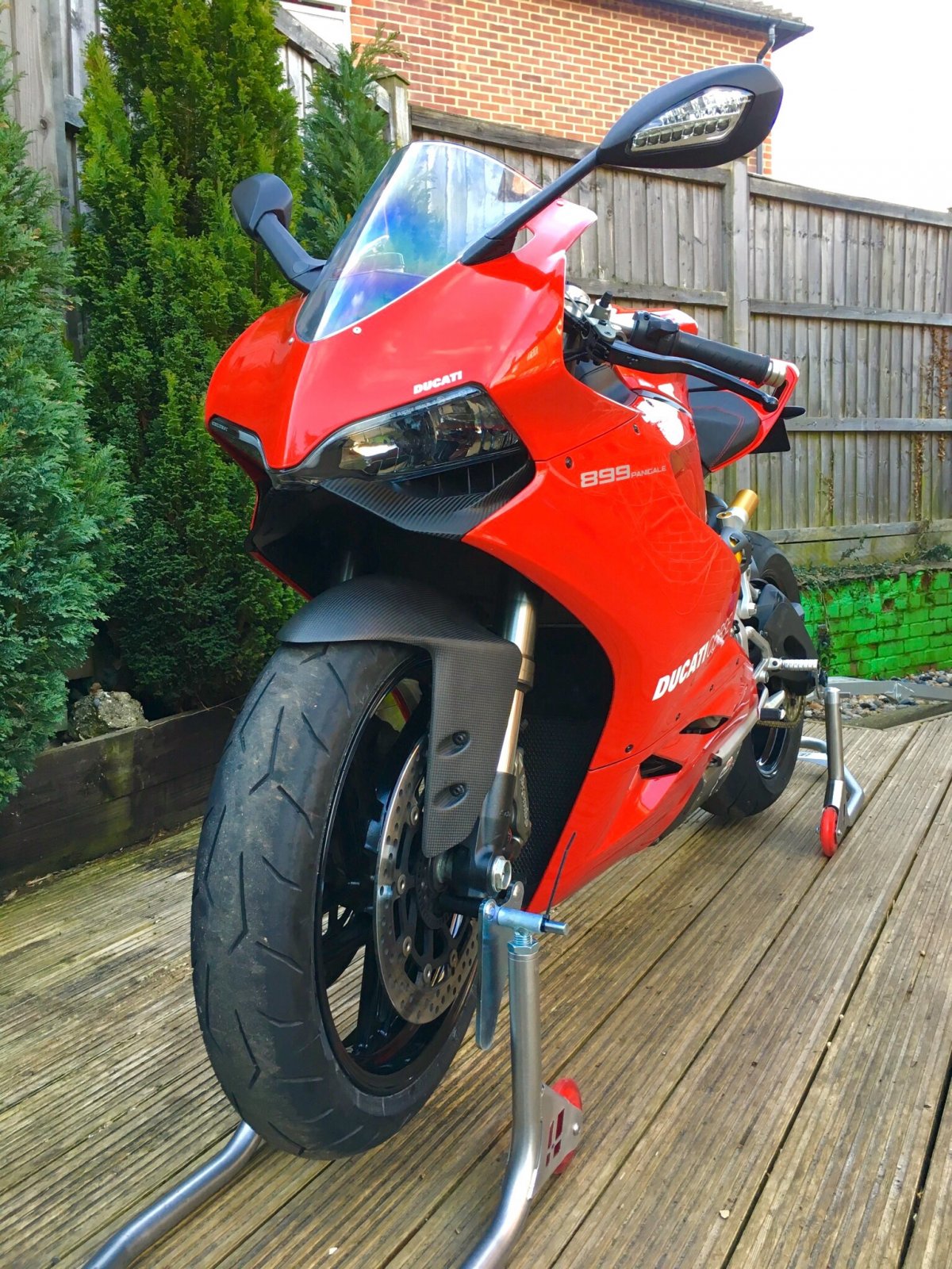

  16. Quite like the carbon under the lights... where you get that from? Also what chain have you put on?
  17. Thanks, it's a carbon wrap I put under the lights.
    Full spec is:
    Renthal chain
    Renthal sprocket
    DP fuel cap
    DP comfort seat
    DP seal cowl
    DP tank protector
    Termi's
    Carbon front mud guard
    Carbon heel guards
    Carbon upper exhaust guard
    Carbon lower exhaust guards
    Carbon rear hugger
    Carbon shock cover
    Carbon chain guard
    Evotech tail tidy
    Evotech rear bobbins
    Evotech lower rad cover
    Ducabike pegs
    1199 rear indicators
    Venture shield
    Lithium battery

  19. I have the Harris stands and there isn't much room at all under the tyre.
    Doubt you would get warmers on there and tyre changes would be a bit more awkward.
