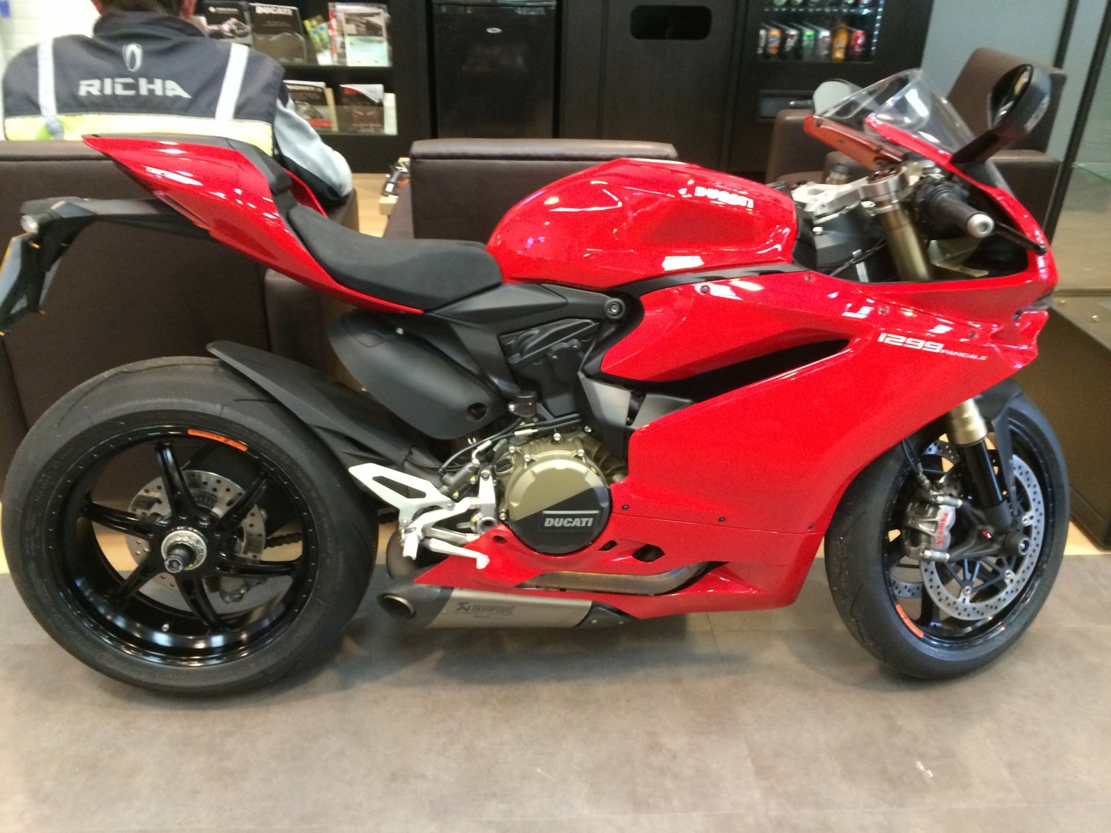

  9. Just had some OZ GASS wheels installed on my base 1299. Biblical rain on the ride home, but noticed the difference immediately. Really makes the base model more flickable and that was just weaving through traffic on the motorway. Not had a chance for a full test on the twisties.
    When I pick the stock wheels up from the dealer I'll weigh them and post up weight savings.
    I've also got the race seat, carbon front mudguard.
    Ducati Performance tail tidy to fit.

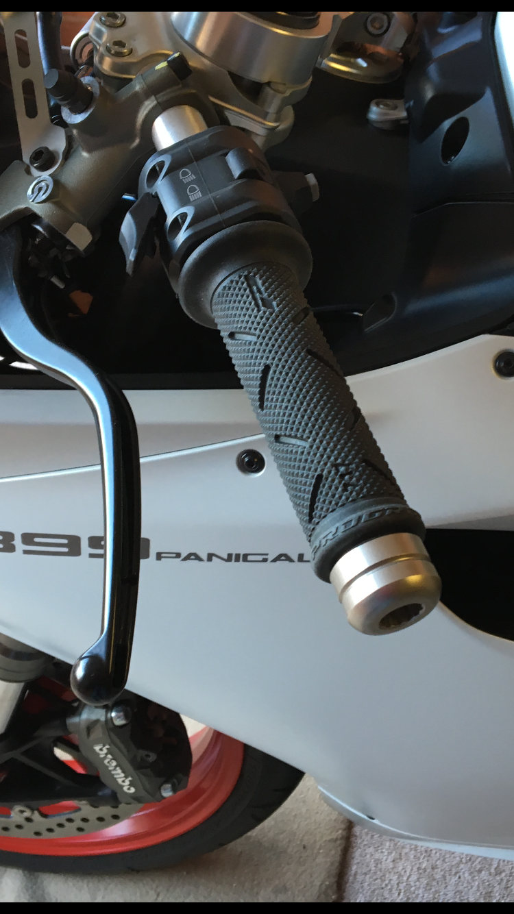

  10. image.png Jumped on the Progrip bandwagon today. Any easy swap and a great value mod :upyeah:
  11. Got some of these to fit - any tips or is it really straightforward!?
  12. 12mm Allen key for the bar ends. Get a knitting needing or similar in between the grip and bar and spray wd40 in and the grip will come off with a little twisting. Clean the wd40 off, spray hairspray in the new grip and on the bar and slide new grip on.
    I'm not technically minded mate and found it really easy :)
  13. its cause its soft crap!
  14. Brake cleaner works better as it will dissolve without having to clean it off.
  15. Yes but the hairspray once dry also acts as an adhesive.
  16. Should have clarified. Brake cleaner to get the old ones off. On some bikes the brake cleaner alone has been OK to get the new grips on and once evaporated they have held ok, but most times I put new grips on with hairspray.

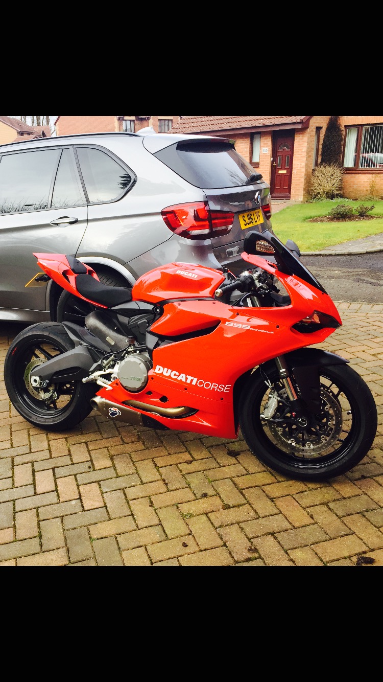

  17. Here's my 2014 899.
    Mra screen
    Venturesheild
    Race seat
    DP levers
    Led mini indicators
    Evotech tail tidy (5x7 plate)
    Evotech bobbins
    Evotech lower + upper rad guards
    DP carbon front mud guard
    DP carbon rear hugger
    DP carbon heel guards
    DP carbon front + rear chain guards
    DP carbon key surround + air ducts
    DP carbon shock cover
    DP carbon carbon exhaut covers
    Carbon reservoir brackets
    Carbon seat vents
    Carbon fairing triangle
    Carbon fuse + abs cover
    Ilmberger exhaust heatsheild
    Termi,s + upmap
    Ohlins ttx shock
    Blip box
    Progrip 717,s
    Renthal rear sprocket with titianum nuts and rear axle nut
    Philips uprated headlight bulbs
    Ducati corse fairing stickers
    • Like Like x 7
  18. Did you get work done in woods?

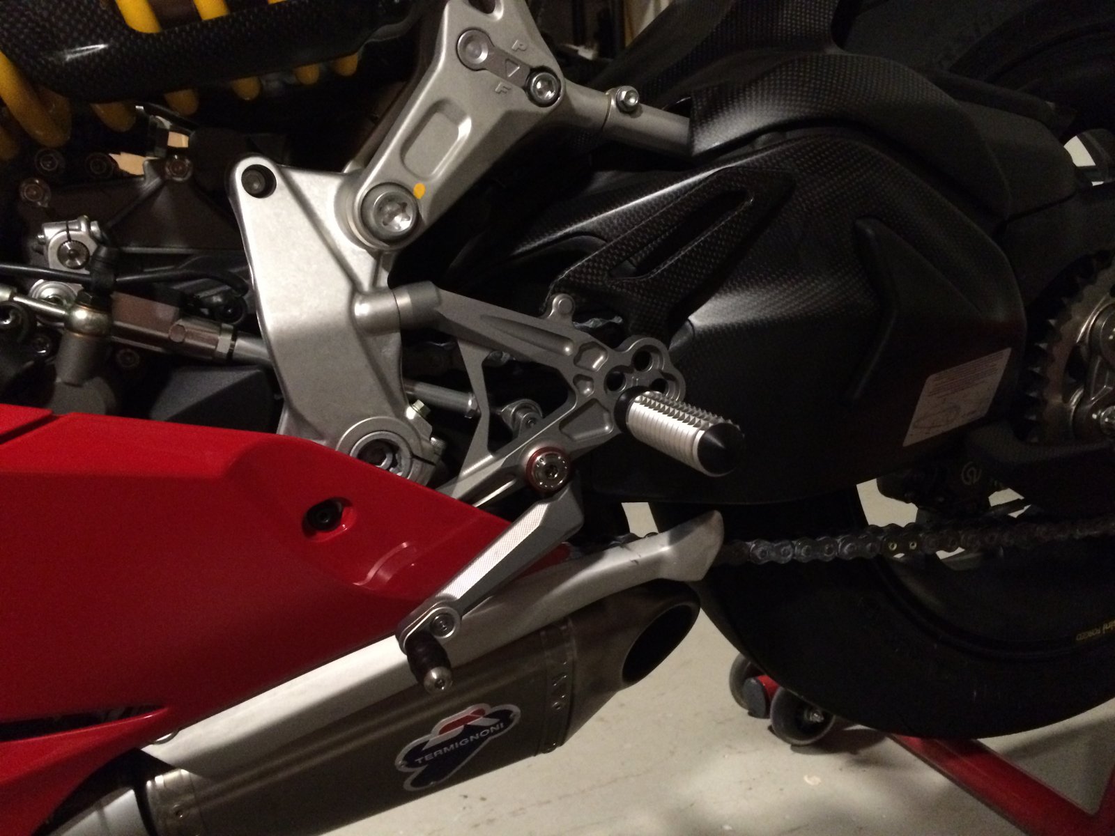

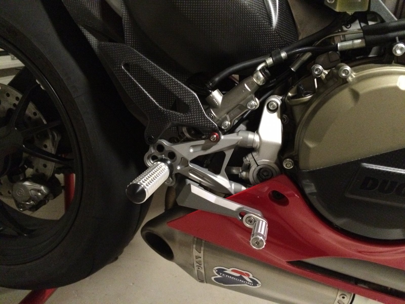

  19. I've got a set of giamoto rearsets on my Panigale. How did you manage to fit the carbon heel guards? The ones that come with them seem to be fixed on and only have one mounting point.
  20. what make are those bar ends?
    bike looks cracking btw :handok:
