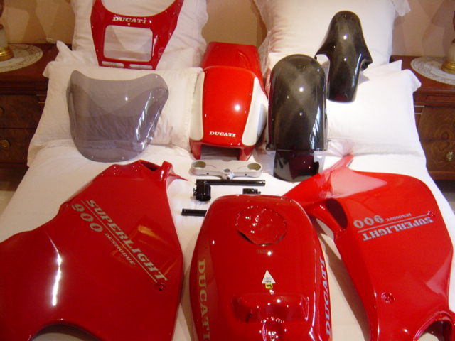

    I see you also have the genuine ducati performance clock cover not the rubbish fibrelyte thing that people used to do and a corbin seat.

    Did you have the bodywork and frame repainted?

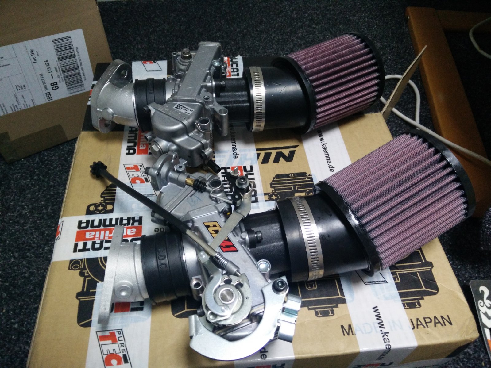

  10. These arrived yesterday.

  13. Apparently the guys at cycleworks supply the FCRs with the correct jetting all ready to go. The flooding stories I think come from the fact that there is no choke so you have to pupmp them a bit before starting from cold. However, I've also heard that some people simply turn the idle adjuster up for a minute or so.
  14. True, jets are ready to go but with other mods these will need doing. ( airbox and Sils will make big difference) the
    Carbs do not flood cause of pumping when cold. They flooded on mine when the bike was in the garage overnight. Got hydraulic lock as the engine was full of fuel.
