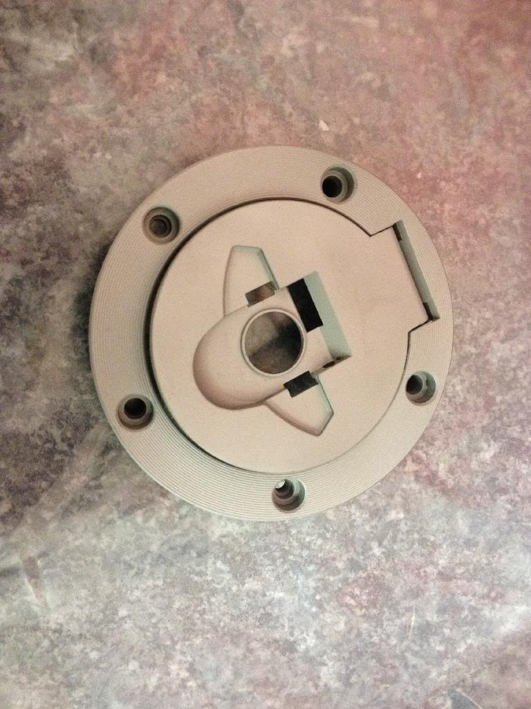

  2. Hi, yes I transferred the lock over, just take pictures as you strip it down, it's really simple. I paid about £35 for it but it took me a while to find a good one. I have another freshly sandblasted if you want it. It needs a coat of something like acid 8 etch primer before paint. Hamerite smooth gold is apparently a perfect match and the you will need aluminium silver for the outer ring. Let me know if interested.

  5. Thanks for the tip about the smooth Hamerite and the offer of the fuel cap. I will have a go at refurb ing mine as it is one of the earlier ones with the Cagiva logo which I quite like.

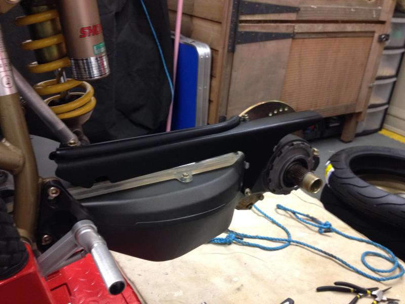

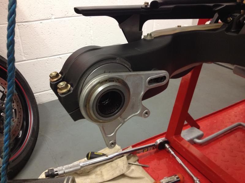

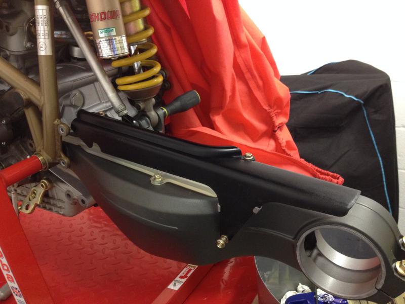

  7. Well it's almost winter so the duke is stripped down again. I painted the swingarm today and pretty chuffed with how it turned out. 2 coats of etch primer, 2 coats of base and 2 coats of Matte lacquer. The paint is from Bike Colours and is a really good match to the original.

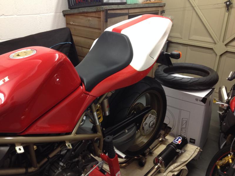

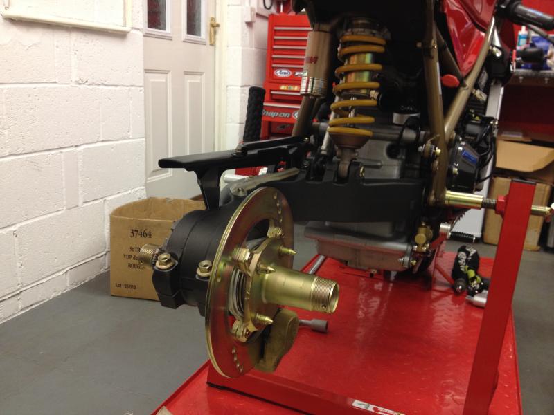

  11. Well not too much to update on apart from slowly building the swingarm back up with new or cleaned parts. My biggest dillema now is whether to have the whole bike red as is it should be or a bit of a SP look alike with a carbon mudguard, solid red nosecone and the SP tail with numberboards. Decisions decisions....

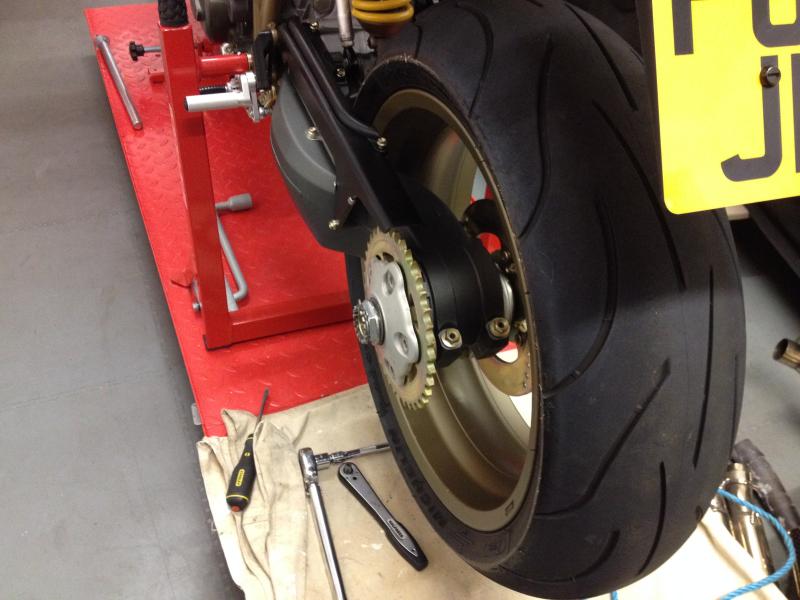

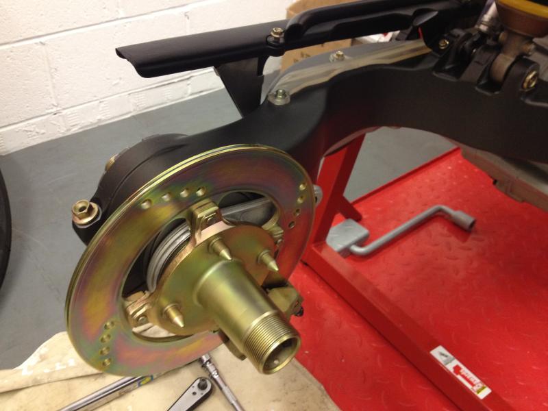

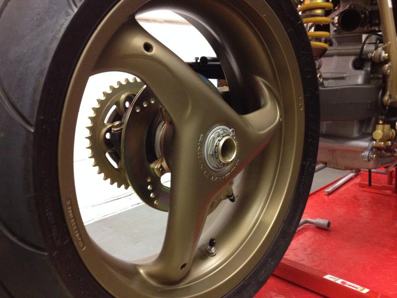

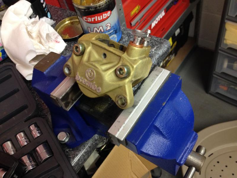

  19. I've been doing a bit more on the 916. All the bits came back from the platers so started to build the back end up.

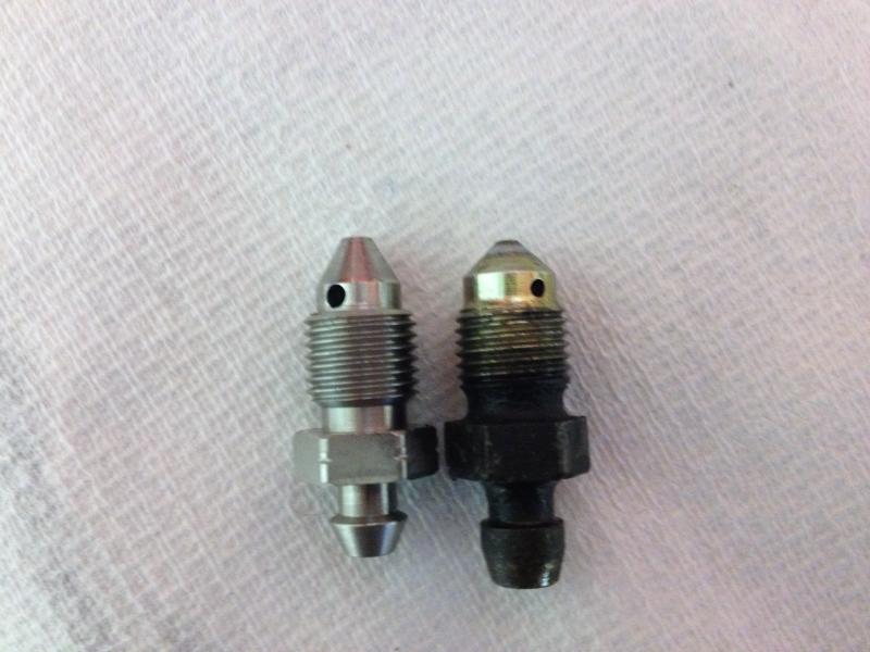

    Where can I get 916 bleed nipples from? I bought some M8 Nips from the bike show thinking they would fit but i don't think they will seal. The chamfer is too steep.
