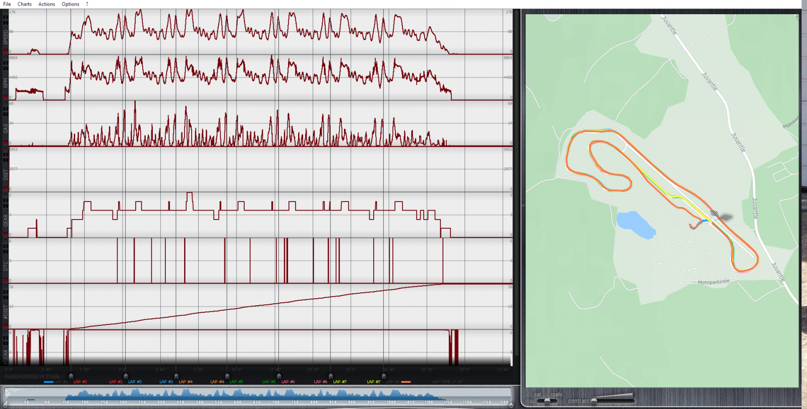

    @arnoldpraesent : your DDA has been programmed using the 1199 acquisition table (the configuration where is told what channel read from the bike) without the GPS option, this is the reason why you weren't able to see any GPS data on your acquisition. You should be able to change the Acquisition table of your DDA by using this tool (available only for windows)
    http://area.riservata.it/SetupDDAFlashUpgrade-4.13a.exe
    and choosing the option “Features GPS” .
    Once you flashed the DDA with the right acquisition table, you should be able to see the GPS channels.

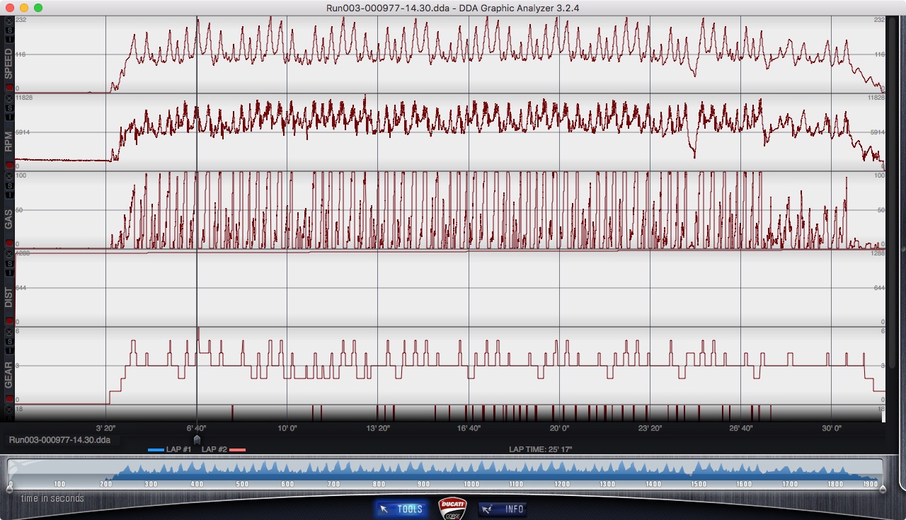

  4. Last screen before graphic analyser. Is there tap, lap after lap or all laps in one?
  5. Thank you. That's a valuable comment. I will try it asap, I have to find a vm ware for my Mac. Maybe if the gps data a readable the map will be usable as well.
    What do you think about the issue that the whole turn is on lap. No separation of individual laps? Any idea?
  6. All in one. It shows just one lap with the length of the turn, 28 min and some seconds.

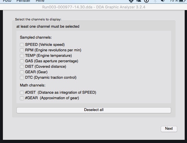

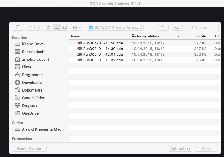

  9. Hi enclose some screen shots.
    dda1 - open file, dda2 - select channels, dda3 - available laps, dda4 - 2 laps for a whole turn.
    what i have seen is, that there are two laps, i think this is because i have set a new finish line with the flash ... so maybe its realy about not getting any gps signal for the data recording... this would also explain why the map cant be unfolded from the side. ... i will let you know whats the outcome - i have also written an email to prosa. maybe they can advice what to do and how to get out most of the dda+ system.

    I think the 'one lap' issue is because the DDA has been programmed without the GPS option as mentioned.
