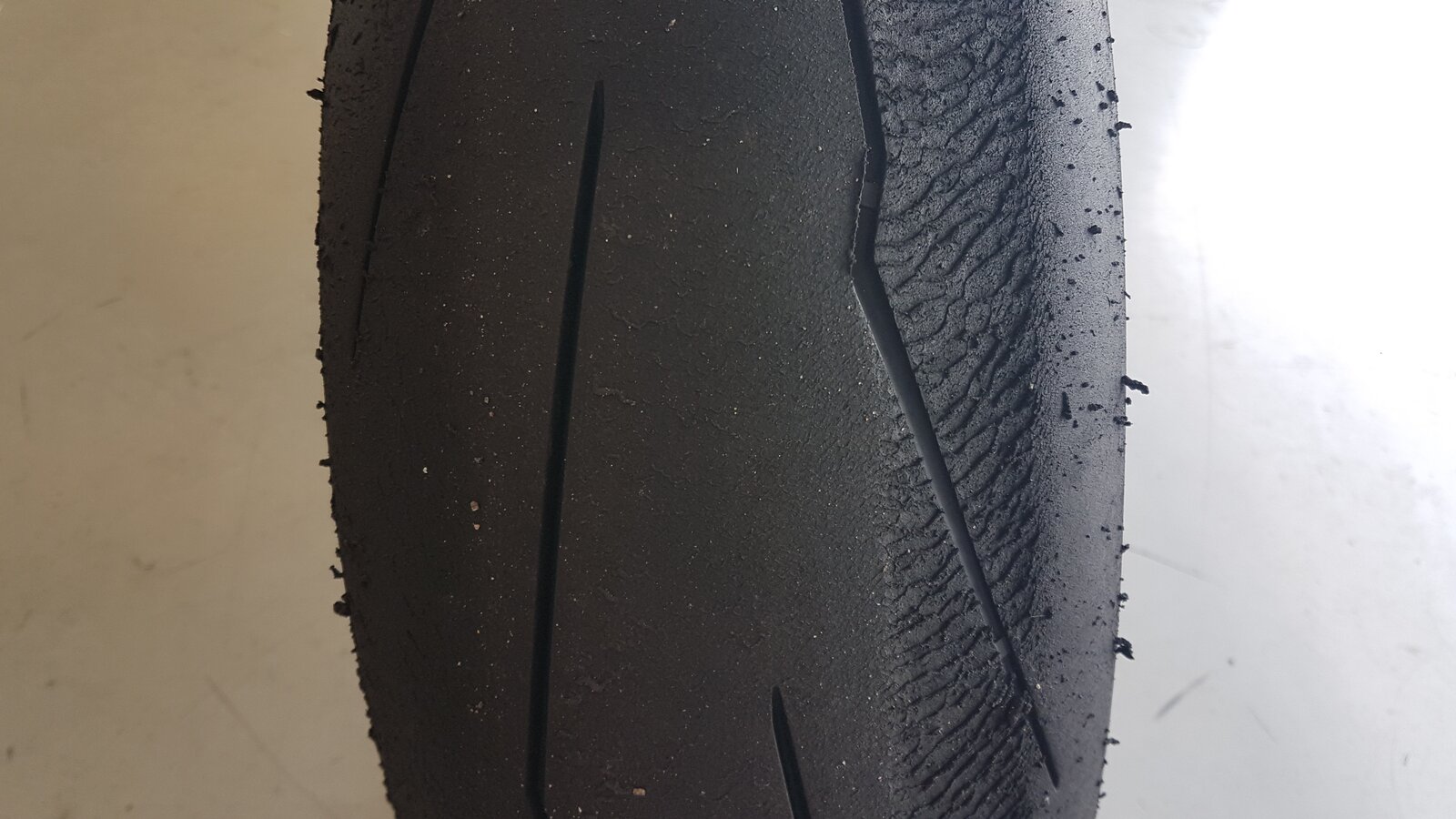

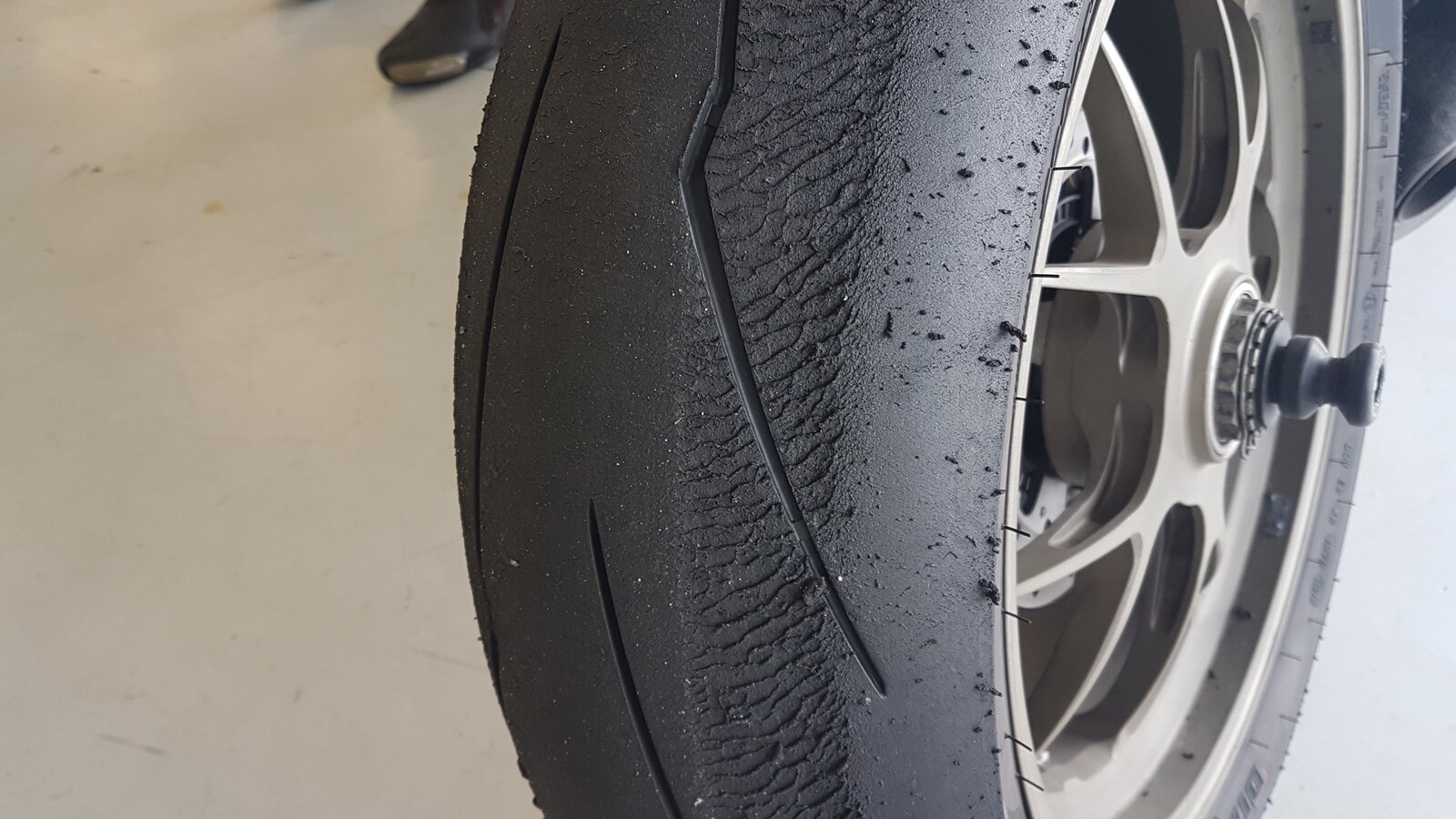

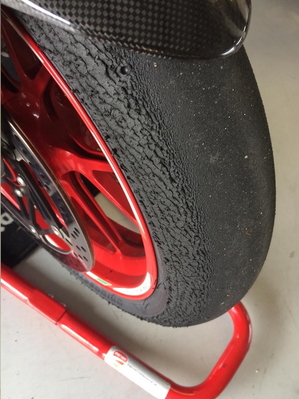

    The circuit, yes very sticky , to much i rekon - this was a new V02 medium after the second fast session, both sides where liek this, rear started like this, but cleaned up .
    Pressures were as FWR stated F35H, R25H and suspenson settings didnt help clean this up, but maybe it was to far gone before the adjustments where made .
    I can see MOTOGP having issues with tyres on this new surface ..

  13. Blimey that’s going to get expensive! Have you checked your tyre warmer temperatures? (Using a heat gun or thermometer) The V02s need to be set to their actual track running temperature. From experience they run around 70->75 rear and 60>65 front hot. Most tyre warmers heat to around 80 (sometimes nearer 90!) degrees minimum which is too high to set the pressures from. This then causes massive hot tear for the first couple of laps in a session, then as they cool they’re then under inflated which tears them up even more.
    I now use adjustable temp tyre warmers so as to heat the tyres to the correct temp to avoid the problem you’ve got. Also have you lowered the forks through the yokes? (Or raises the rear ride height) The width & position of the tear looks like geometry could be exasperating too. I settled on 10mm through the yokes (up from the standard 6mm) after lots of trial & error in a bid to get my v4 to tip in better. I’ve used the medium v02s in the Uk with temps ranging from 12 degrees to the mid 30s & in Portimao with temps in the 40s and I’ve yet to get less than 5 days to a front and always 2 rears to a front with perfect wear. I always start with 24 rear & 34 front hot and then adjust the front up depending on feel/wear/pace through out the day but never more than 36. They’re unbelievable value compared to the Pirelli’s which lasted less than half that time and costs a load more, they just took a little bit of head scratching to get working properly, which is why I hope this will be of help to you to avoid losing precious track time and money unnecessarily!

  15. I've done something similar. Don't know what's caused it though! Going to send it to Colin at 100pc suspension and see if he has any ideas!
  16. Looks like geometry tear
    If you haven’t sorted it or want to learn more (than you may already) Dave Moss channel is worth a visit on YT, and there are some interesting article. Be a shame to ruin tyres for something simple to fix :)

  18. That band on the rear is where you’re getting on the power, which is spot on the only problem is you’ve got too much pressure in the tyre. The Pirelli’s have a soft carcass and rely on it moving to generate grip. If the tread just moves it tears. I bet they’re also the SP compound which really aren’t upto dealing with a superbike ridden on track. Even with the correct pressures you can destroy one in a day.
