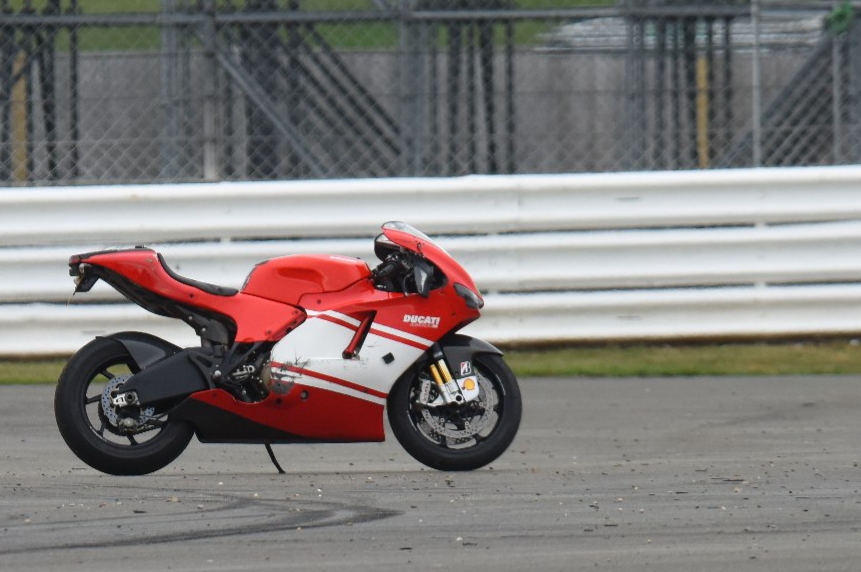

  3. Here's a pic of the desmo.

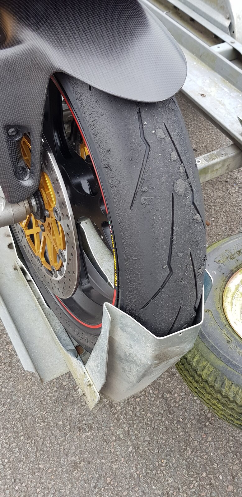

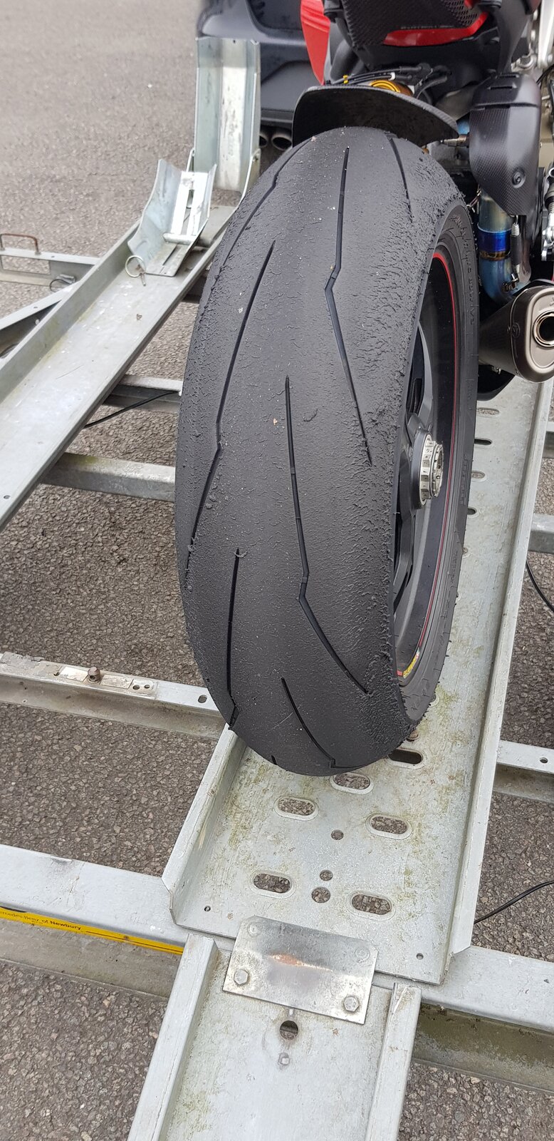

  4. Thanks for the input. You're right they are SPs. What are the pressures I should've been running? I set them to 25 cold and they were about 30 when i came at the end of the sessions.
    I normally use the same pressures at Donington without this issue. If silverstone is more abrasive would it make this issue worse?
  5. Rear? 24 HOT IME. Maybe 26 tops.
  6. No worries. They want to be around 25-26psi hot. Yep a more abrasive circuit can make a difference but dropping the pressure would’ve stopped it. Silverstone is a faster track than Donington, really long straights fast corners which you would’ve been driving really hard out of , all of which heats and wears the tyres. Donington is a different beast for tyre wear as you’re on the edge of the tyres a lot more, shorter straights etc
  7. My gixer 1000 used to do exactly the same. No TC so it just grips or spins. Ruined plenty of rear Pirelli’s, and will use V02s if/when I get another big power bike for track!
  8. Cheers fella
    Yep digital tyre warmers but set at 80 as didn’t know that v02 temps are lower
    Used v02 softs for early donny days and snetts and no issues at all with exactly the same setup
    Used sc1/2 scrubs at Cadwell 2 dayer again no issues at all - smooth as a babies bum
    Silverstone using v02 mediums - nightmare !! Rear is clean but the front was well torn up
    Spoke to Dave Croft from MUPO and basically it’s the new surface - tried a few changes but I think it was to far gone to clean up
    But I will try the lower temp settings
