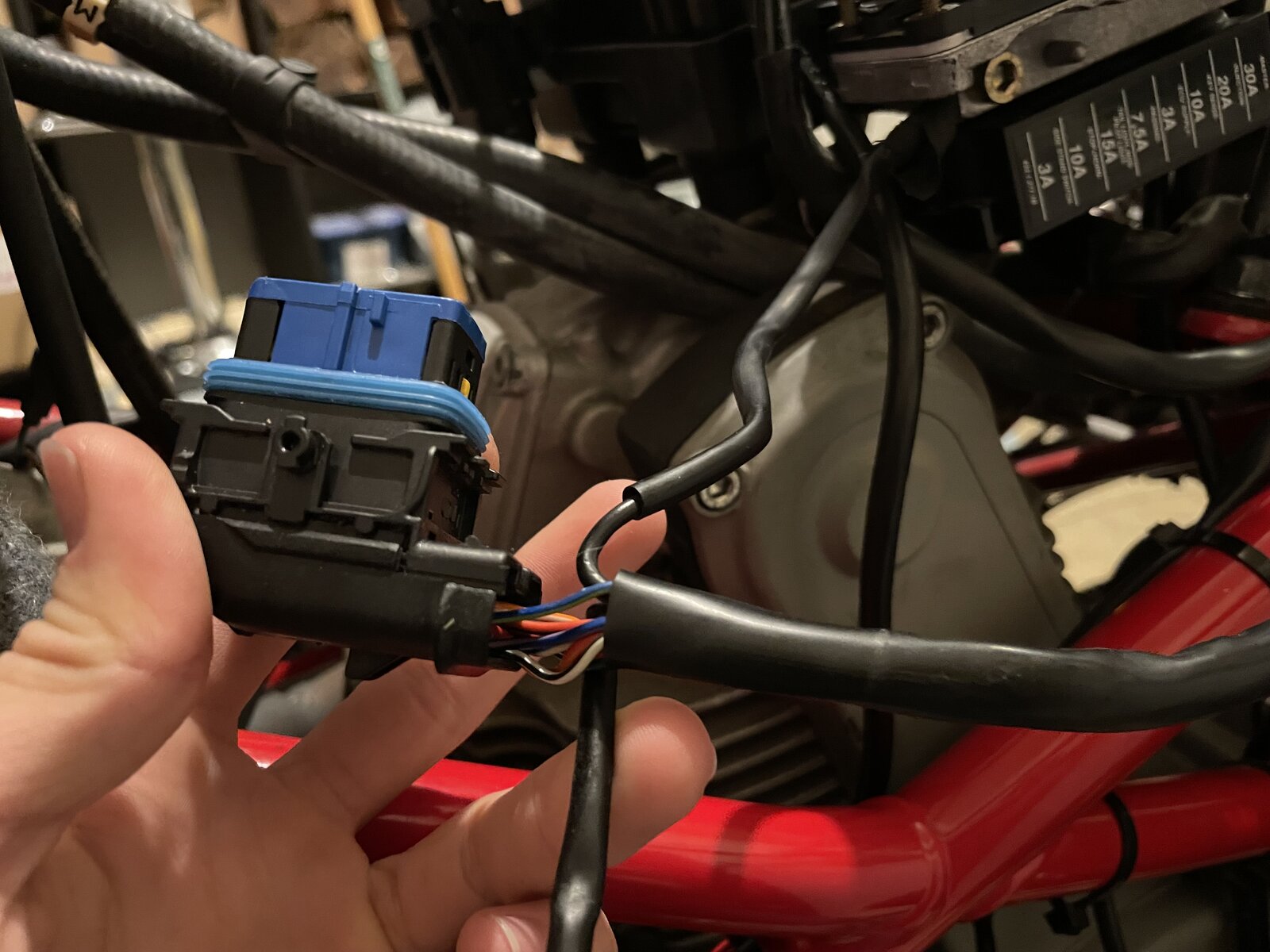

  2. Question. Why does the ECU ground not go into the ecu but seems to run towards the dash? I have a friend who did some testing and says that he couldn’t find the ECU ground having continuity with the plug.
  3. The ECU is grounded through a ring terminal attached to one of it's fixing screws.The ring terminal has a black wire to ground.
  4. The ECU also operates a number of components by earth triggers. For example the injectors are fired by the ECU by triggering earth. As Derek says, the main earth connection to the ECU is via a fly lead that goes under one of the ECU retaining bolts (it must be earthed there).
  5. Could a bad injector be causing all of this? I mapped the new ecu but the same problem exists. When I ground the ground wires for the injectors outside of the ecu to the frame I get 12 volts to the harness. However during testing this time I had the wire harnesses connected to the injectors. Only one sprayed. I swapped that injector to the other harness and it sprayed as it should, the non spraying injector still doesn't. Could a bad injector somehow be causing a fault or stoppage in the ecu? It doesn't seem like that would cause a failure to ground but maybe?
