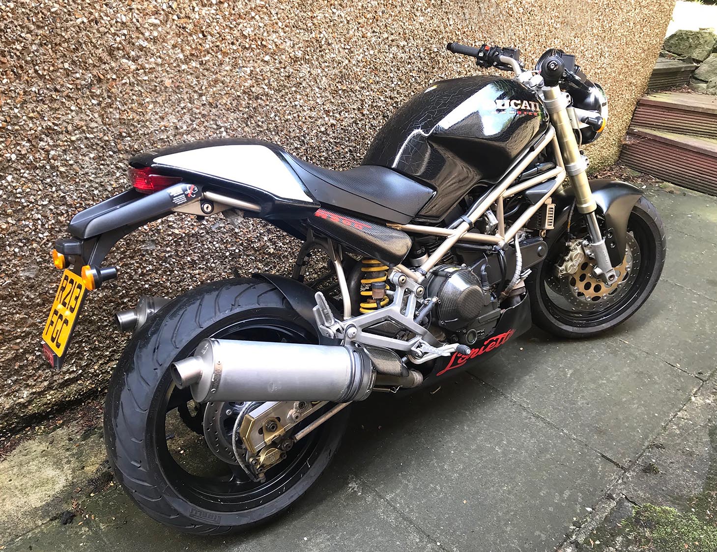

  9. I'm a big fan of the old air cooled monsters... I have a M900 also. Love the black version, as it's just damn cool, but then I am biased! Thread looking great.

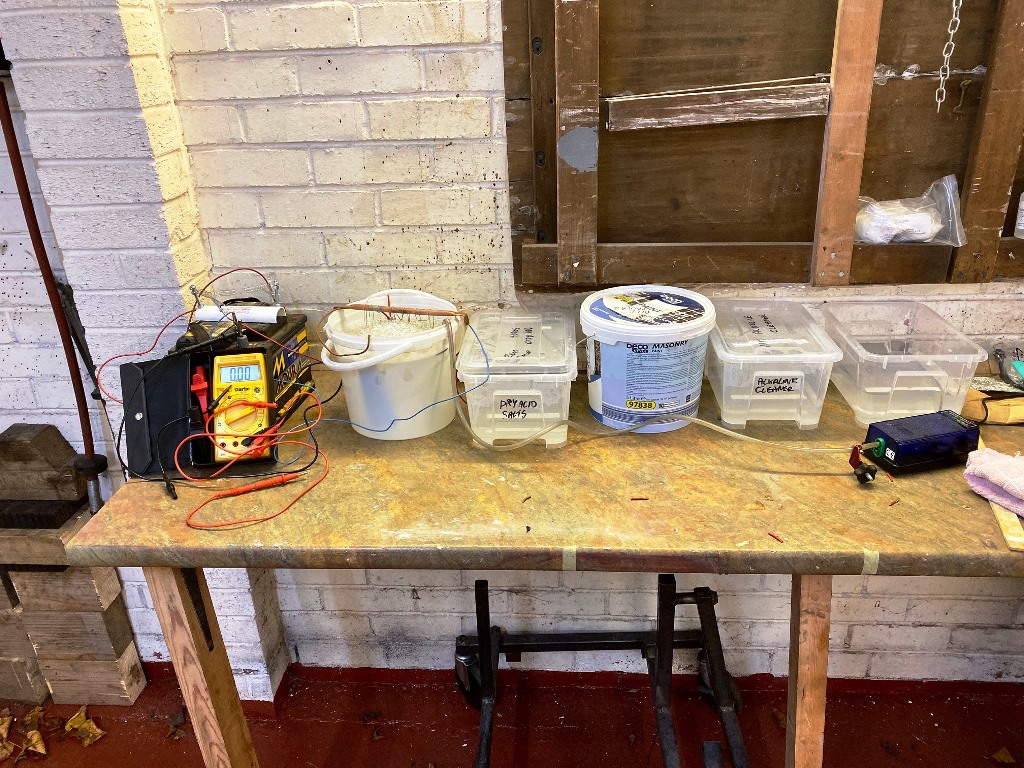

    Been doing the plating on and off, its time consuming, but I put parts in the bucket, set the timer so I don’t forget, and the magic happens… just a few parts to go…

  17. one of the things that has been niggling me is the engine oil pipes and oil cooler lines are badly corroded on the ends… replacements, even aftermarket are a fortune… So I decided to try and plate them… they actually came out rather well!
