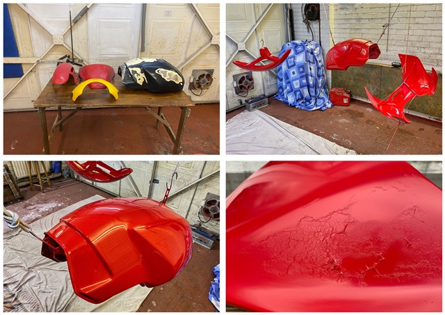

  2. things didn’t go well with the painting… the seat cowl had rattle can paint on it by the look of it... and it reacted badly to the base coat. going to have to do it all again. the other parts came out well though… two coats of clear on the mudguard and fairing, one coat on the tank before I put the decals on and then hit it with one and a half coats…

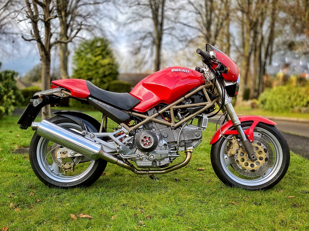

  3. Painting is all finished and I am happy with the results... I love the way 2k just comes out with a gloss from the gun... here is a 25 second video...

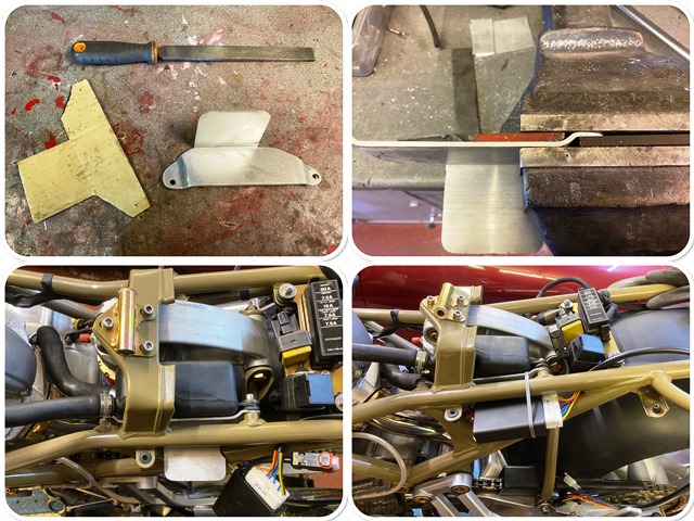

  5. One of the few fabrication jobs I have done on this bike… I have decided to fit an ignitech ignition… Most people seem to fit them next to a smaller battery, or move the coils over, but I wanted to keep the unit away from the heat of the engine… So I made a bracket to fit it under the LH side panel. it just fits nicely…

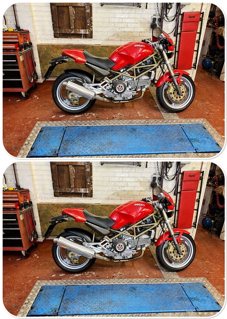

  8. well apart from a few snagging jobs, and replacing the rear brake hose which is too long… its finished. I need to tweak the ignitech unit and enable one of the output channels to limit the revs to 2500 when the stand is down… When I was 19 a good mate rode away from the pub with the stand down… just up the road he came off, and the accident resulted in him losing an arm… those things stay with you…

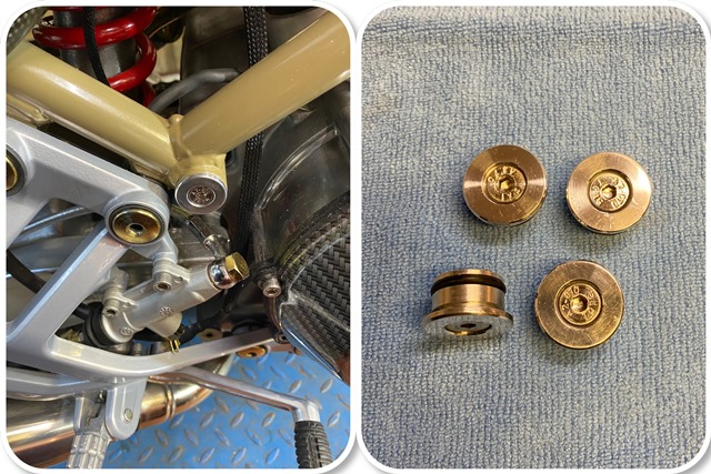

    They say a build is never finished… in some ways true! I am still finding little jobs to do like making some frame bungs as none came with the bike…

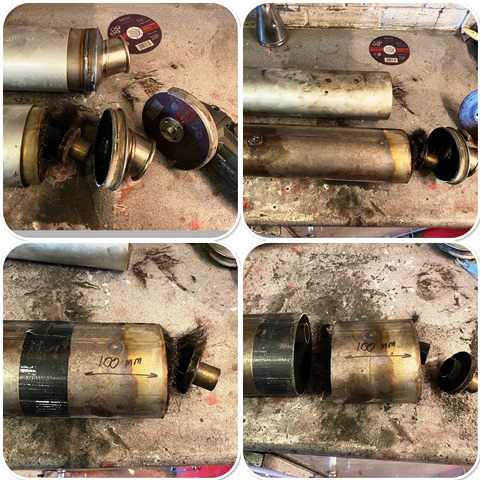

  18. I was looking at the picture of the bike the other day and thought” those silencers are too long”… and its too quiet… Well I had the original silencers which were quite marked, So I looked at shortening them and removing part of the baffle… not a bad job… by removing the bracket I was able to slide the sleeve down enough to remove the end with a cutting disc. I then cut 100mm off the inner and sleeve (both ends to preserve the stampings) , and welded it all back up again. One thing I learned many years ago when welding exhausts is to clean the carbon off the inside… or it leaches through the weld and the joint cracks! They polish up really well…you just have to remove the original finish with a DA sander with some 120 grit, followed by some 400, then polish…

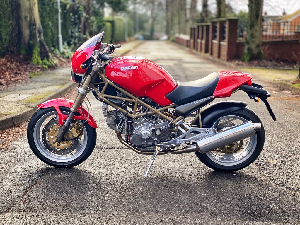

  20. Well here it is finished.. fitted a belly pan as I quite like them... roll on summer!
