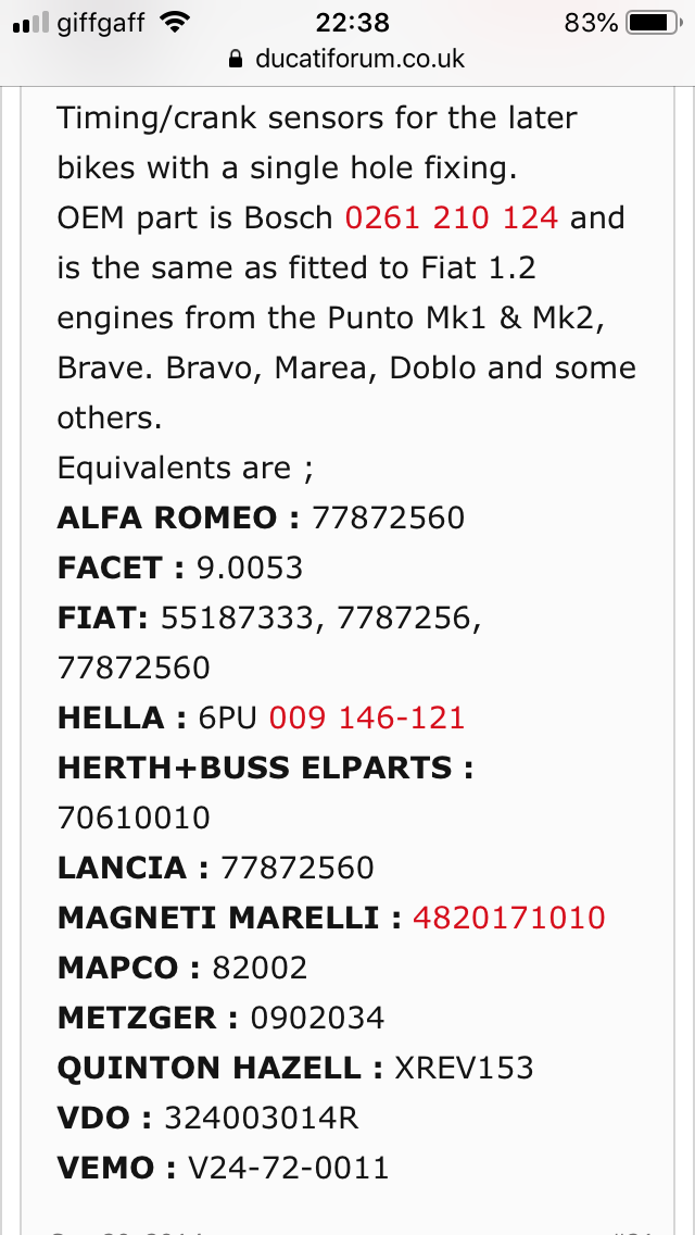

  1. Thanks, I'll give it a go and check the gap as well, if it is the sensor where can I get a replacement? Will eurocarparts be able to match it. Will the monster 6 have the same pickup? There is one on eBay but not specifically for the Multistrada. Would be easier to get it locally. Someone mentioned fiat use the same one. Any ideas?

  7. Hi, I'm going to try the CPS with the multimeter today as the bike is still not starting. If it's an ECU issue I've been reading your the man to come to?

  9. Yeah that's one to think about, I've removed the CPS and it's faulty. I'm not getting a reading so I'm picking one up this afternoon. I'm hoping this will cure it. There's a 8-9ohm reading across the battery terminals so I'm hoping the ECU is ok. The battery has been removed so that's not interfering with the reading. Only time will tell, fingers crossed for this afternoon.
  10. Ok, so success! It was the CPS, not only that as soon as I started it all the error codes disappeared. I also realised it's got new clocks considering the mileage is 304. Really looking forward now to taking it for a spin. Question .. i need to respray the engine once I've cleaned it up, does anyone know the paint code? Also can i use 10w/40 semi or does it have to be fully synthetic? Many thanks for all your help.
