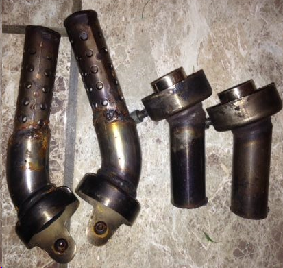

  14. Has anyone modified a set of spare Termi baffles? I.e weld up ends and put slots in, or turn down some smaller inserts. Just to get through the noise the pop the standard ones back in.
  15. Yeh i welded some perforated steel tube on mine from ebay same as below - not sure what the level was, as i shortly sold the bike.
  16. ^ Them's mine...:cool:
  17. Yeps.. ;-)
  18. Nice that should do it..... will look out for a set to mod.
  19. Got down to 101db @5.5krpm IIRC. I just leave them i now, even for euros. They're feckers to remove once in.
