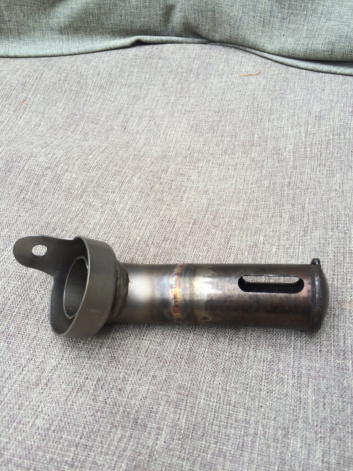

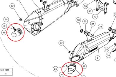

  1. Right, Ive still not tested the baffles as I had to fit a rapidbike evo and a few other things got in the way. By way of information the AKRA baffles are - V-TUV138 & V-TUV138L part numbers. I got mine from www.performanceparts-ltd.com.
    EDIT: Oh, btw theyre £72+ VAT. Each. yeah, I know.
    #241 bootsam, Mar 20, 2019
  2. I believe these are JHP modded Akrapovic dB killers.
    I’ll test them next month and see if I can get a noise reading with them..
    also the Ducati numbers for the dB killers is -
    96480991A - DB RIGHT
    96481001A - DB LEFT

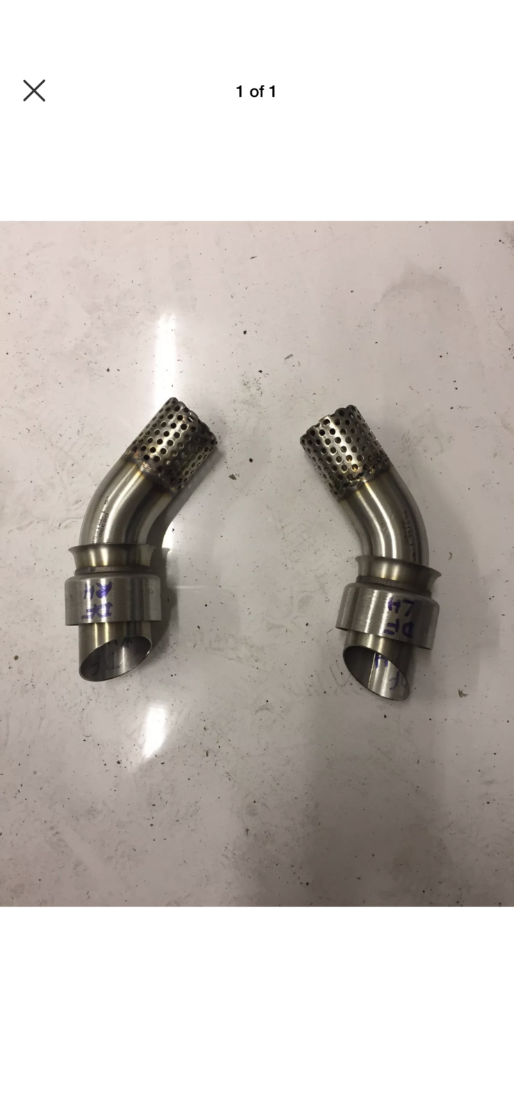

  14. Mine has been fine with inlet baffles at Silverstone, Cadwell, snetts and donny - so happy
  15. What do you mean by inlet baffles?!
  16. Baffles that are placed at the inlet of the silencers
    Checkout this thread all details are here
  17. Think you forgot the link mate.....!
  18. Yep very easy to fit.
    Take of Akra silencers - put baffle in 60mm end crunched end first ;-) and then put silencer back on..
