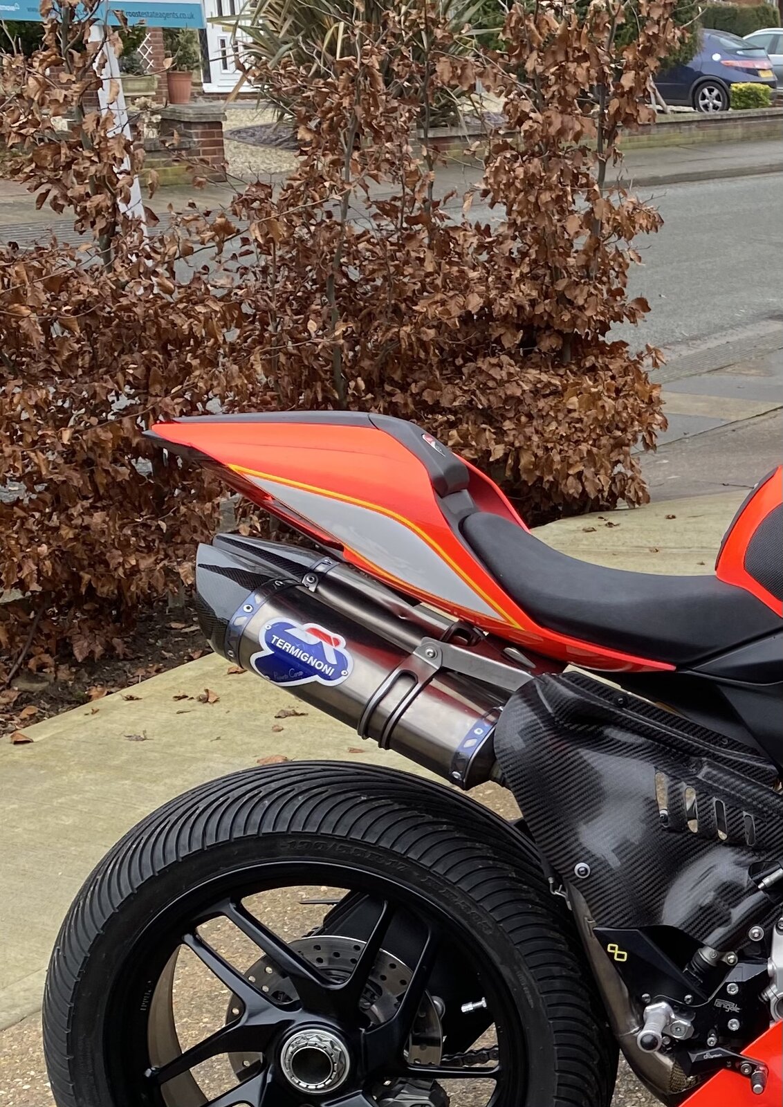

  18. That must have been you I was chatting with briefly at 100% suspension then I guess :thinkingface:, I was on the black V4 with standard system, @DRR117 was there on his 1199 with full underseat Termi system, bafffles in, he had no noise issues though :neutral:
