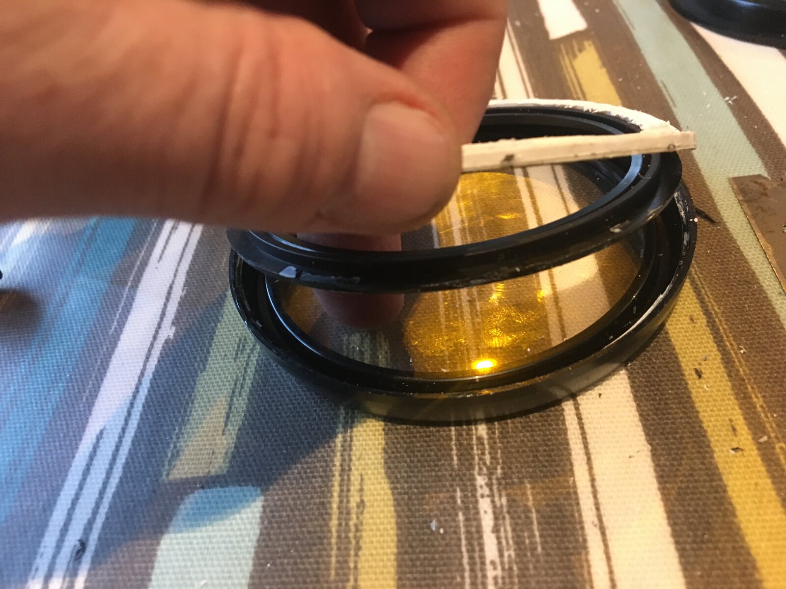

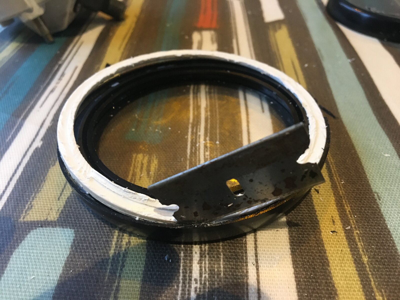

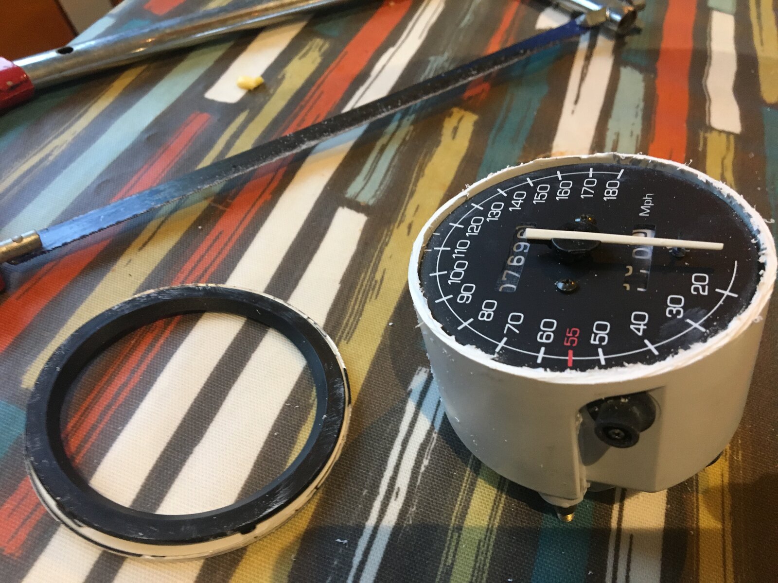

  6. Hi. Excellent work and a good bit of guidance thanks. Mine is a 2001 Neil Hogeson rep 996 with a cracked speedo glass. I'll definitelt be a bit braver now. By the way, is it glass or plastic? Thanks again! Stan
  7. Hi. Well I've got a bit further. THe side lights do just pull out of the headlight assebly so no having to worry about breaking them any more. The speedo glass can be repaired with a bit of skullduggery involving a razor to gradually brwak down through the side of the black rim and the Tripmewter know does actually come off as it is only held there with a small (very small) screw. I fact if you can get the trip know off you don't have to dissassemble the whole F***in clock assembly!! The headlights can be cleaned out with a damp rag and a long reachy thing of any particular kind but must be left i the sun to dry out completely before reassembling. I'll let you know how I get on with the speedo glass. I have mnanaged to find a copany io Germany that will make and send a new glass for 15 euros which isn't bad! Cheers Stan
  8. as said, a lot of luck involved as the original bonding is usually on two faces and you can only access one face with a scalpel. I've removed a few over the years and success rate, leaving white (or other) plastic body fully intact is about 1 in 5. Have since admitted defeat and resorted to (as neatly as possible) decapitating whole of top(glass, bezel and top portion of instrument body) which I think Richard has described with pictures. Cutting off in a lathe would be best result (but you still have to crudely re-attach at present..).
    as for why it happens, controversial and various, A spill of brake fluid will do it in time, but a certain method is to expose to extremes of temperature in a short period e.g, a cold or frost night/ a hot day, instrument bathed in sunlight.
