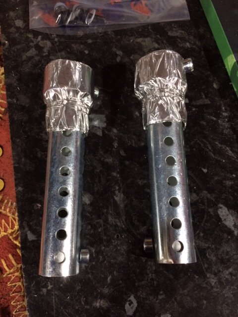

  8. just tested my v4 with full akra system, pipewerx inlet baffles and new akra exit baffle and a shorter one made up for left silencer- in lower power mode, slowly increasing revs to 5500rpm , db meter at .5m 45 degrees = 105db
    gets me past cadwell static , i'll then remove the exit baffles , as it passes oulton 89db /snetts 92 ride by with just the pipewerx inlet baffles - weel chuffed

  10. inlets were from here - just ask for 60mm ones for a panni v4
    - https://www.pipewerx.co.uk/webshop/...-hawk-silencers-with-our-standard-52mm-inlet/
    outlets were a combination of the new Akra baffles 96481631A [​IMG]
    and i made up the exit short angled baffle for the left exhaust one from these cheap chinese ebay baffles , i had to cut one, and weld it at an angle to fit.

  13. Not convinced the Mk2 db killers made a big difference. Certainly not road or UK track compliant, unless it's a Donington noisy day. Andy

    I don't want to tempt fate, but the Akra kit as pictured above has got me through noise tests at Snetterton (twice, evening... noise tester said "just") and have been fine at Silverstone on 2 days, including yesterday
