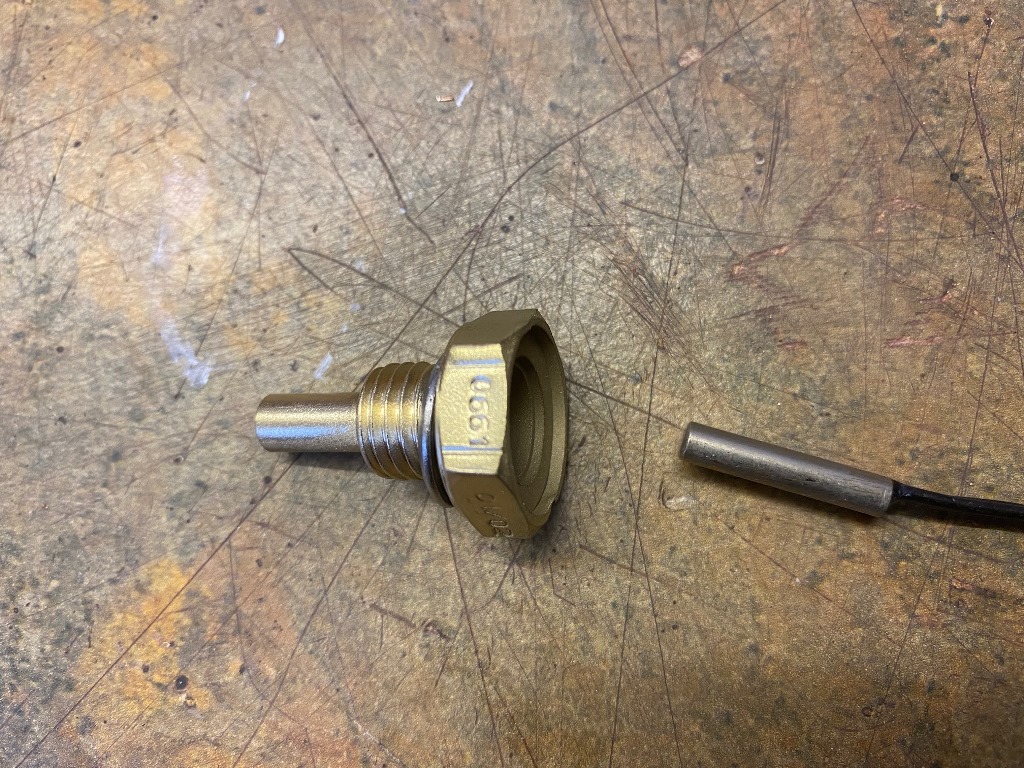

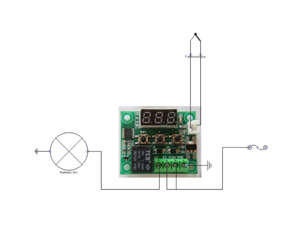

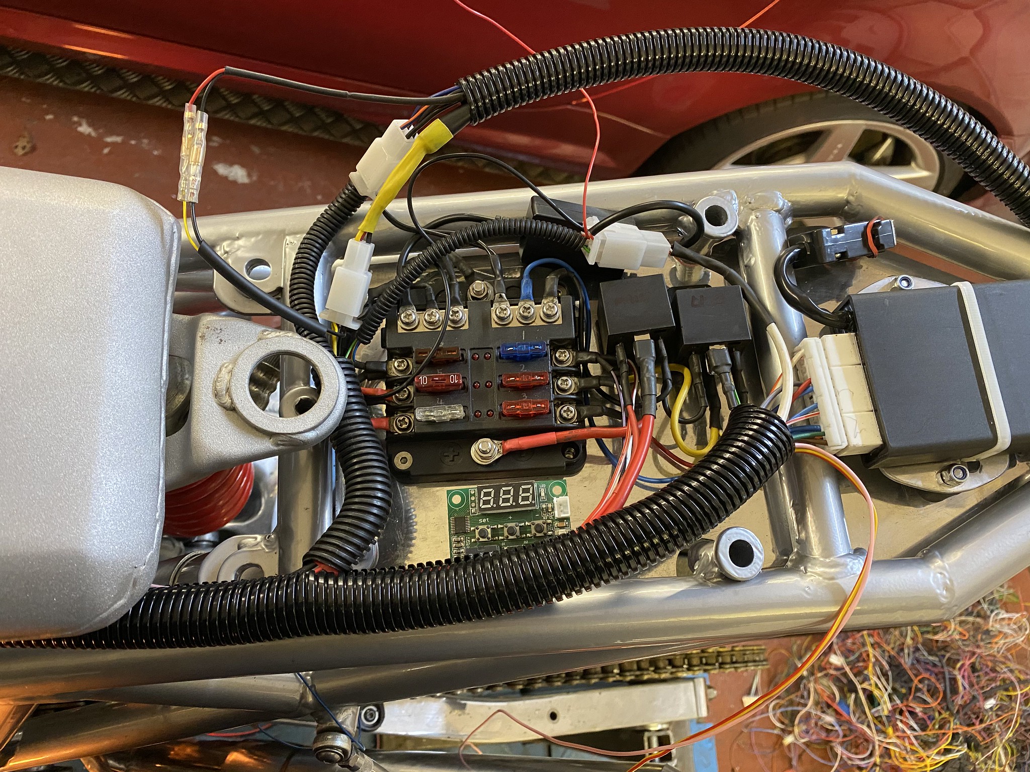

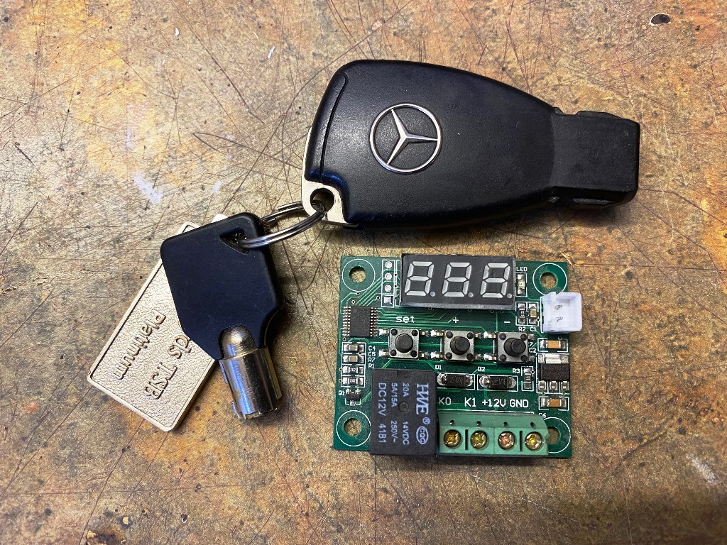

  2. I have been pondering how to switch the radiator fan on and off as I am no longer running with an ECU... I popped around to my mate yesterday and he suggested using one of these units which is adjustable for temperature. he uses them on factory machinery. I have put the thermocouple in the original sensor (snug fit, but used some heat sink Grease used on computer CPU's) and some Araldite to hold it in place. Its 12V, you can adjust the temperature and it has a 20 amp relay on the board which is more than enough for the fan... tested it today in some boiling water and it works well! The unit is very cheap at around £5!
    Also made a good start on the wiring.. I know a lot of people struggle with this but I find it easy, enjoyable and quite therapeutic! Sad I know! I start by making a drawing of each circuit on a page, and wire that circuit on the bike. As I go along I write the wire colours on the diagram for future reference. Use pipe cleaners to hold the wire bundles together till all the circuits are in place. then run them through sheathing , and then crimp/solder the ends on!

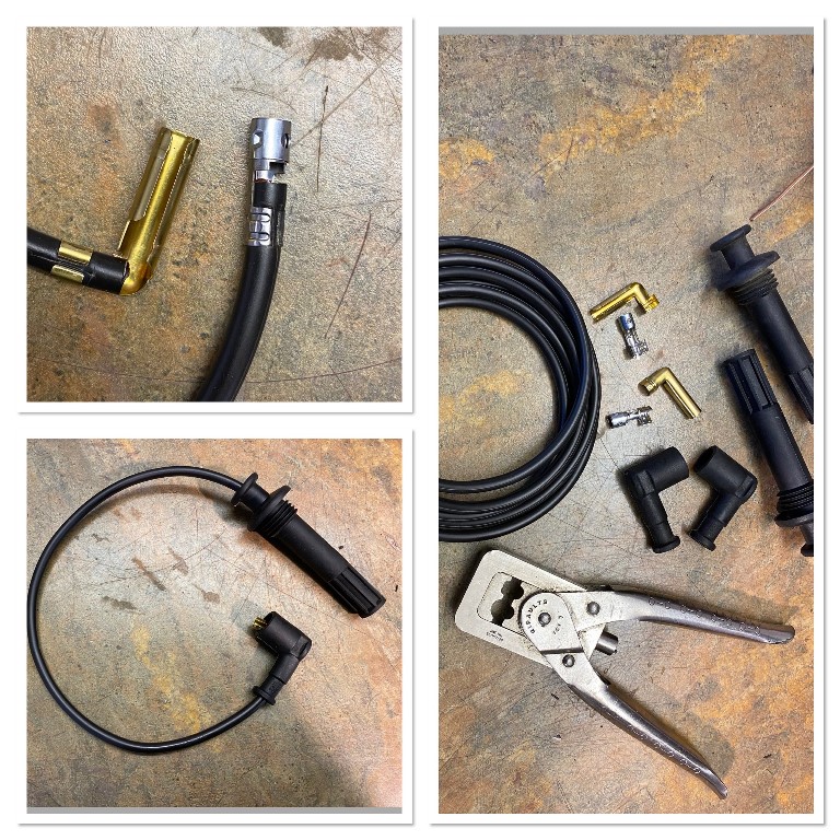

  4. The wiring is coming on well, just a couple of minor circuits to do. I like this fuse box. one lead in, and all the fuses come off that, and it has a single earth point as well. All the ends are crimped and soldered… and covered with the glue lined heat shrink. When its finally done I can tidy it up and tape the joints with self amalgamating tape. As I had changed the location of the coils I needed custom leads, cheap and easy job. That crimp tool has not seen much use since the 70’s though, when it was used all the time! I had better get some resistor plugs as there is not much in the leads!

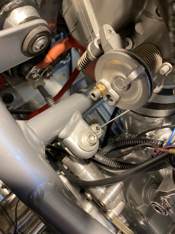

    Also finished the throttle cable. I wanted to make the bracket slightly adjustable, so I made the mounting eccentric. couldn’t be bothered to change the chuck!

  7. Not much progress of late... I came down with the flu, and its knocked me sideways... getting there now though.... here is a 15 second clip of the throttle linkage

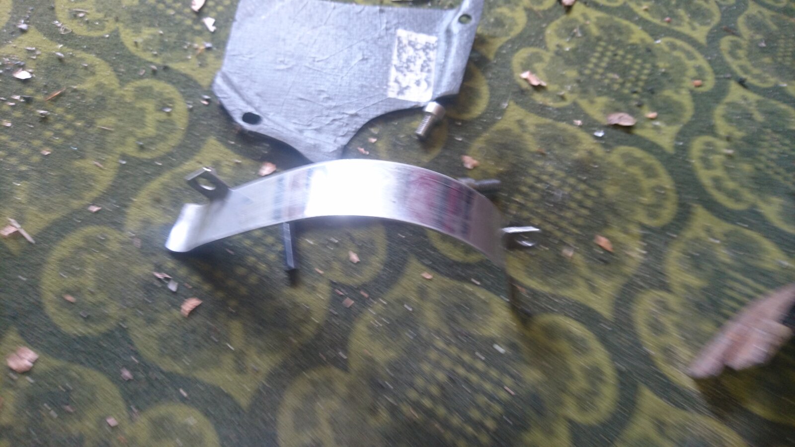

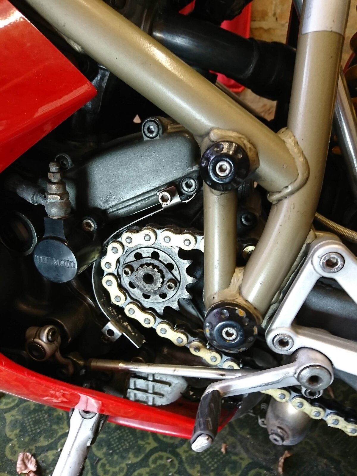

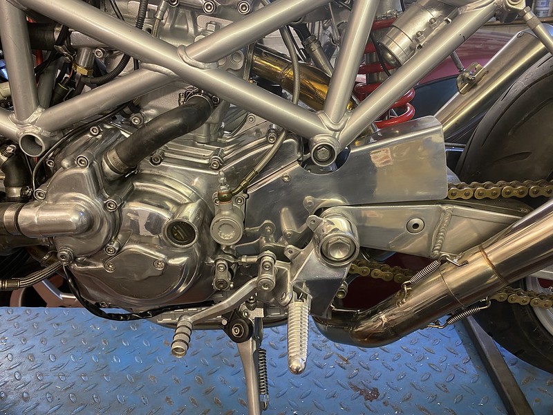

  12. Spent a couple of hours making a chain guard today… should keep the MOT man happy. He follows my builds, and sometimes messages me to say he will fail it!
  13. When the suspension compresses won't that guard foul the swingarm?
  14. its the angle I took the photo Dave... there is a good 10mm gap at the back so the swinging arm can go inside the guard...
  15. What do you reckon about that crankcase chain guard that the FB bloke mentioned/showed the other day? A while ago my mate had a 916 that had case damage from a broken chain and that solution was an obvious one at the time. Cheers (& nice build;))
  16. I think its a brilliant idea, I was unaware there is a problem, but after checking its common!! I will be making one before I ride it, just in case! I will also make one for my Multistrada...
