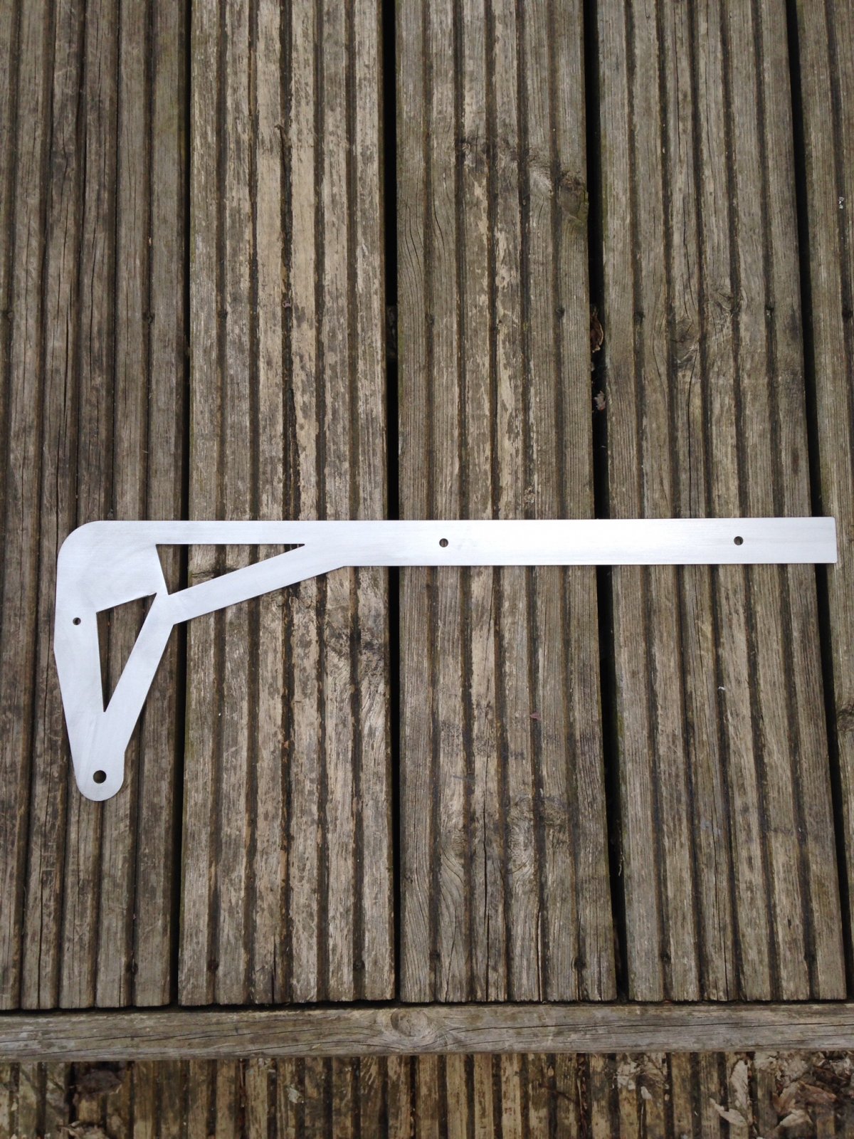

    Got one made up in the end. Had it laser cut to the drawing on this thread. Just waiting to get the frame bobbins and the axle cone made up. Might take it into the dealers and ask if they'll compare it to theirs to see if there's any difference.
