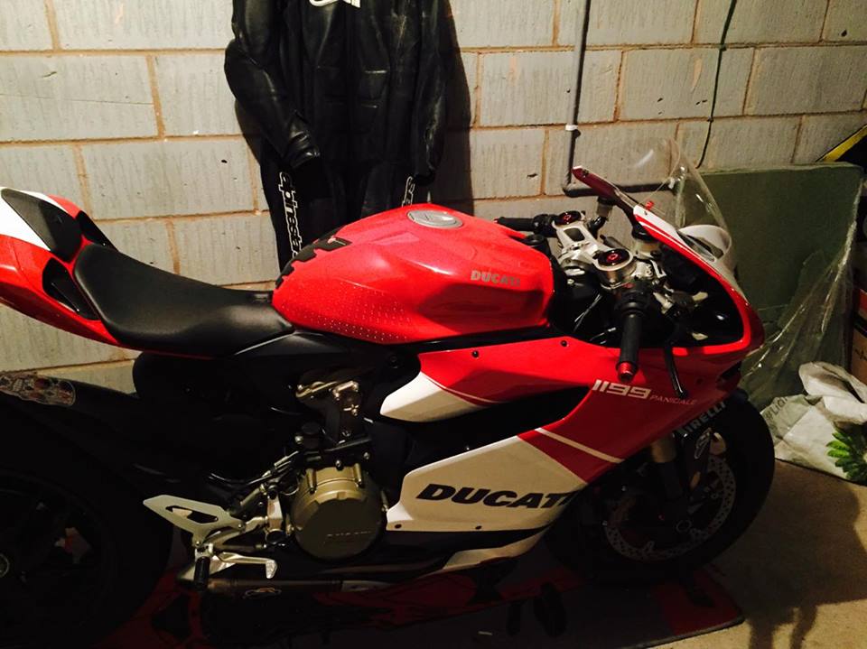

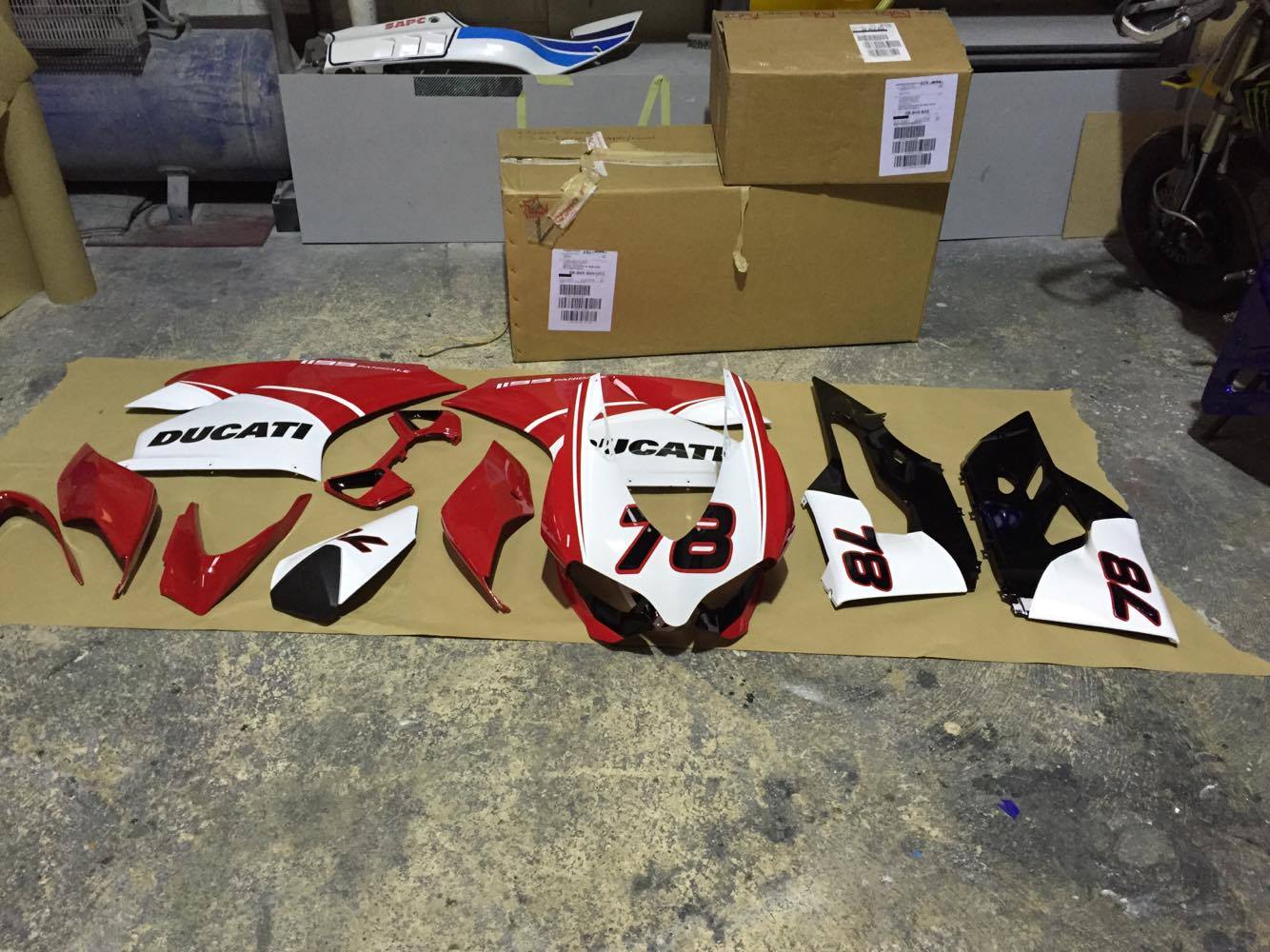

    Picked my painted fairing kit up yesterday gonna have a bash the weekend at fitting them. You mentioned about the additional screws you needed for the front LED Blanking unit, do you know what size you used?
  9. Nice, I like the graphics :) They were a couple of really small self tappers, so not sure what size I'm afraid. I had to remove them from the light unit to put into the blanking unit to connect the two parts together. I should make a note when I get the bike back from Almeria and stick it up on this thread.

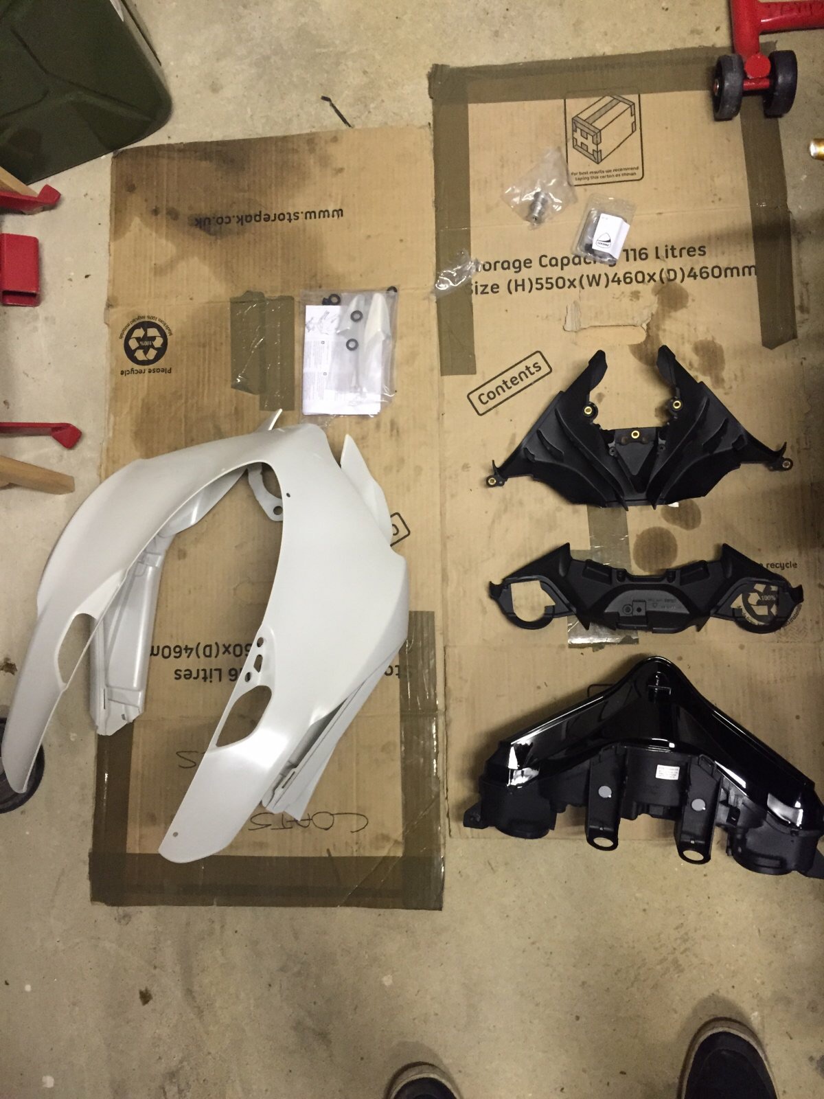

  12. im not getting on too good come to fit the front blanking headlight unit and those three electrical connectors dont fit anywhere. I know one is for the side stand but the others aren't compatible with any of the connectors coming off of the bike. Can anyone point me in the right direction as ducati cov have shut up for the day and no other dealer can relly give me an answer? Also is there a difference between connectors for LED on the S model and then on the base model?

  14. Finally got them done! Right the 3 electrical connectors that come with the kit aren't needed! The one that comes with the tail unit is needed but the other 3, nope!. One for the side stand, the other for the radiator fan and the last one is an ignition bypass (i think) Basically when swapping all the bits over from the old light unit make sure you swap over the air temp sensor, without that plugged in it was bringing the warning light on the dash. So connect that up as well as the connector into the headlight unit and your laughing.
    I didn't find i needed any extra self tappers, screen or fairing brackets, everything swapped over hunky dory.
    Now i've done it i dont want to do it again, but will be quicker at doing it if i had to.

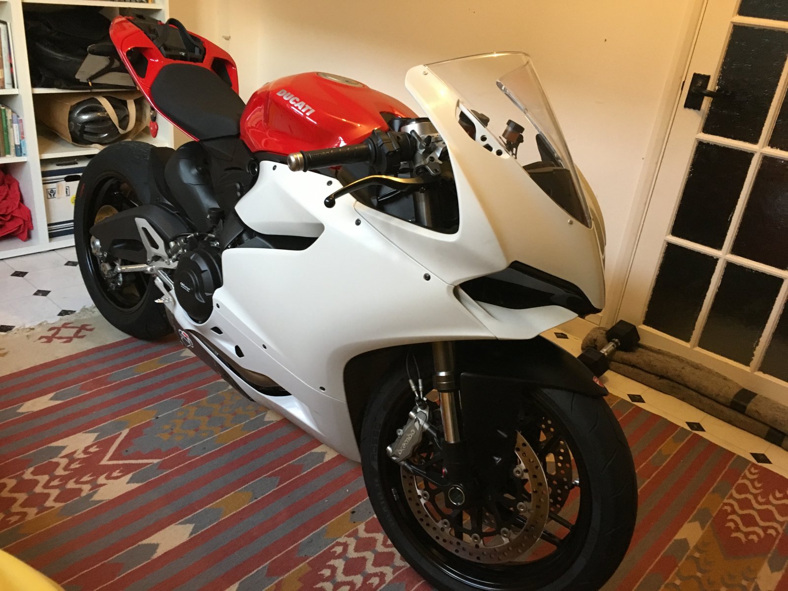

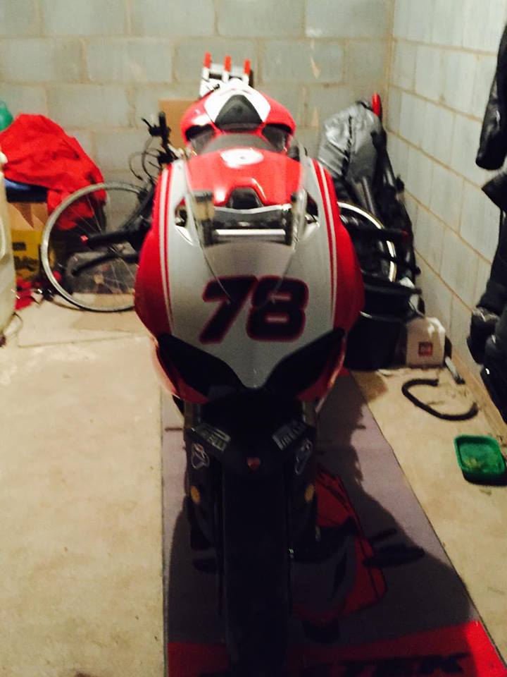

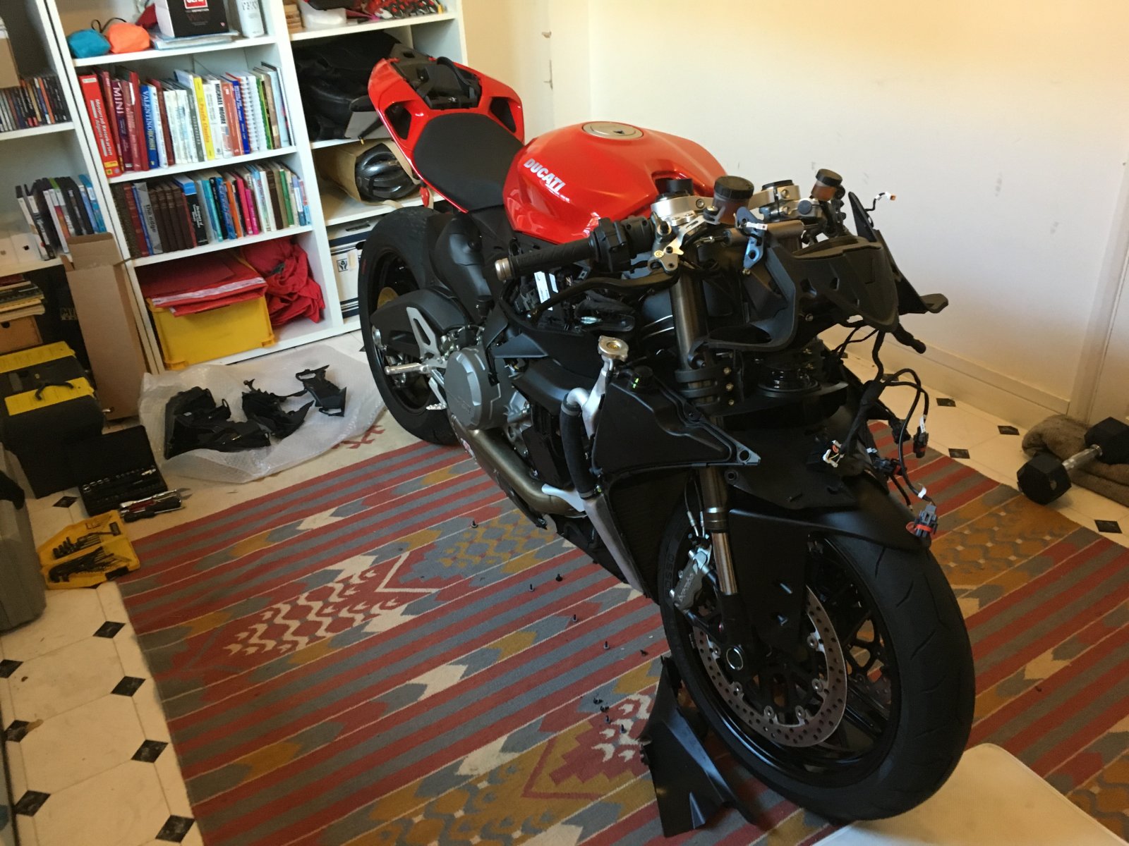

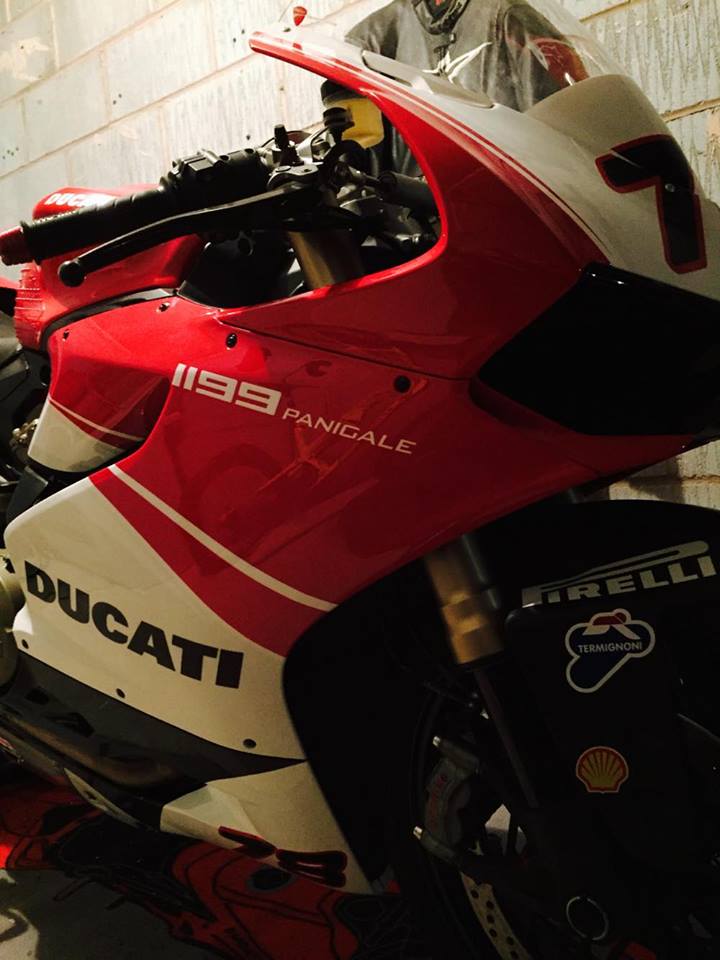

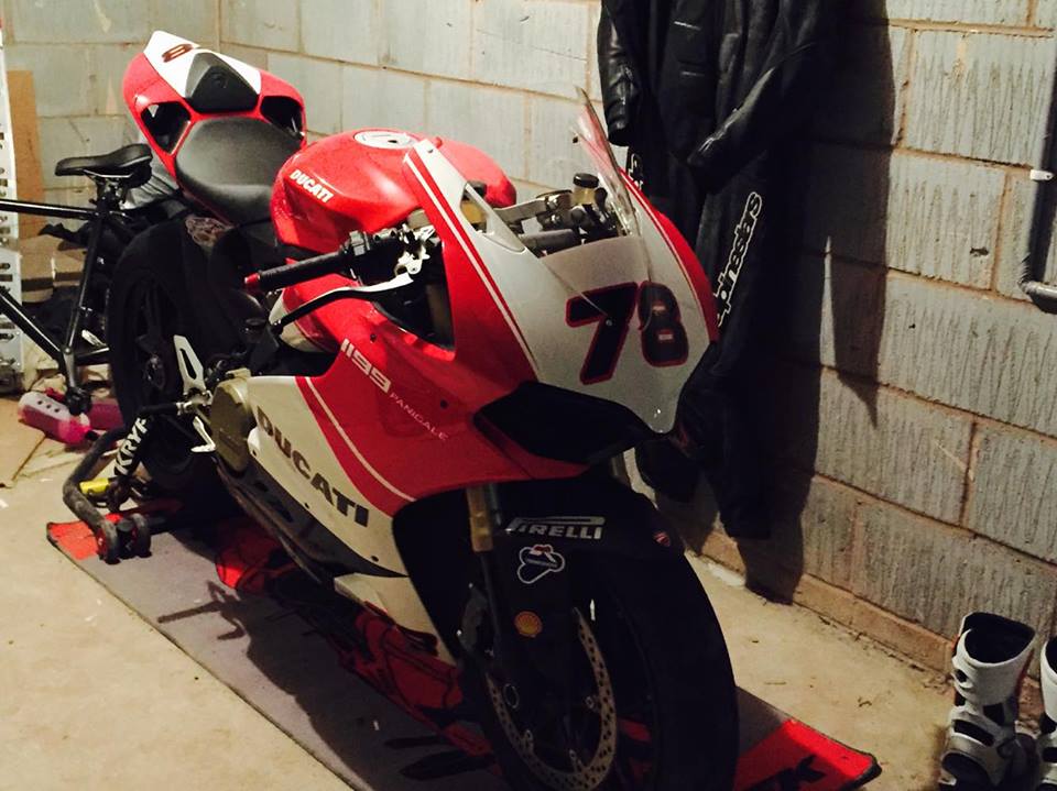

  15. Happy days, that's great you've worked that out. I don't get the bike back from Almeria for a few days but I 'll try the air temp sensor. Your graphics are looking really good :)

  17. Right so the temp sensor you need to get off the black plastic cowling that is apart of the headlight unit. If you look at royals pic of the racing kit head light unit, look at the second piece down on the right hand side. If you zoom in you will see where the clip goes as well as the long bit of the sensor goes through. So you need to unscrew the sensor and take the clip off and put it on the new unit. image.jpg

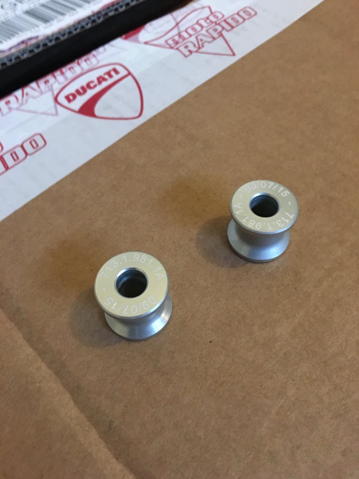

  19. Oh one question. What are these for. I hope I haven't got to take it all off again..
  20. Good lad! I know what you mean, feel like I've got ET fingers!
    They are the side stand spacers in case you are taking the side stand off. Just takes up the gap, If you are taking the side stand off you will also need to use of of those connectors otherwise you'll get the side stand message and bike won't start (I think)
